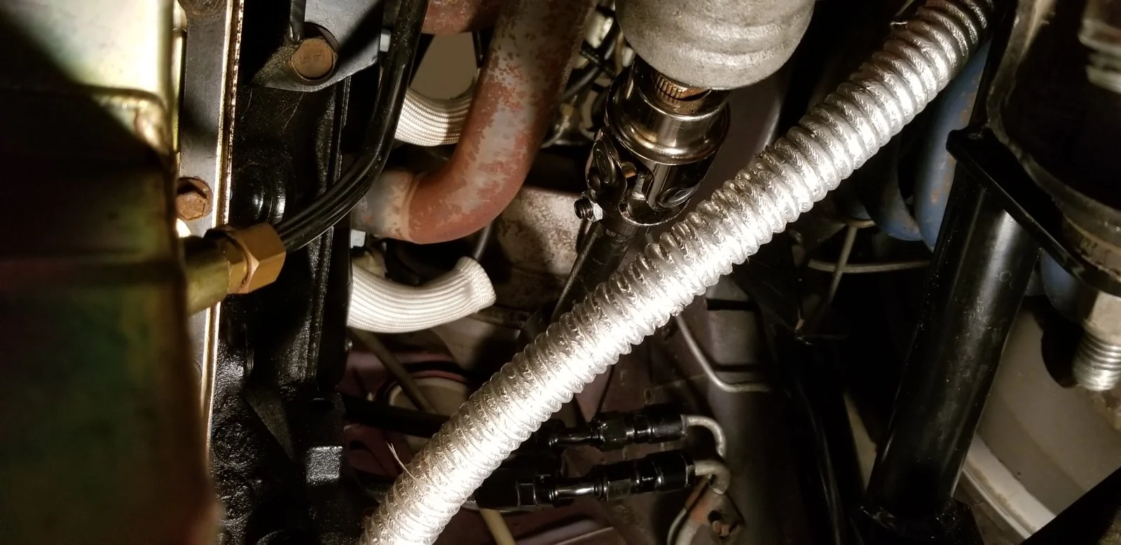

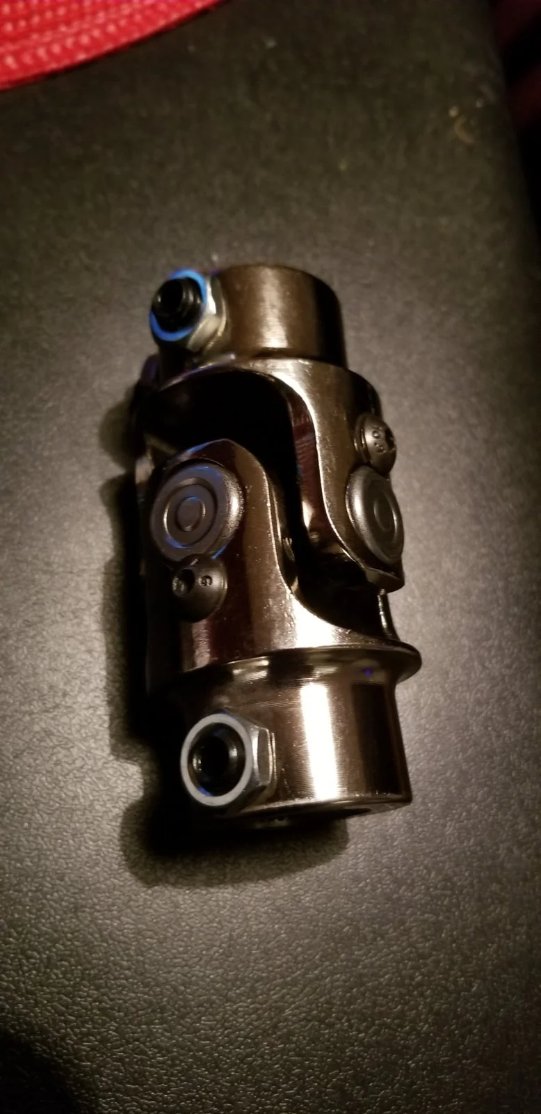

When I hit the curb earlier this year I think I damaged my steering coupler. I've already gotten rid of the rag joint and had the shaft machined to accept a 3/4 DD to 3/4 36 spline universal joint. The replacement came today.
My eleven year olds birthday is sunday so I hope I can get this in tomorrow.
Finally got the steering u joint replaced. The shaft on my car is really tight and has to be beat in and out of the column. A real PITA.... but it's done...

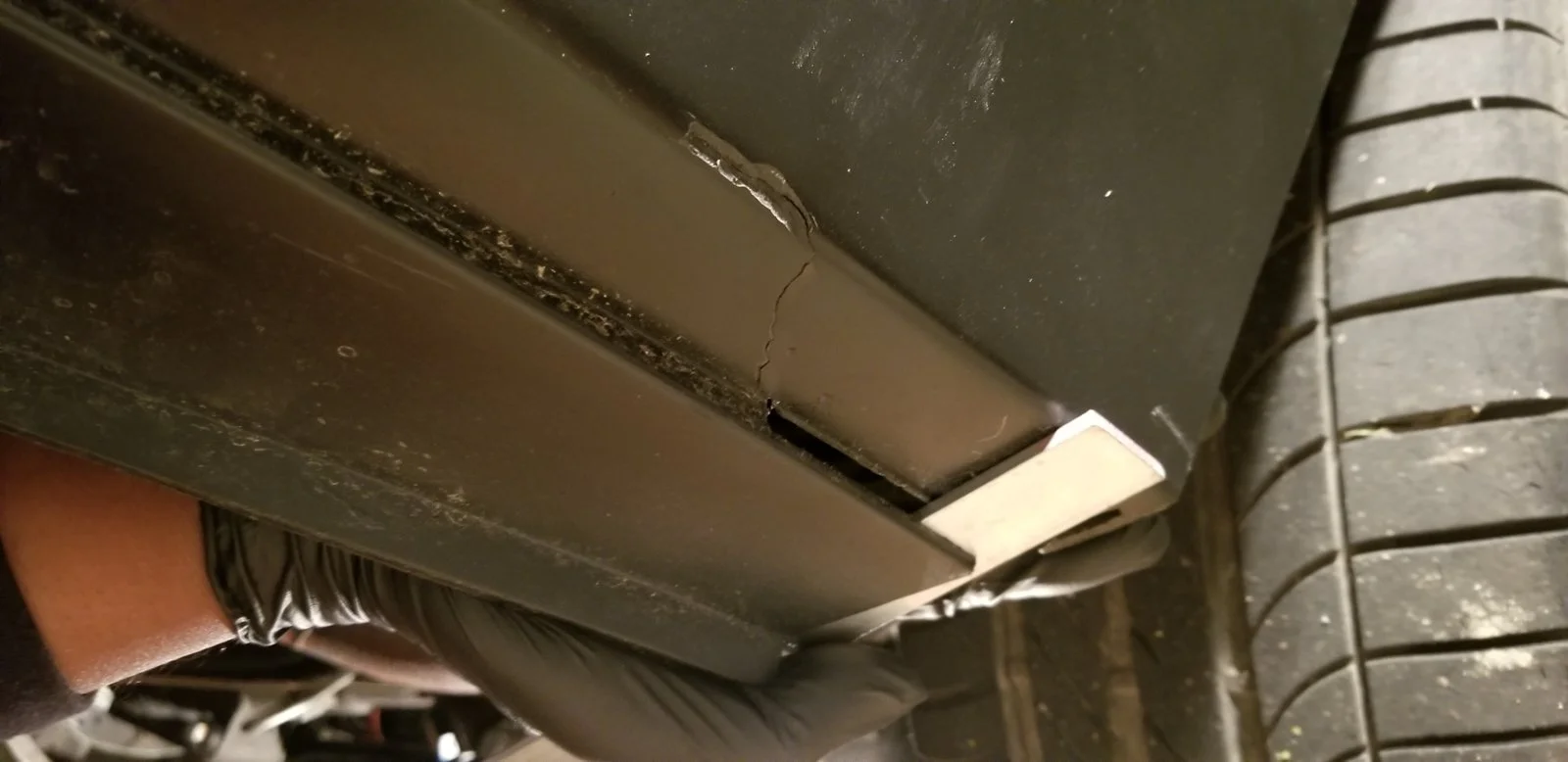

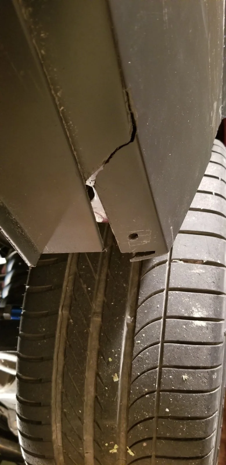

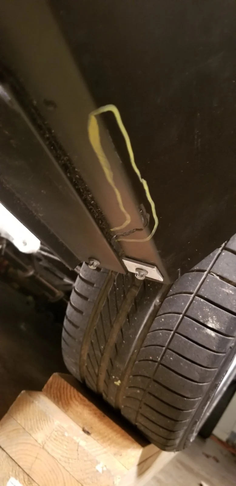

While layng under there I noticed this getting worse...
This is the spot where the bumper was cracked all the way to the fog light bezel. The 3m8115 isn't strong enough to hold it. I'm going to use a piece of aluminum and make a brace for it and then repair the new crack. I should've done it with the initial repair but intended to have a lower cover fabricated by now.
Here's what I'll do... there is a hole already in one side that will get a bolt and washer. The other side will get a hole drilled. This left over piece of aluminum wil make the brace.
The other side is going to get the same treatment.
I'll post pictures when I get it done.
PBA not strong enough?! Hummmmmmm.........
I'm sure the bracing you're making will be strong enough though.
I've never had PBA fail me Scott, that sucks.
There's a bunch of stress on the bottom edge of the bumper because it's being bent to conform to the lx bumper. I think that's why it's trying to crack. I sanded the inside with 80 grit, cleaned with grease / wax remover, used adhesion promoter, layered PBA, layed the mesh, spread more PBA, and cured for 24 hours at about 85 degrees.
When I went to install the lower on the lx bumper I did hear a pop. I think there may have been an issue with the adhession promoter. I used a duplicolor aerosol can. I think I may have rushed the set up time for it. ( not really sure ).

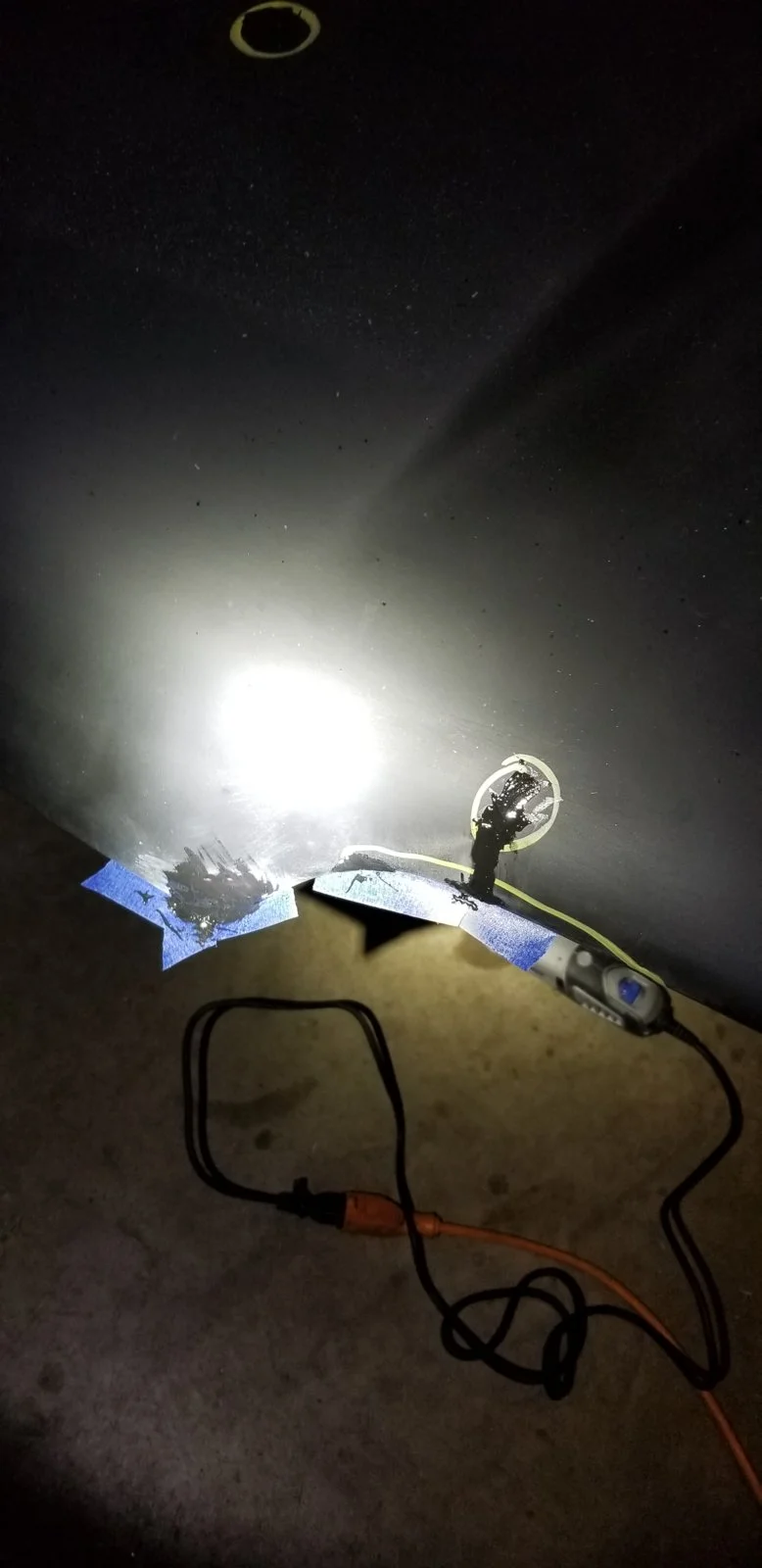

Laid down some more 3m8115...
... and the bumper repair 2.0...
It's pretty chilly here so it'll be a few days before I can start sanding. The halogen lights are aimed at the bumper. Ther garage is broadly about 65 - 70 degrees. We'll see how this all turns out later this week.

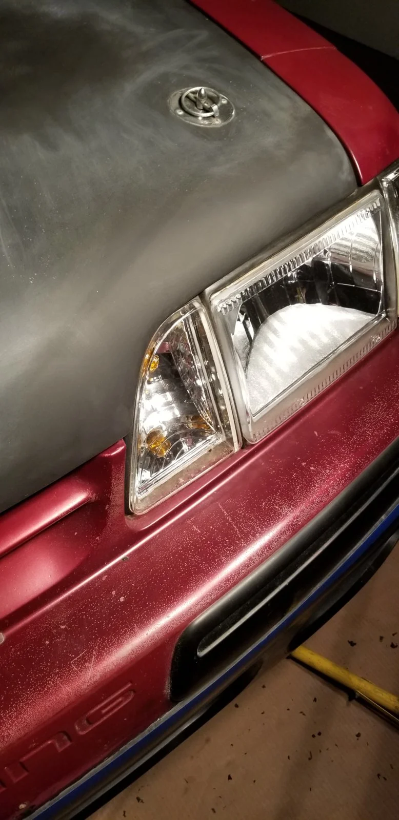

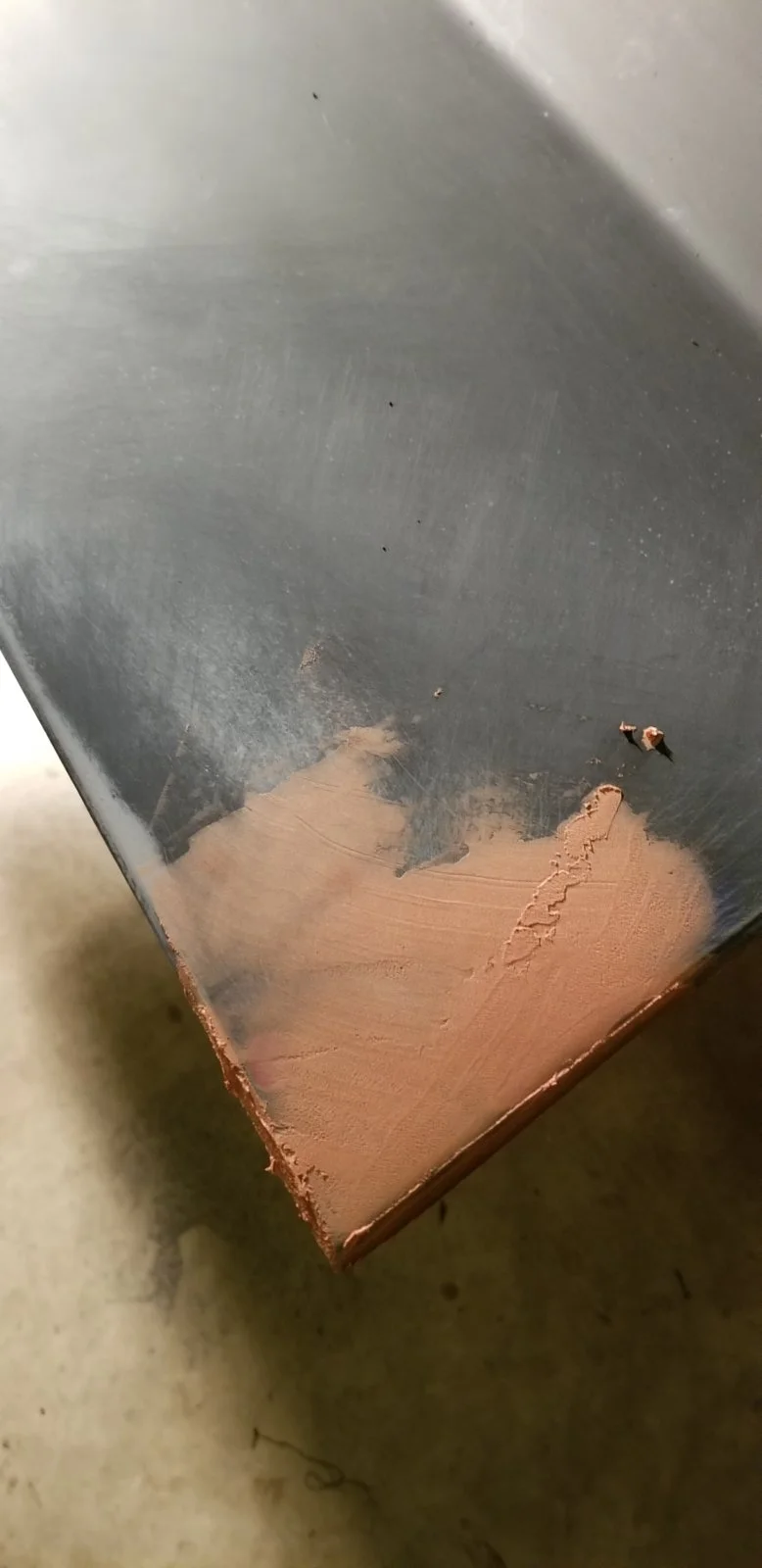

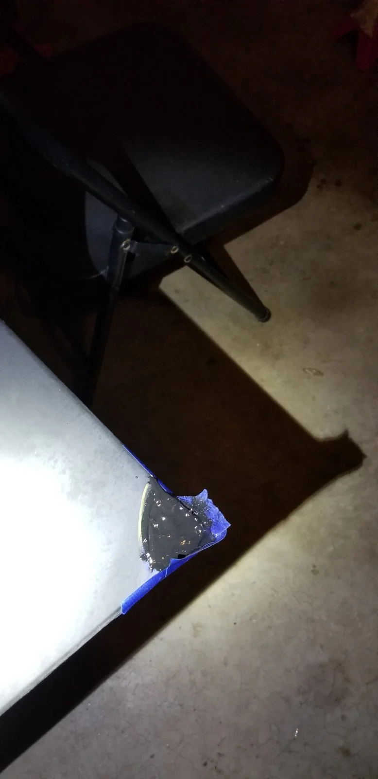

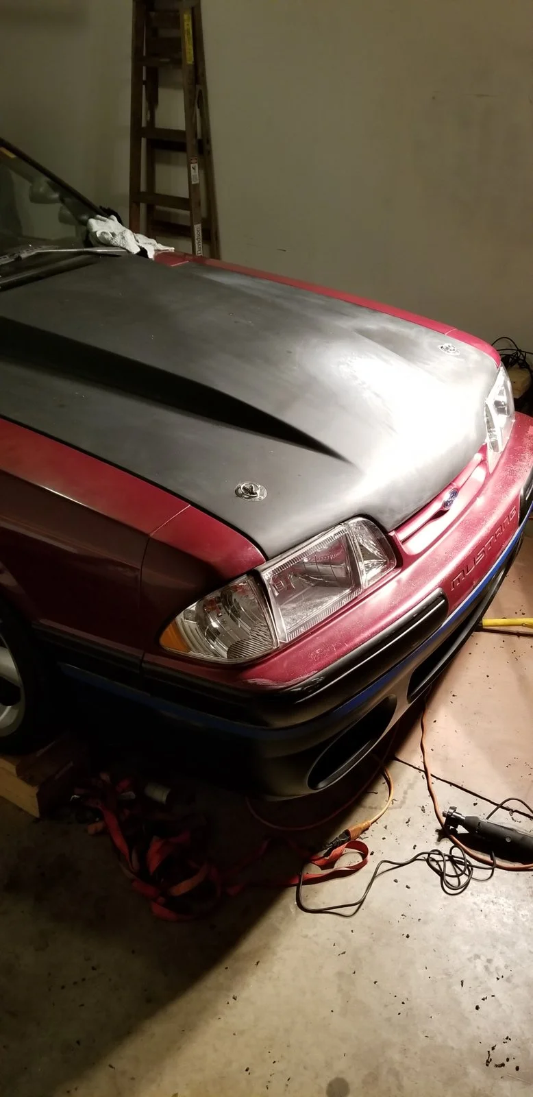

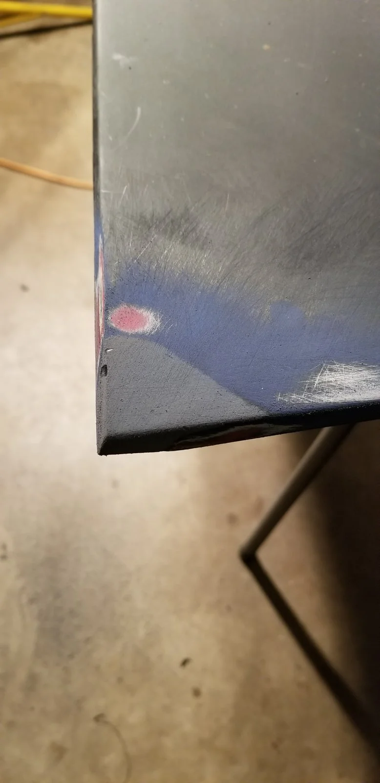

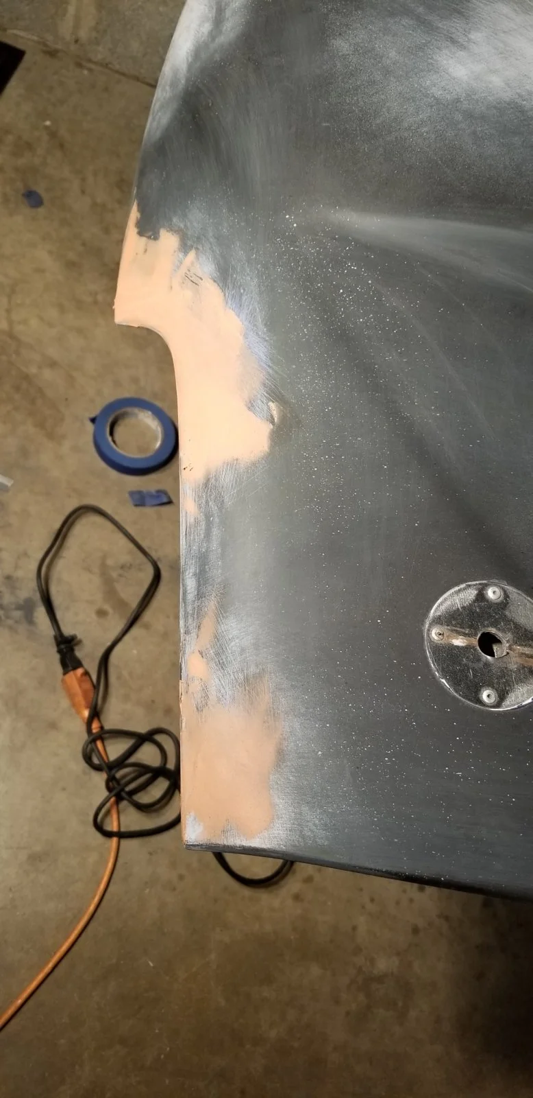

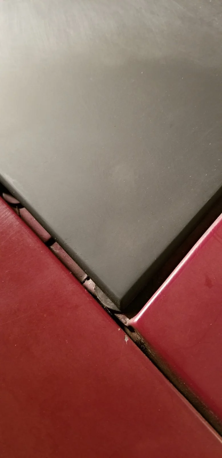

This 8115 is the bees knees. The drivers side rear corner of my hood was missing about 1/2 inch and the front edge by the turn signal was missing a bit too. Not anymore...
I've done a bunch of fiberglass work to this hood over the last 15 years. PBA has been the best and easiest to deal with so far.

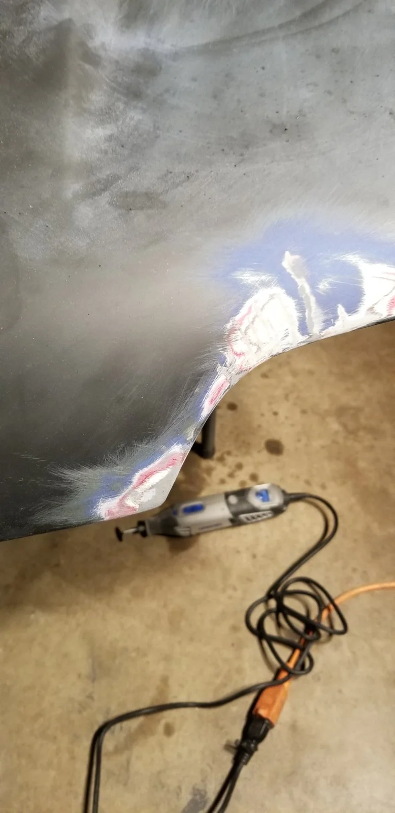

@ droopie85gt ... I used a dremel to chase the spider cracks. Also, found out that the smaller 3m sandpaper wraps around a toilet paper roll perfectly. It's like having a small sanding block and keeps you from loading up the paper or applying too much pressure. Just don't use it on your rear :nonono:
@ davedacarpainter ... I haven't sanded the bumper yet but this hood turned out great. Just a couple spots to spot fill and it'll almost be ready to be reinstalled. Just some primer and a rattle can away after that. I'm just trying to get this hood to get me through next year. It's got about 10 layers of paint on it. Let's see...high build cream primer, triple stage candy red ( with 4 coats of clear ), primer green, gray primer, svo blue pearl, primer green, and flat black....guess it's more actual layers than 10. Lol
I must admit....I love the smell of bondo....

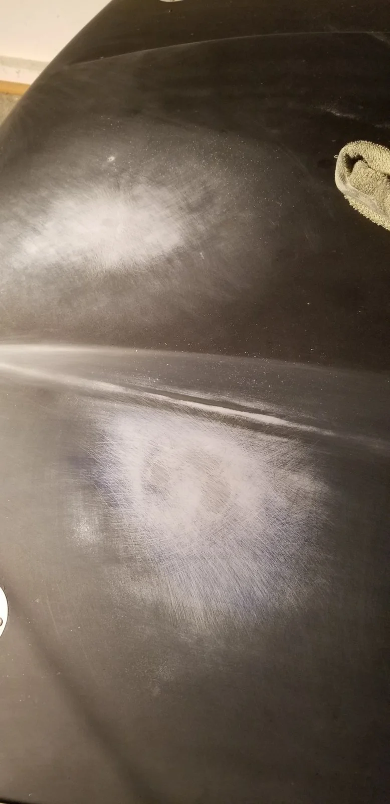

Some spots came out well with just a coat of primer.
Those white lines are primer filled scratches from the 80 grit. Tomorrow I should be able to block the filled areas and get another coat of primer on them. Then paint this weekend the same mat black. Wish i could spray it body color but theres no way it'll match. I'd rather it be black then for it to look unmatched to the car.

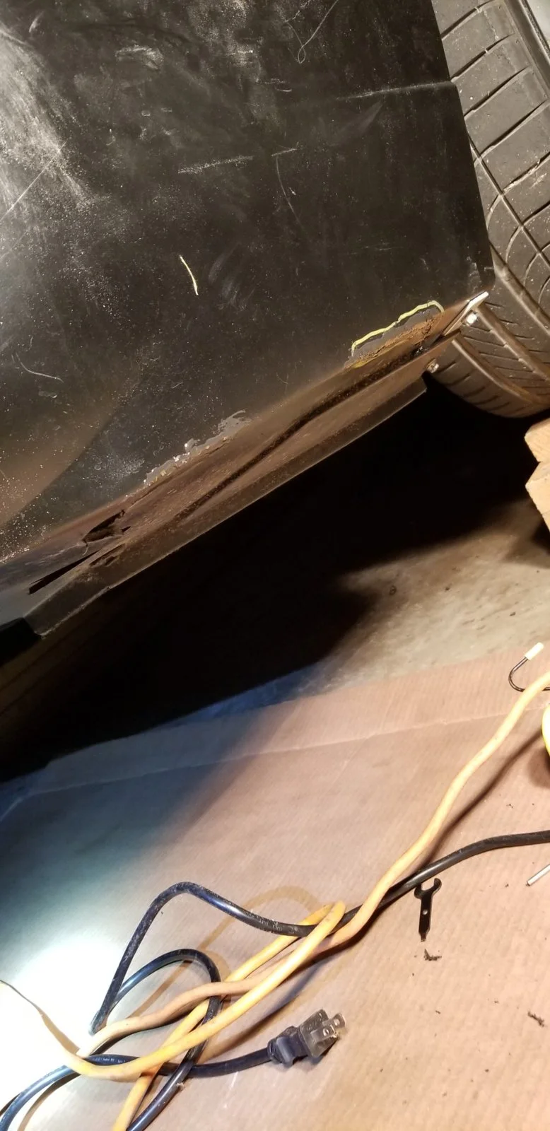

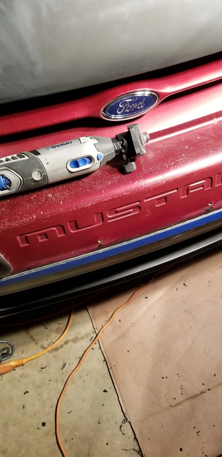

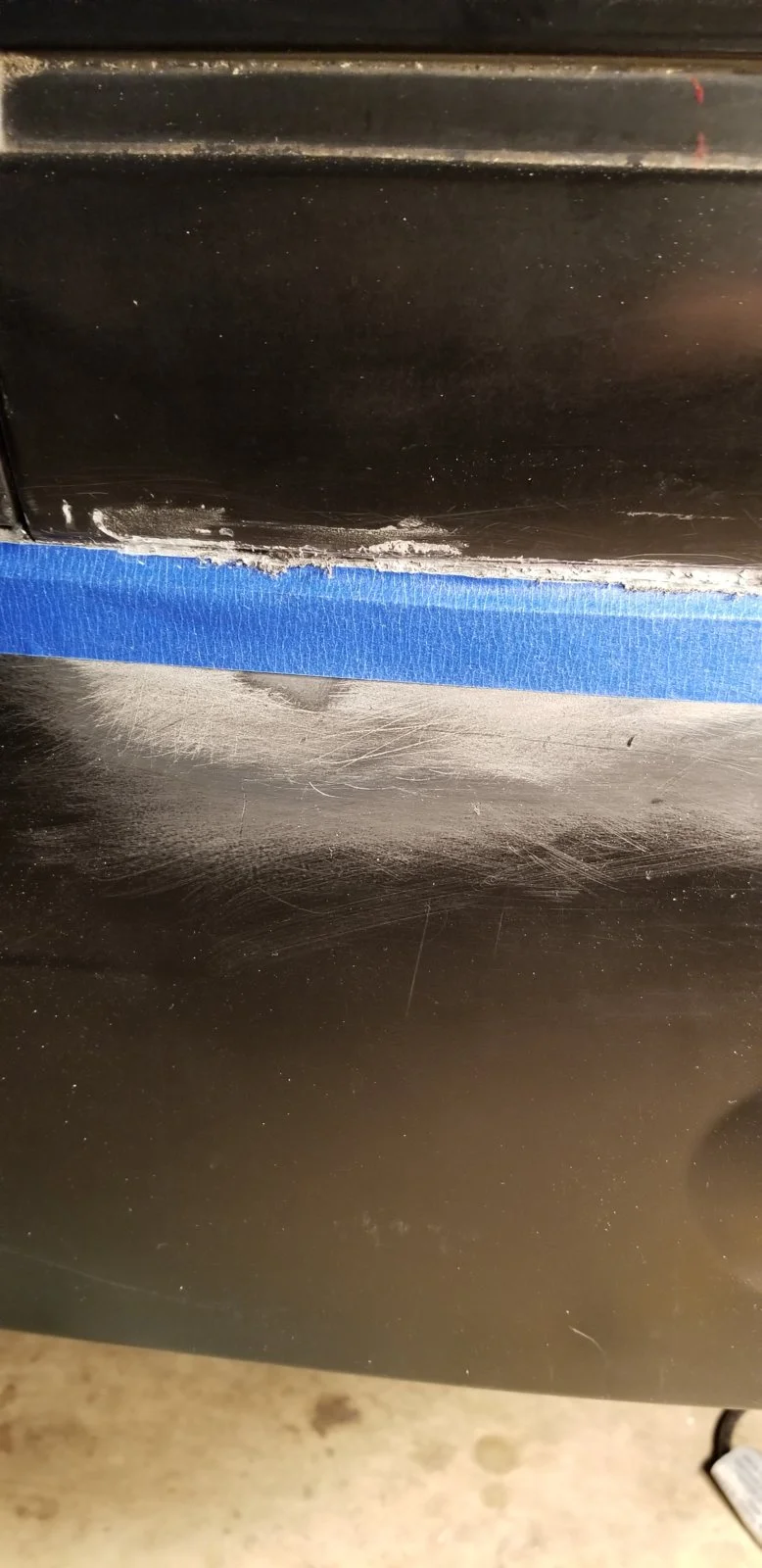

Since I couldn't prep for paint.... so I started doing the body work on the seam of the bumper. Tomorrow I hope to finish up the front. i used my Dremel with the 45° attachment and marked off 3/8 of an inch. Made quick work of it but it threw melted plastic and PBA dust everywhere.
That's it for tonight...
On the Cobra bumper 1.0 I used 3m4747.... then ( because water and debris got behind it ) I sealed the top edge with seam sealer. Now, I used 3m8115 and it holds the bumper great. The dream dealer is still in the crevices below the LX bumper moldings. This absolutely sucks.
........NOTE TO SELF..... Don't use that crap again on a last bumper. This stuff just rolls up in little gooey balls.....leaving just enough crap behind to be a major PITA :fuss:
Got all the seam sealer out... who knew a pocket screwdriver can be your best friend while doing body work.

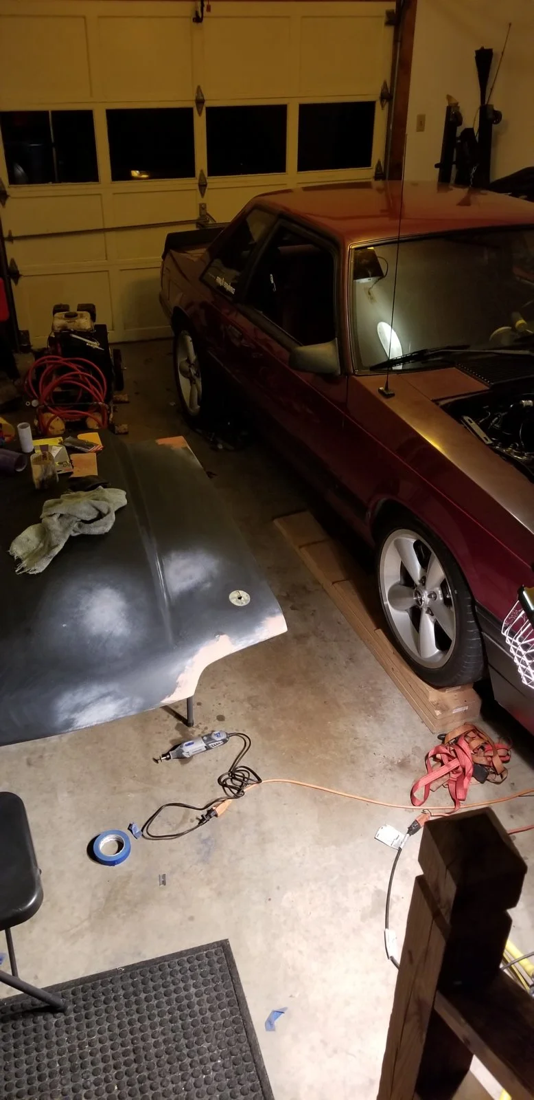

I got a bunch done with the first layer of filler applied and sanded.
If anyone's followed this slow progress then you know it's been a couple years to get to this point. I worked on this thing from 10am until just now.
It's coming together, though.
