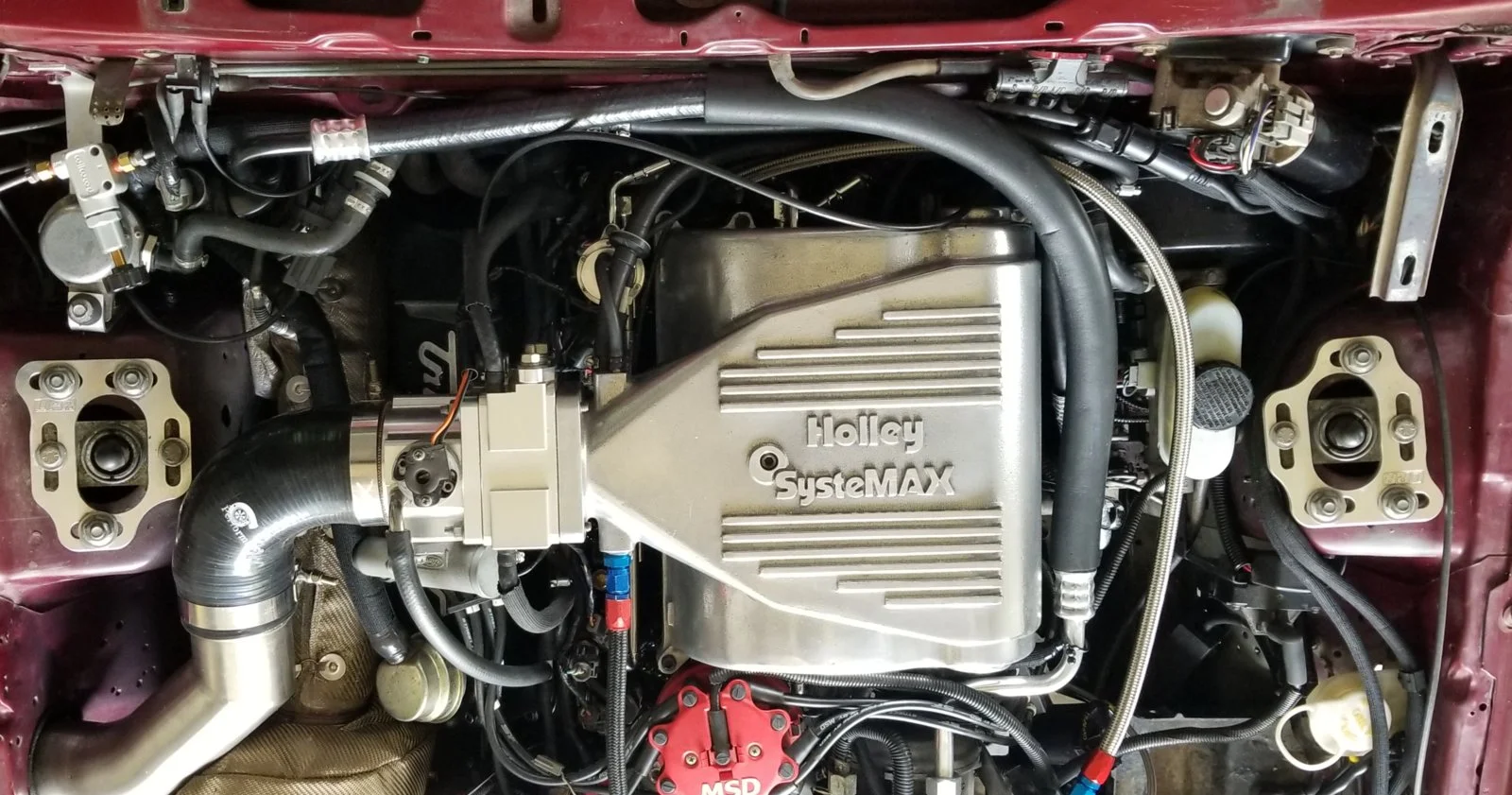

Big plans didn't happen. The 49 is not in our driveway yet.
Ran into another issue last night. I put a minor tear in my only sytemax upper intake gasket. I'll piddle with it a bit more until the gasket comes in.

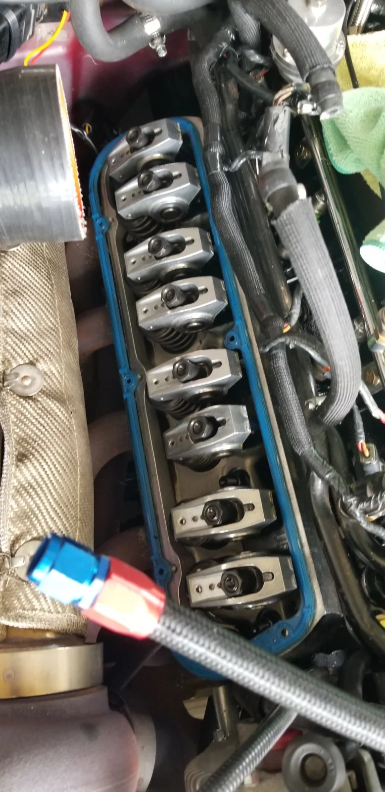

Adjusted the valves ( they were not making a bunch of noise....just wanted to check them all ).
Here's how Dusty sits today. Maybe I'll put some more paint and clear on the valve covers.
I should clean up the harness at the firewall and finish wiping it down. I should....but....

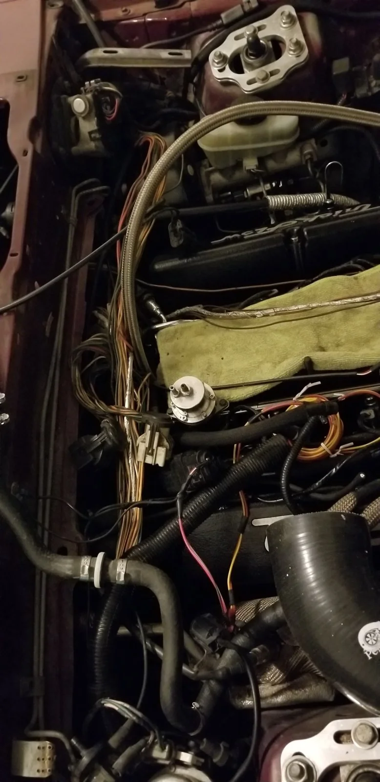

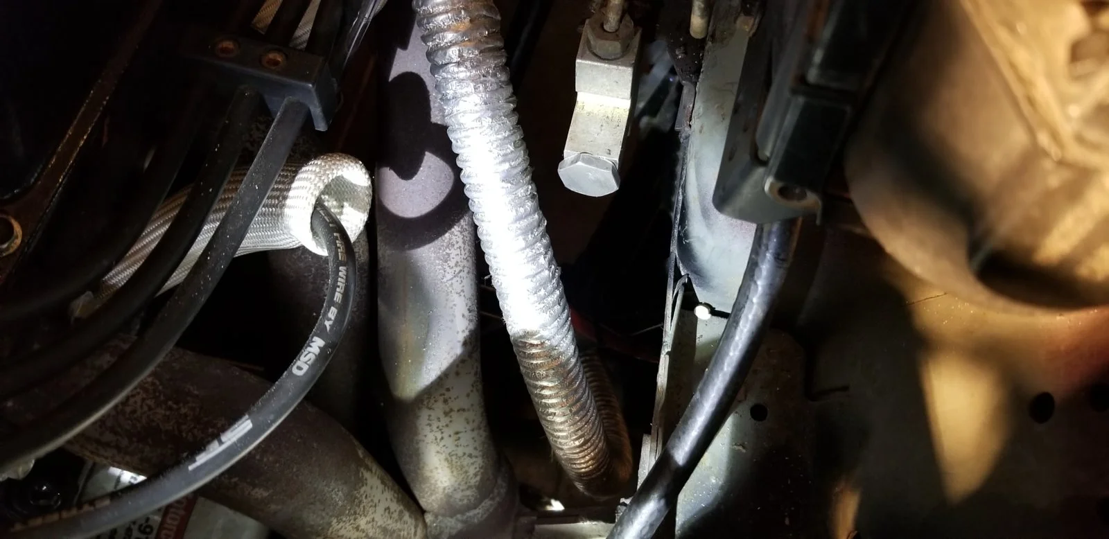

Started pulling the harness apart. This stuff was wrapped by almost 15yrs ago. Whatever tape I used was the bees knees. That was around the time I learned to only use electrical tape that had the UL symbol printed on the inside of the roll. The engine bay has irritated me on this car for years now. This was supposed to happen when I pulled the engine and transmission for the " beautification process ". The car existed in this state just to get it running. So much for that.... I'm tackling it now.

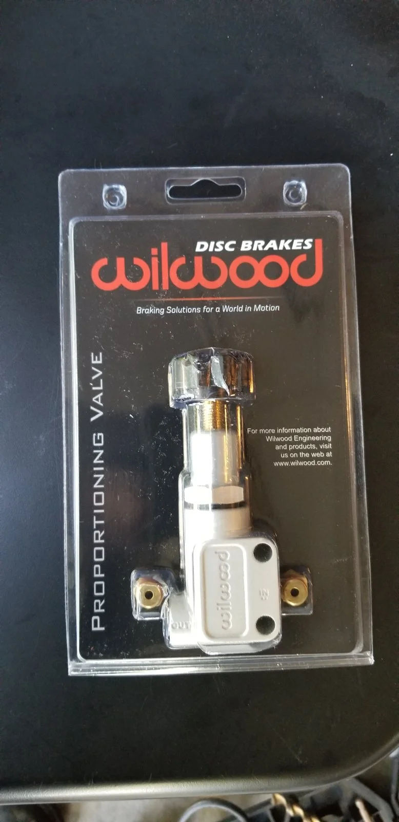

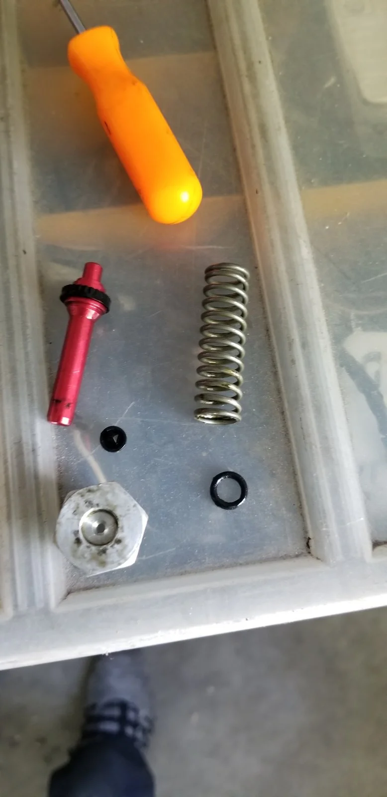

I've been using the stock prop valve for a 98 sn95. Back in the day we used to pull the cap off, gut it, and tap it for 1/8th not for a pipe plug. Since I had all the stuff I decided to do the same.
It works...that's how we used to do it. However, I don't like the look. Guess I'm slowly turning into one of those people. I didn't uses to give 2 $*t$ about what something looked like as long as it worked.
By the time you read this one will be on order. I had the stuff sitting around so cost me zero. Was something to get my mind off all the folks getting this stimulus money. I checked IRS...no money fo po me.

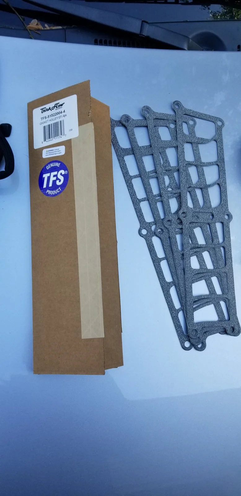

Glad I checked Summit. They had these 4 gaskets for my Systemax for about 24 bucks. The gasket I usually order is about 40 bucks each. LMR is taking care of my current order. Can't wait till next weekend, Dusty, will be driving again.

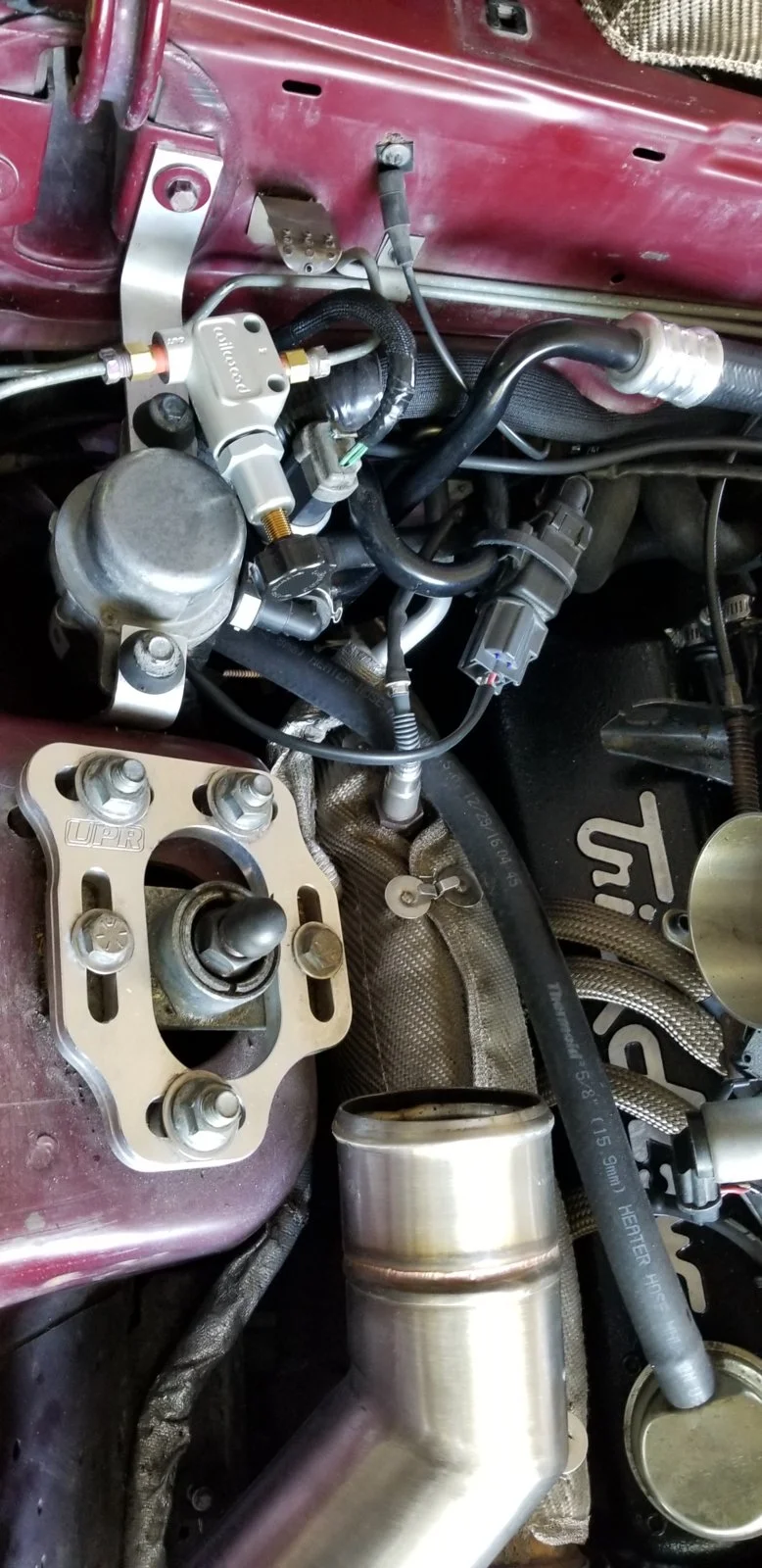

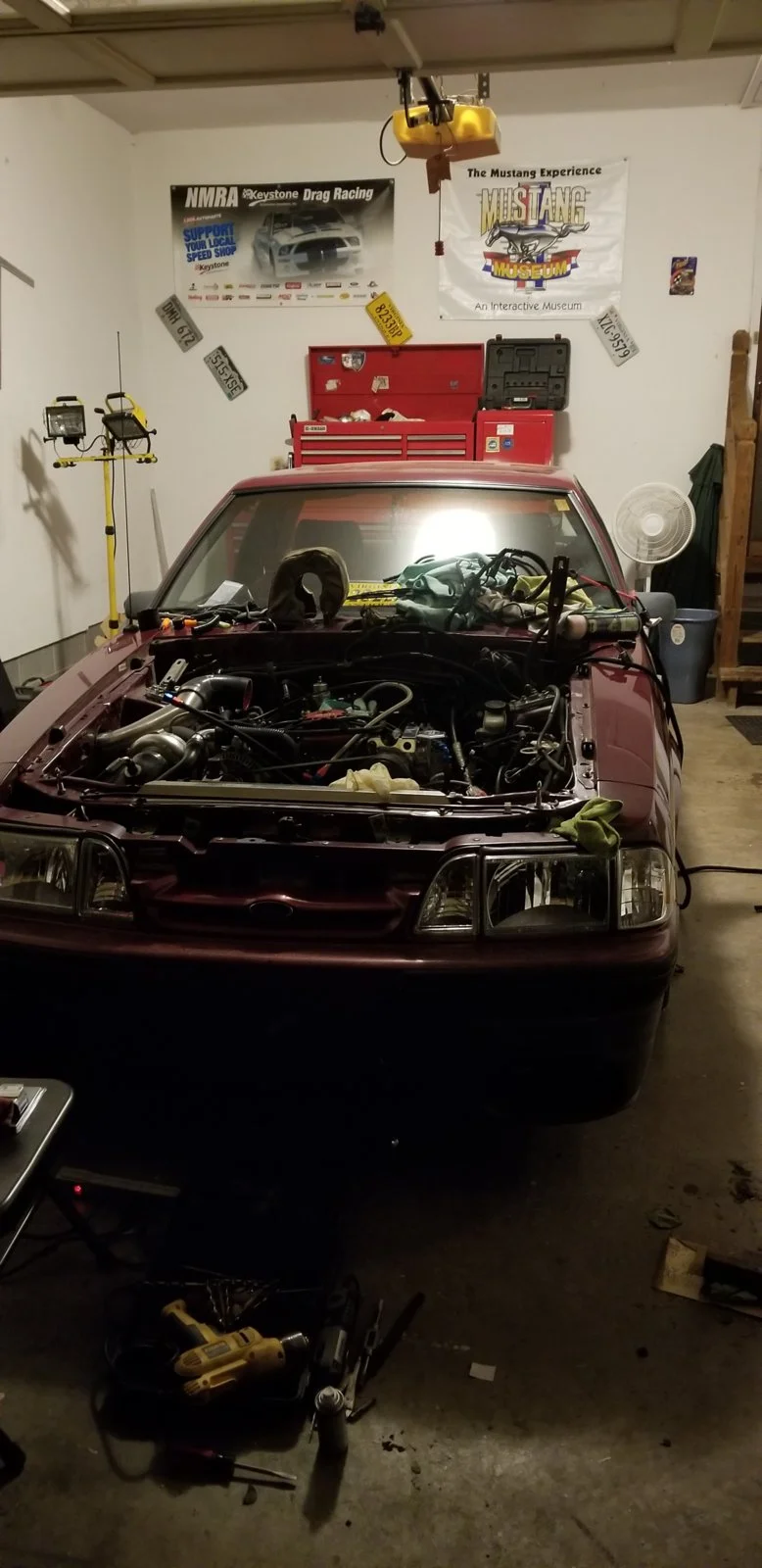

This thing is back together and a little cleaner and tidier.
The manual proportion valve fits perfect above the vacuum pump. No need to reinvent the wheel on this one. Now the engine bay is balanced with the wiper motor and bunch of wiring harnesses in the other corner.
Still need to fill the coolant, put the car on stands, and bleed the brakes. Waiting for LMR to deliver the plug and a couple other goodies.

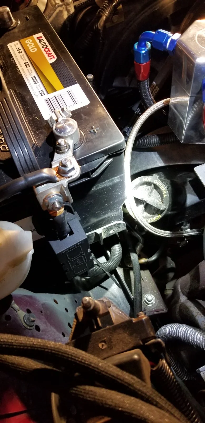

Oh yay !!! The joy of redoing battery cables. I found a little corrosion at a cable splice to the main battery cable. It came with a little screw that clamped the cable in....that thing sucked. I found a battery post clamp that I had laying around. If my MAP gas torch wasn't empty and the stores didn't close at 7 this would be done already. Looks like more unplanned work on Dusty. My partial tuck puts most stuff behind the drivers fender. That's a good thing 'cause I've got to pull the wheels to bleed the brakes anyway. I'll stop after work and grab a bottle...and a self lighting torch. I'm getting lazy in my later years ( 42 haha ). Tired of having to find a lighter or a spark box.
That little plastic strap is going to get removed. Most of them are broken on most cars. I was proud of my washer bottle lid strap...oh well...its in the dang way.

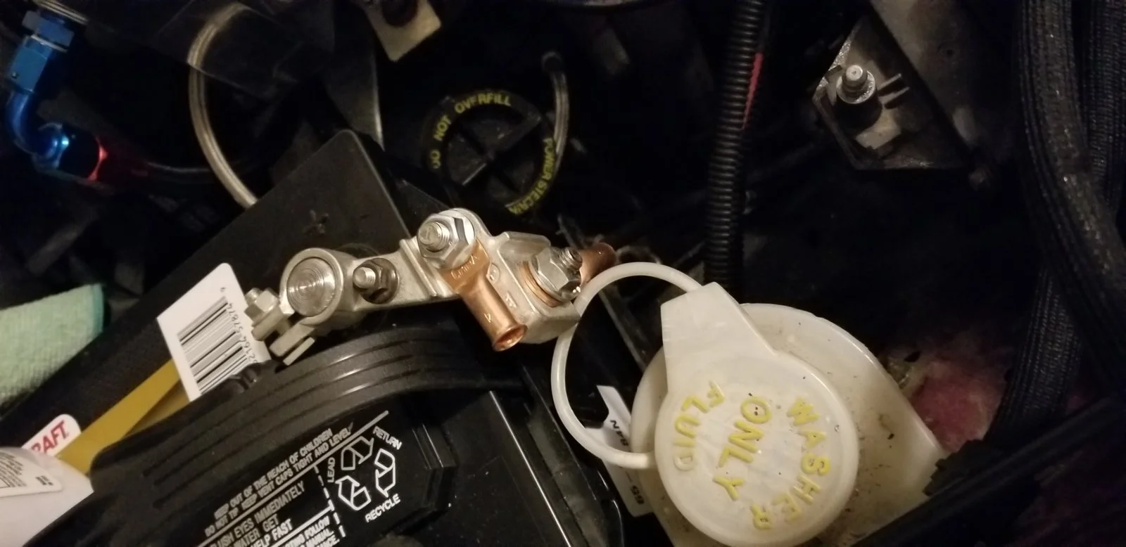

This whole working on the car thing always turns into more stuff.

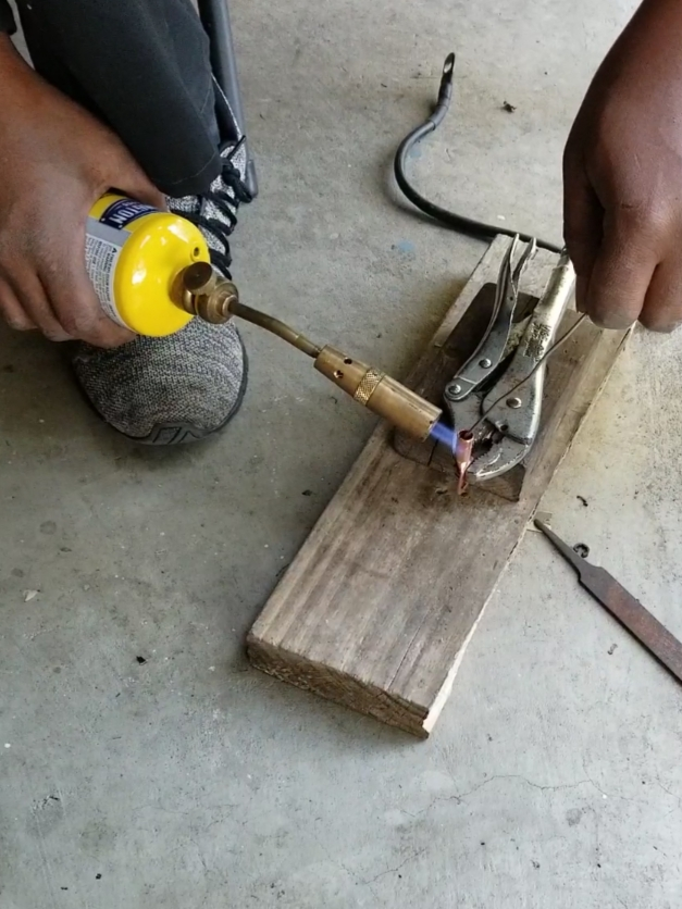

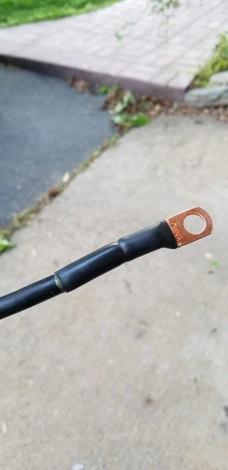

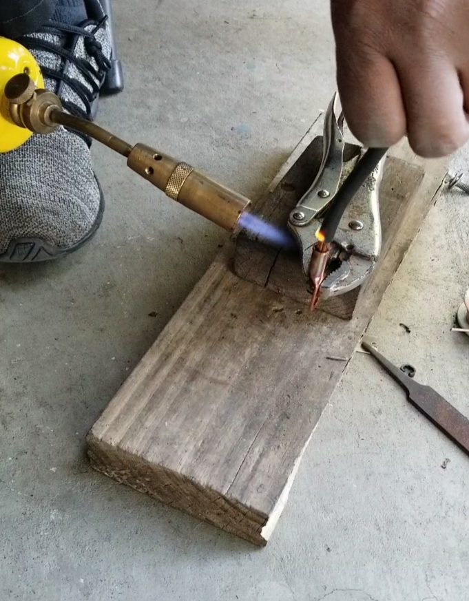

Had some fun with some battery cable ends.
Add some solder
Insert cable
Add heat shrink
Finally did something about the alternator fuse that kind of just floated around between the battery and the coil.

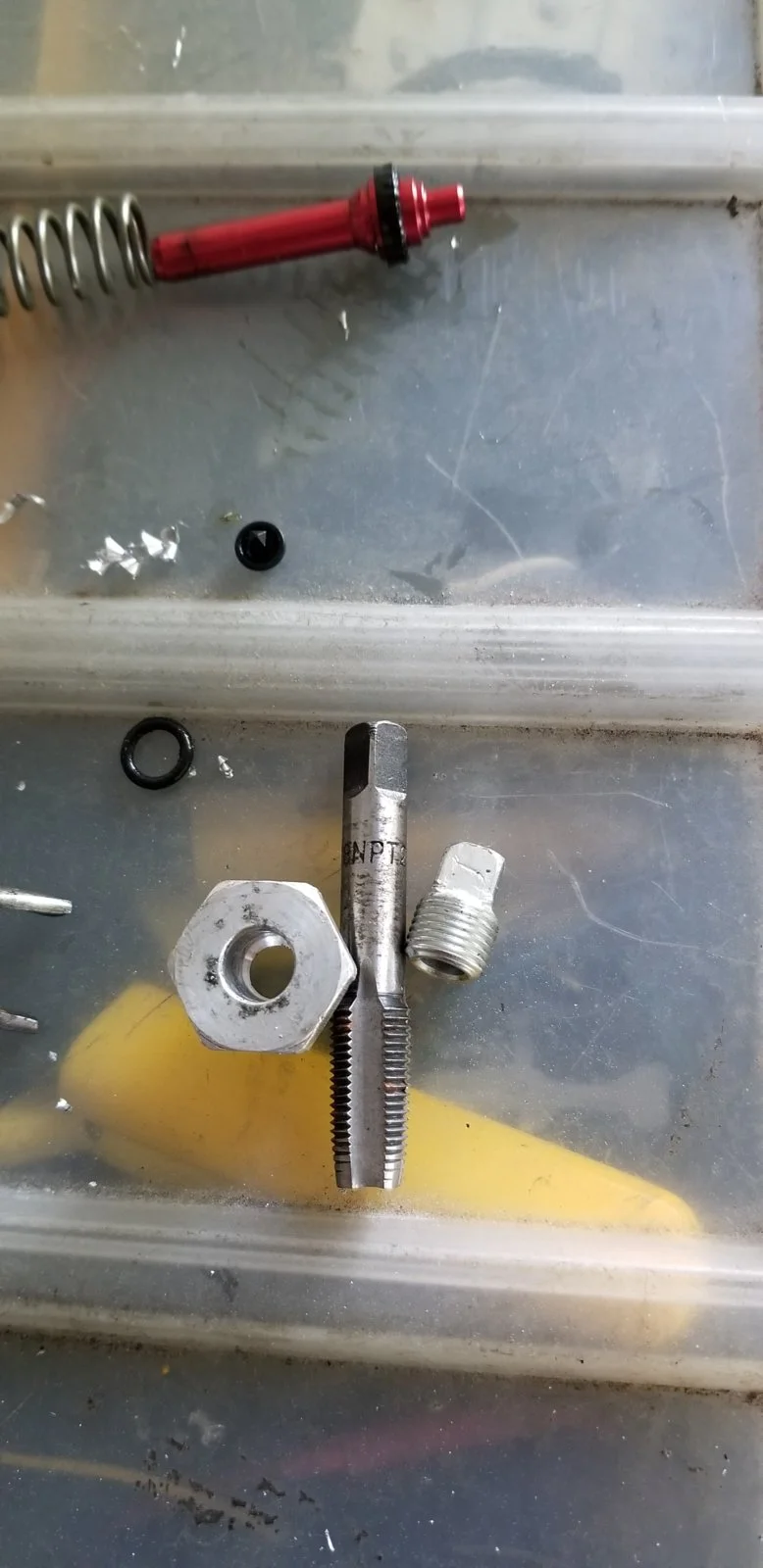

The cap for the 98 prop valve came in today. Got the o ring GB swapped over and the thing installed.

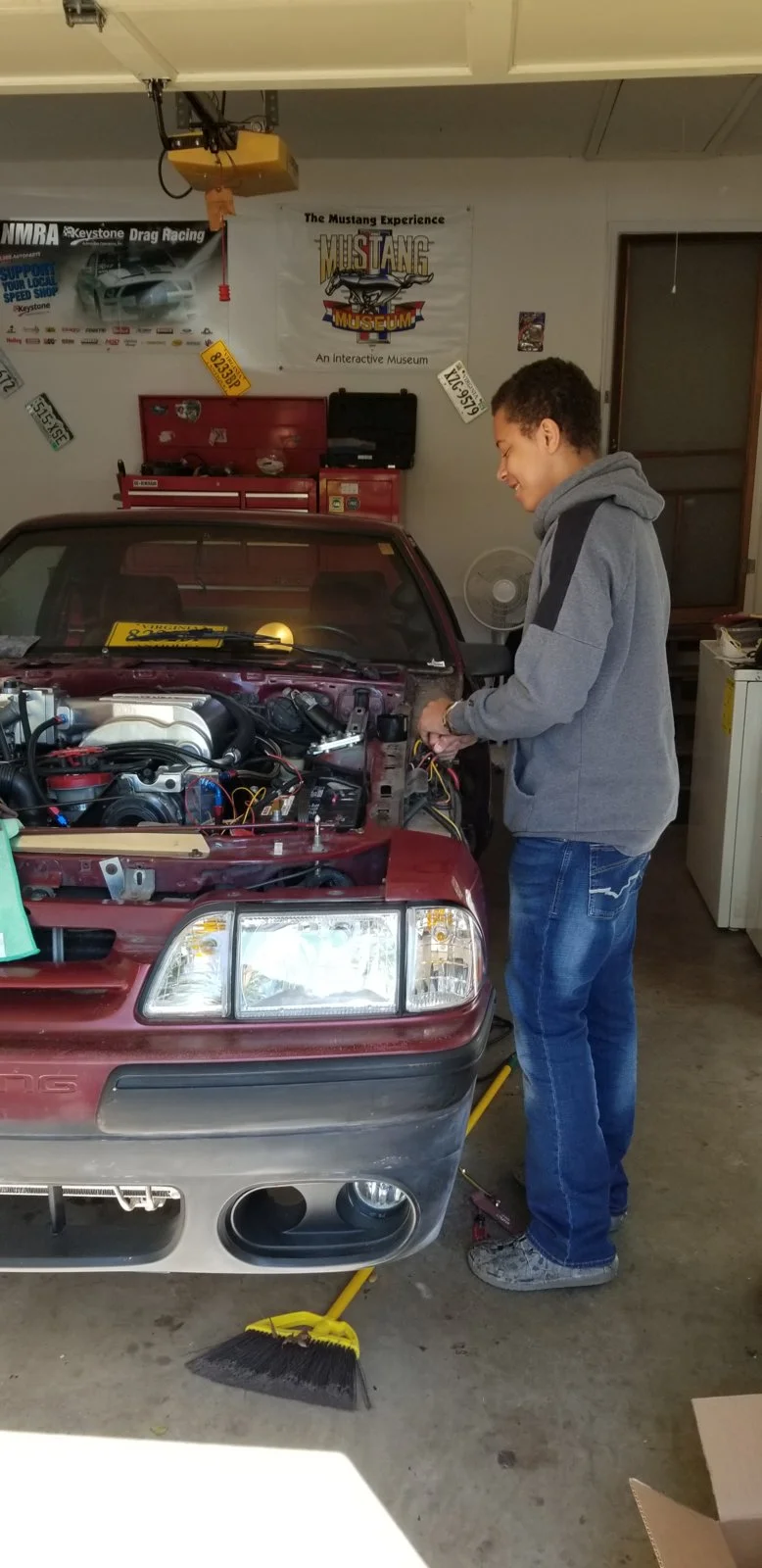

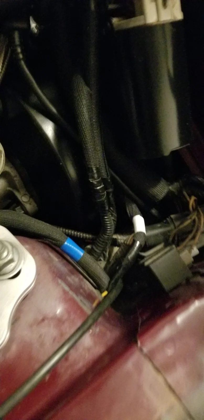

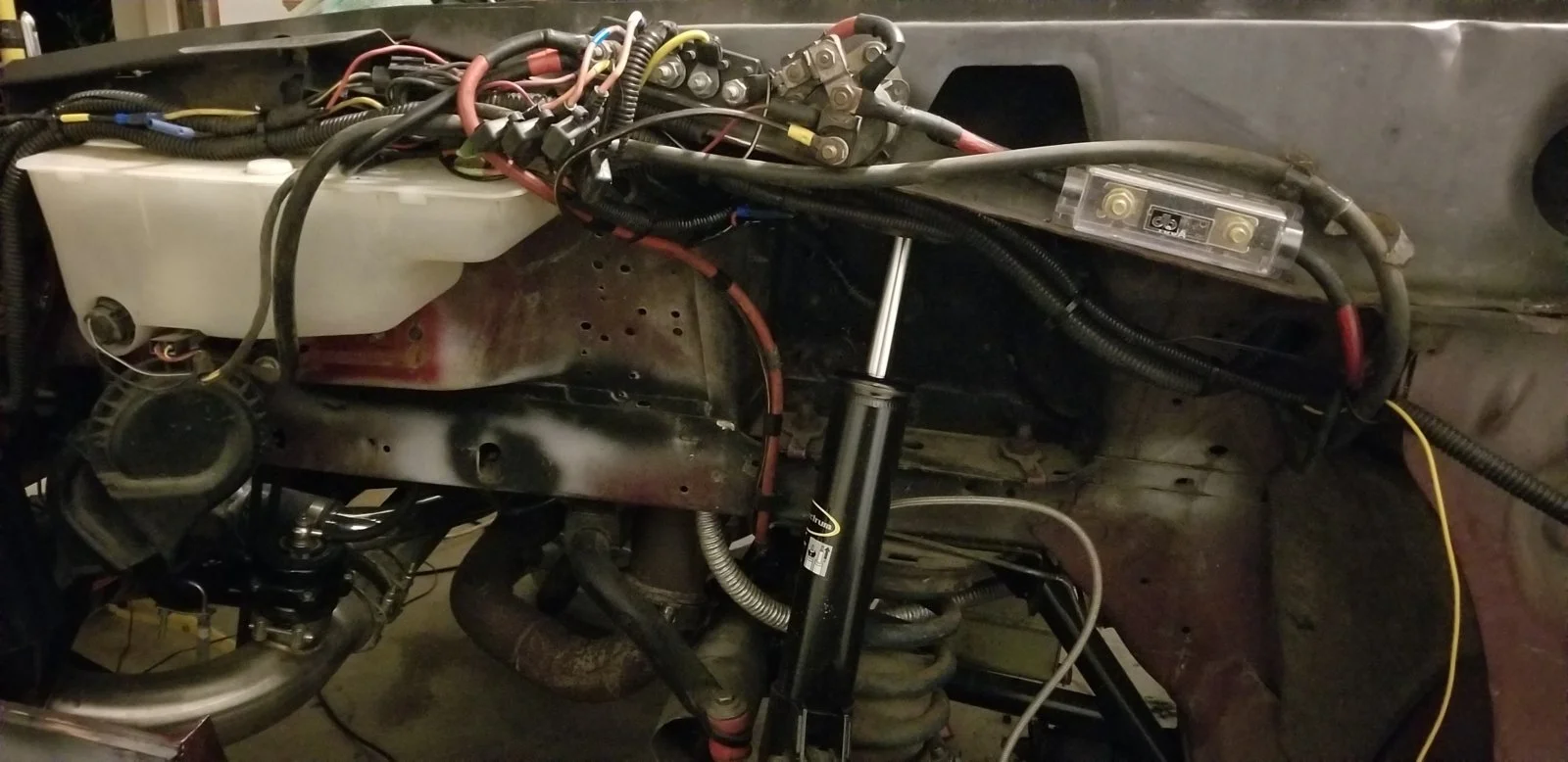

When I did this half wire tuck I was outside in my driveway. I said I was going to straighten it out so today was the day. All of this from trying to wire in the vacuum pump.
Had help....my 13yr old removed the drivers fender and installed the little triangle mirror covers. The guy did an excellent job.
This is the aftermath.
What happened was....I got to the harness and had no idea what I was looking at. I had a mysterious green wire that was unplugged from somewhere. Didn't know what it was for or where it went. Traced it and found it was the tach signal wire to my Autometer. Then remembered that I had just stuck it in the ground connector of the coil and never wired it in. That had to change.
Another quest that started as a gingerly walk down wiring and solder road ended up being an all day thing. Rerouted all the wires. They look a little bunched up because the factory wiring and connectors are still there. I refuse to remove any of it. The four added things are the vacuum pump, cooling fans, fog lights, and the line lock. I had no fuse going to the fog light relay...just straight wired. I know I thou thought it was temporary but I must've been drinking something really good.
Everything is now labeled ( green masking tape made into a tab that has what the circuit is on it ) and the fuse holders are color coded to the harnesses they relate to.
White for vacuum pump....blue for the fans...yellow for the fog lights.
All the added circuits are on one post of my GM truck power distribution block. The harnesses have been organized, taped, labeled, and secured. Got it all done....except the ignition power wire for the vacuum pump relay. Yup...still gotta do it. All my circuits are ground triggered so no obvious wires behind the fender. I'll find one tomorrow or run the wire into the car and tap in there.

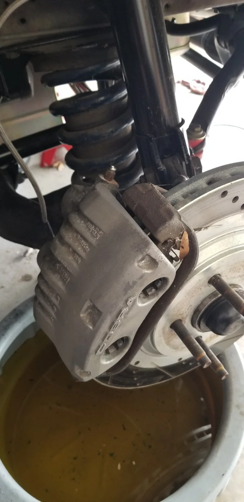

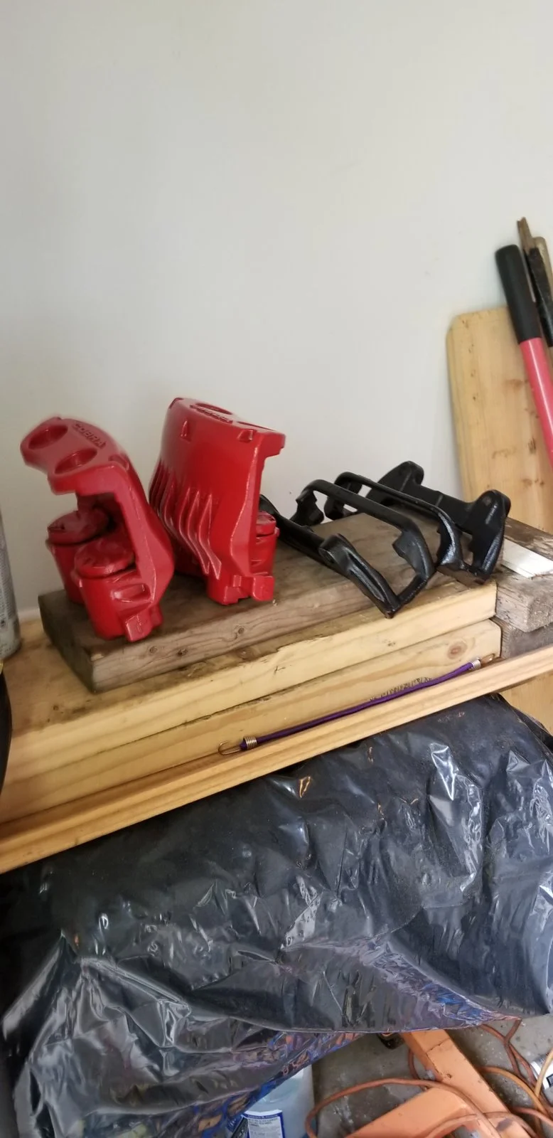

Yippee !!! Got Dusty running today. Had to call Steve and pluck his nerves. I ended up finding that my IAC valve is bad. I had timing issues and the IAC had the car running at 1600+ rpm. After freaking out I unplugged and plugged it back up, that didn't work...so I banged on it. Sure as $hit the idle came down. I never removed it with the work that was just done. Don't know why it happened but it's running again.
I also did this. Not a huge fan of red brakes. These were originally red before I stripped them ( powder coat was terrible and the aluminum was oxidizing under it ).
Here's a before...
Here's the during...
There would be an after today but I had to order a new hardware kit. The pins were pitted with rust. $7.62 later and O'Reilly's should have it in store by 11:30 tomorrow. Gives me time to remove and paint the rear.
