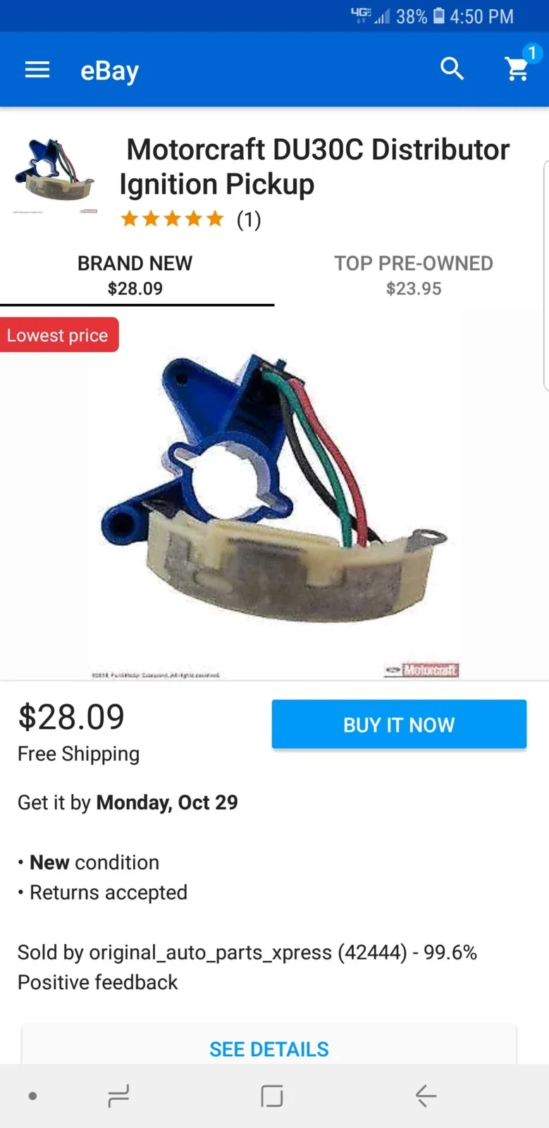

It sounds to me to be something that is caused by heat. When this happened to me it was the pickup coil inside the distributor.
How do I go about diagnosing that? It’s a stock distributor, original to the car. Just changed the cap, rotor, wires and now the TFI module.

Take the cap off and look below the metal plate the rotor sits on. You'll see a little sensor down there. It shouldn't look powdery or soft. All the ones I've found that we're bad has some weird corrosion.... almost like battery acid on a battery post. It's easy to overlook.
It's the part the TFI module plus into inside the distributor and reads the metal piece under the rotor button.
