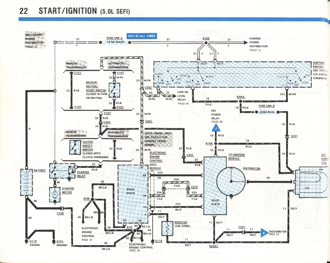

How did you determine that none of the fusible links near the starter solenoid are blown?
Continuity check does not work, 1 strand of wire will show good even if the remaining are melted.
EEC Relay is D & G.
I can't find N on any of the Ford drawings.

OH! NVM! I found it on page 19 it says it should be under the master cylinder. :/ Oops, I might have pulled the wire out of the fusible link when I was putting my Cobra booster in...

It says it's in the wiper motor harness dumb thought but I will ask anyways though I almost 100% sure it shouldn't but having the wiper motor unplugged shouldn't hurt anything should it? I'll feel really fudgin' stupid if I plug the new wiper motor, (old one was noisy as all hell), in and I get voltage where it needs to go...

Finally found N on p.22
It's function is to provide power to the EEC Relay coil from the ignition switch when in the Run position.
Follow from p.22 to p. 29 via the blue triangle "J"
N has nothing to do with the wiper motor.

Yeah I figured it had nothing to do with the wiper motor. It's just that the picture on page 19 vaguely shows it being in the wiper motor harness which it's not. However I found the link under the hood and I think I've found the issue. It may have been self inflicted but I'm not sure. Anyways the link is practically broken. I can fold it 180 degrees. Looks like I buying fusible link wire tomorrow.

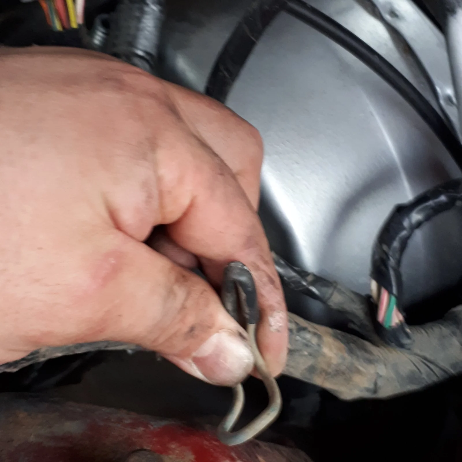

The only way you can burn that up is to short circuit the EEC relay coil or short pin-86 of the relay to the body.
In normal use, the relay coil draws about 1/4 amp. 20ga fuse link is probably the smallest there is. Parts stores have no smaller than 18ga. Amazon has them.
Fuselinks are sized 2 wire gauges smaller than the wire they are protecting (16ga).

If it was burned wouldn't it burn right in half? This one feels more like it's been kinked/pinched and broken since it's still in one piece. The relay is a 5 pin numbered 1 thur 5 so pin 1 would be 86 but that circuit does go straight to ground through pin 2 when power is turned on at pin 1. Also why the hell are they using a 20ga fuse link if it's a 16ga wire? Wouldn't they use a 18ga to protect it or is the wire 18ga? I haven't had a chance to measure the wire. Summit Racing also has a 20ga fusible link, must be a new old stock from Pico because Pico no longer makes them.
Absolutely NOT. The link I provided will answer your questions.
Fusible links perform the same basic function as fuses, but they go about it in a slightly different way. In automotive applications, a fusible link is a length of wire that is several gauges thinner than the wire that it is designed to protect. When all goes well, this results in the fusible link failing, and breaking the circuit, before the protected wiring can fail.
In addition to simply being thinner than the rest of the wire in a circuit, fusible links are also encased in special materials that are designed to not catch on fire when exposed to high temperatures. So while extremely high current in a regular wire may cause a fire, a blown fusible link is less likely to do so.

I'm still alittle confused by this because it honestly doesn't seem burnt out. It looks like it got pinched somehow and broke since it still feels solid on either side of the pinched spot. Wouldn't I be able to stretch the sheathing out if it was burnt out? Also how would that particular fuse link burnt out? Would extended cranking do it because I'm not entirely sure what would have cause it to. Also won't the circuit be completely open if the link was burned out? I had a resistance value and continuity at the EEC relay plug so it's obviously not completely open.

Well I got the new link on Friday and soldered it in and hooked all the wires all back up and tested see if I had 12V. I did so the link was broken. I appreciate all the help guys thank you!!
