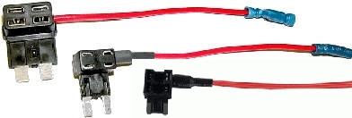

You don't want it wired into a constant 12v source for power. I'm not sure how you have to wire it, but somehow it has to get to key-on power, so the only time it runs is when the ignition is on.
Maybe someone else will chime in here, I have a DC Controller so I'm not sure where you need to wire it.
I would use a digital multimeter and find a source in the fuse box for switched power. Then use one of those add-a-circuit things below. They have them at parts stores.
Another one I found online but I'm not sure how many amps the fan draws:
http://www.accessafuse.com/access.htm
