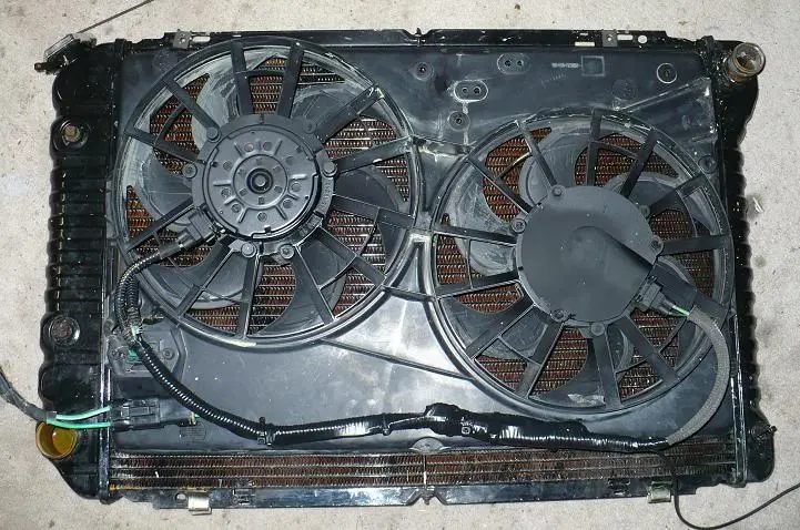

The Contour/Mystique fans can't be beat. You can use any year the car was made with a V6. Like stated above they fit great and are cheap from the junk yard. Here is mine mounted to the radiator.
