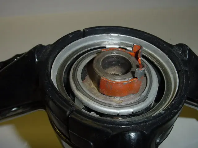

suki243
Tim you were right, it's the Turn signal switch. Since mine doesn't cancel by itself sometimes it remains in whatever position it was before. E.g. if i had just taken a left and not fully turned off the signal it will cut power for the brake light on the left side. However, I don't have the socket big enough to open up the steering wheel nut in order to adjust the canceling mechanism. I'm going to have to either take it to my mechanic and have him open it and i'll adjust it from there, or go to my painter (who replaced my steering wheel ) and have him open it. Do you have any pics of what the canceling mechanism looks like and how to adjust it?
I have since switched to a '68 column which has an entire different switch.
Here is a pic of the back of my old steering wheel with the cancelling ring still attached. When facing the front of the wheel the two nubs are pointing to the left. (9:00 position) It's made of spring steel, so adjusting it is just a matter of rotating it with som pliers.
Don't forget, depth is important too. If it's too deep (toward the switch) it will contact other parts of the switch and cause problems. If it's not deep enough it won't contact the two canceling arms. Have you ever removed your column? It might be shifted foward or back a tad causing problems.
