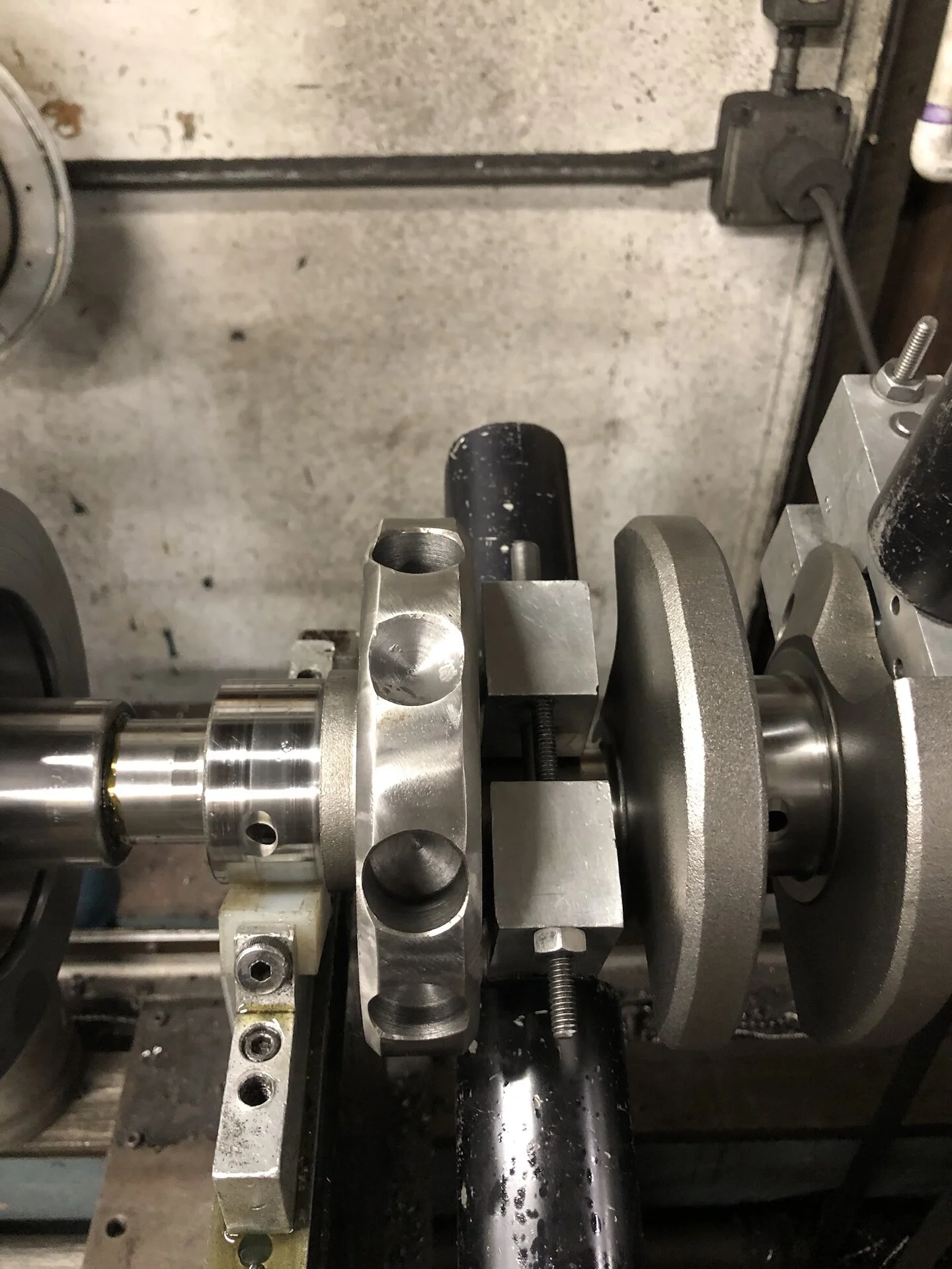

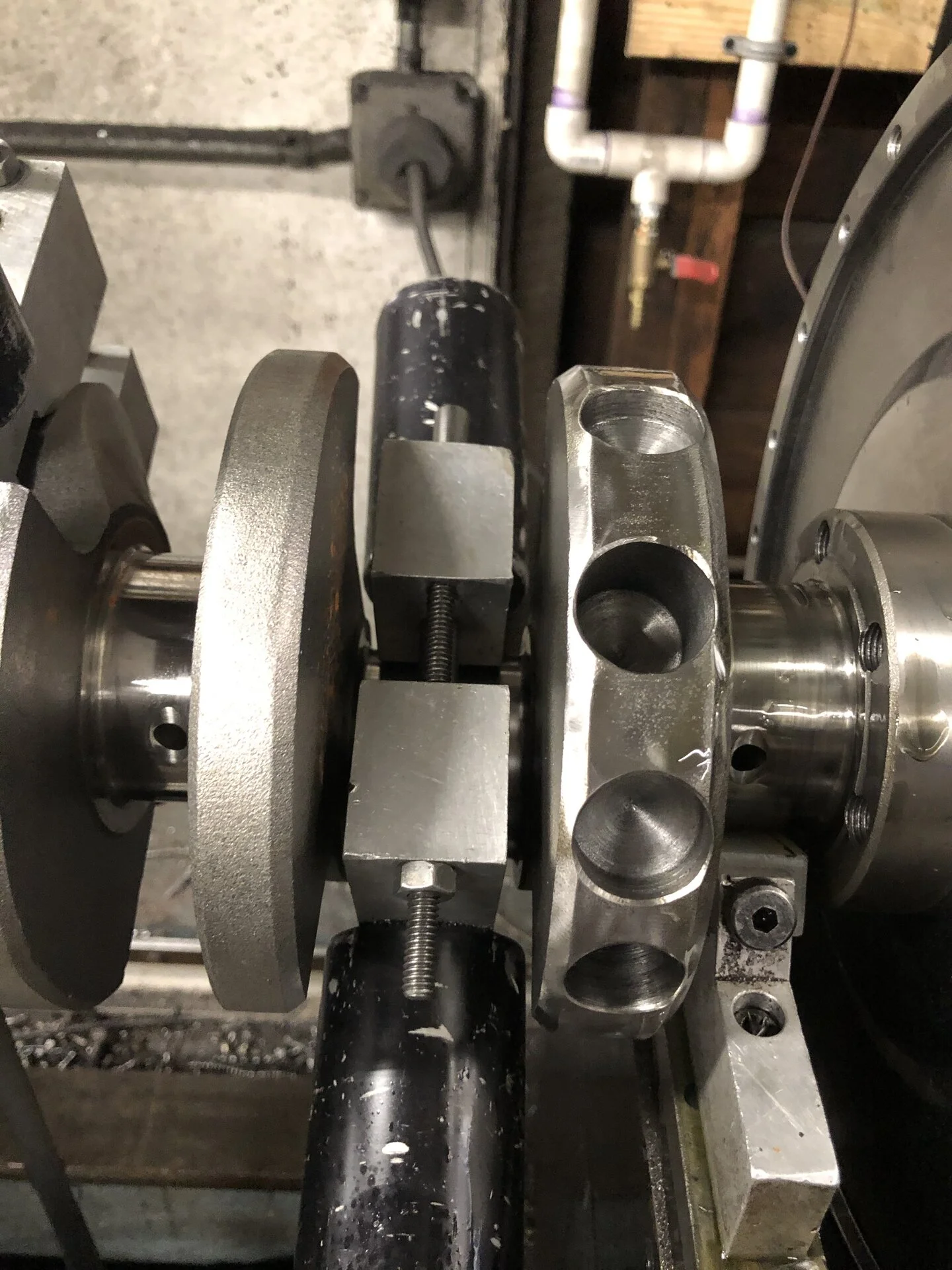

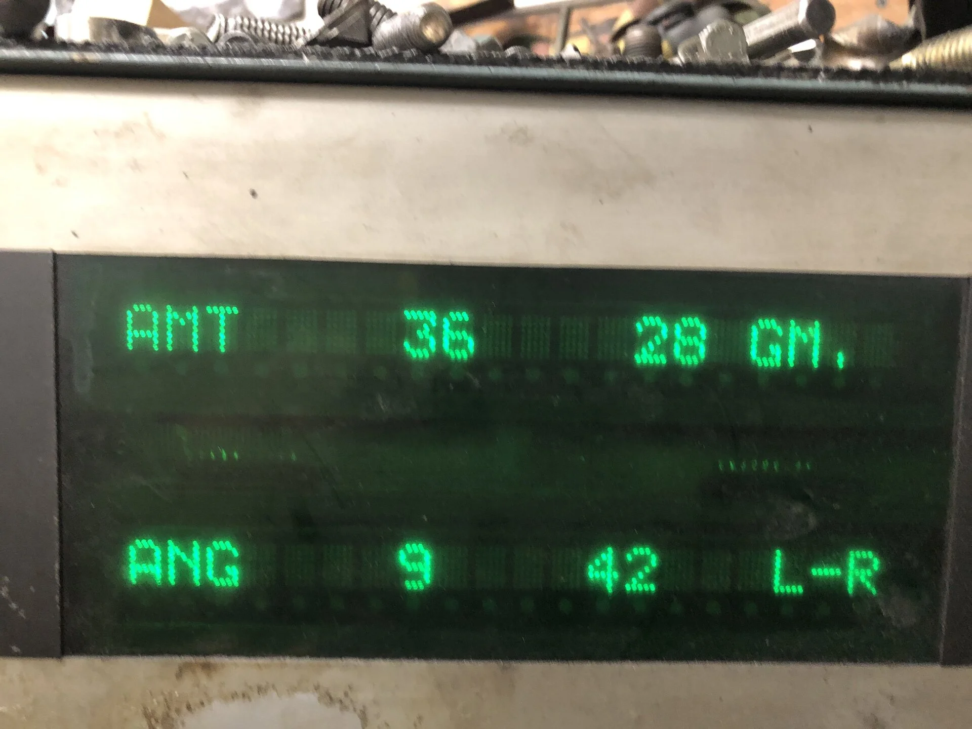

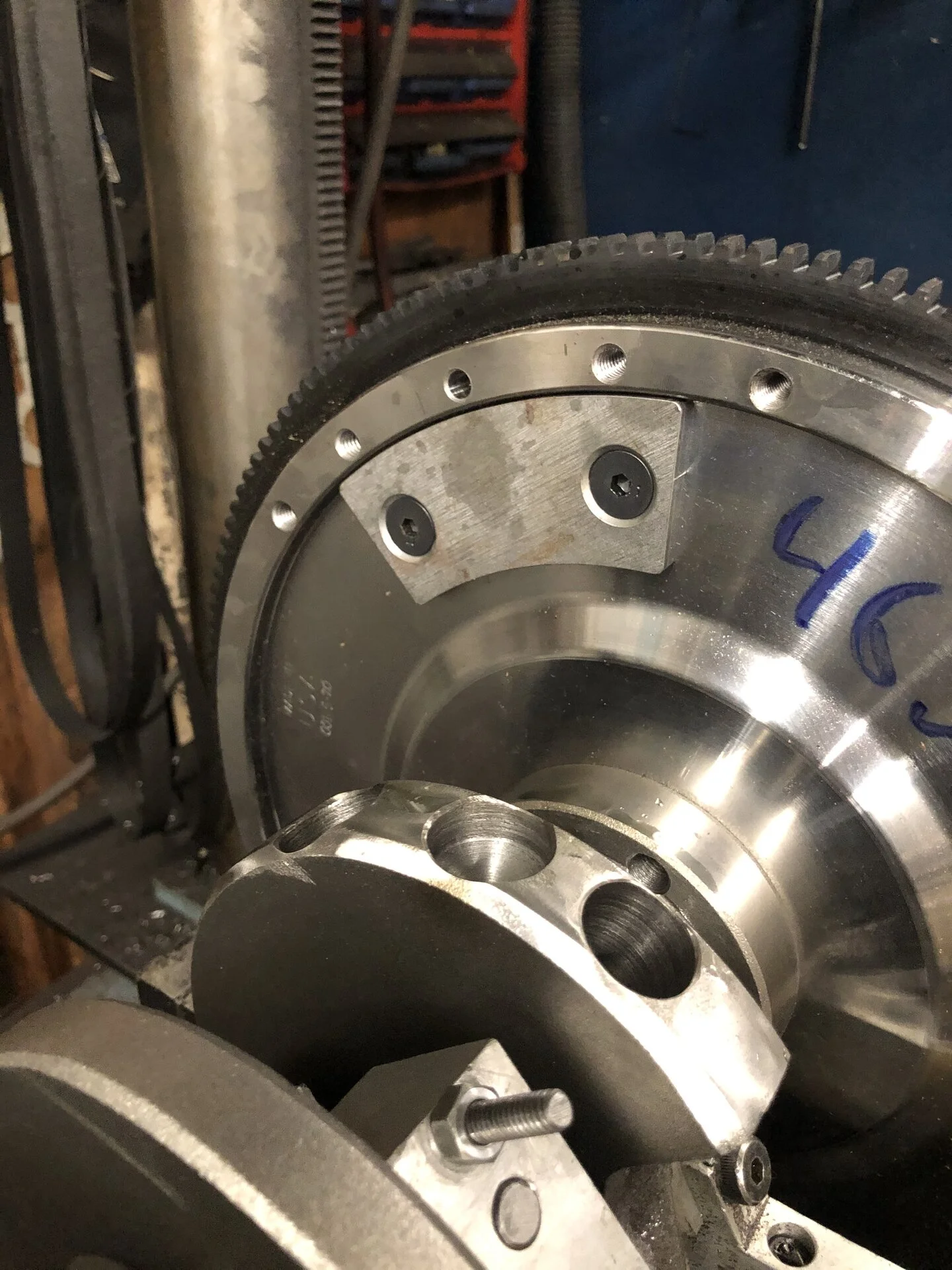

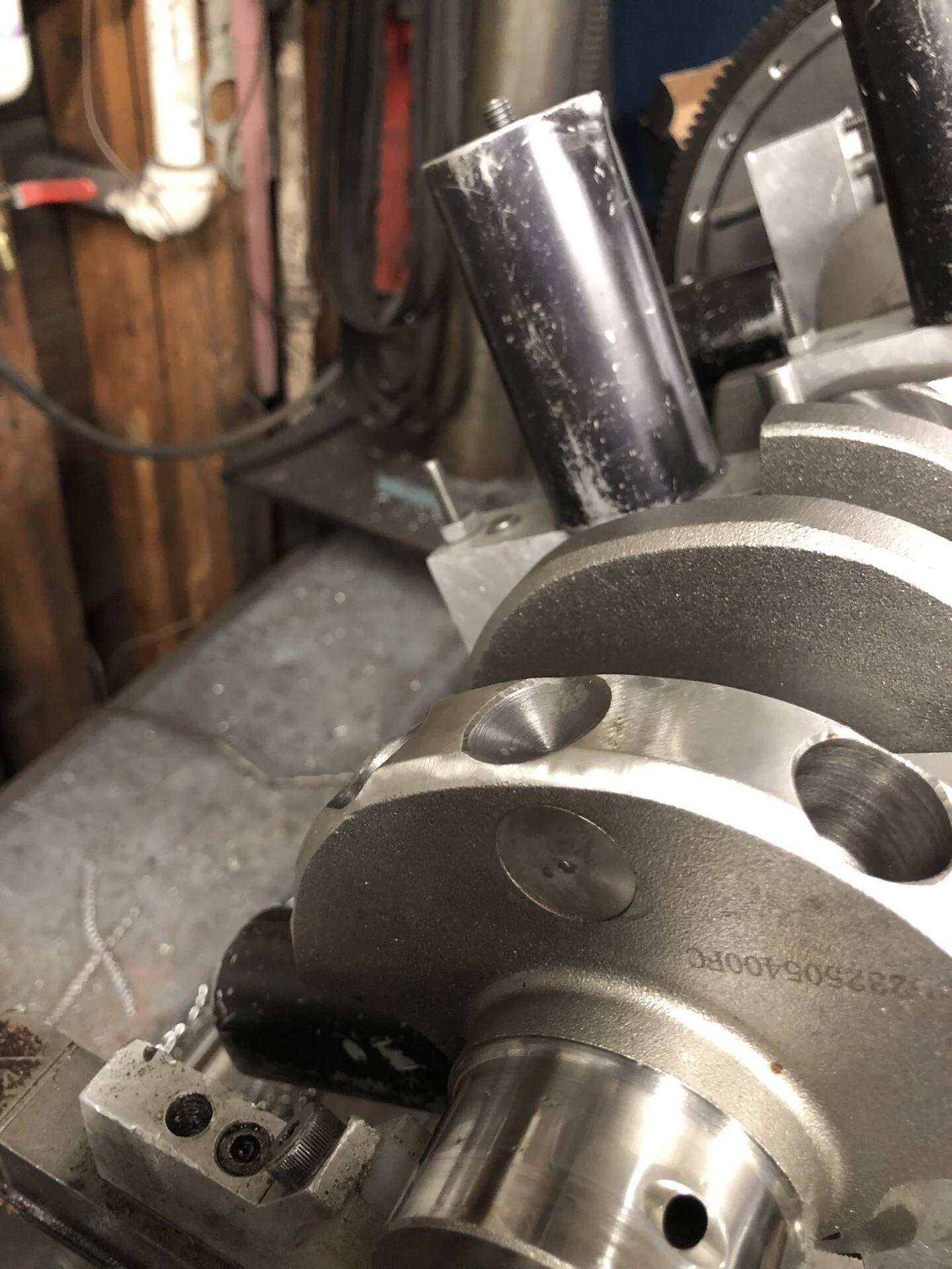

Bought a Ford Perf adjustable Balancer/Damper 50/28/0, and a McLeod 50/28/0 Flywheel & they were both dead on.
https://www.coasthigh.com/
Craft Performance Engines | Arkadelphia, AR | 870-246-7460 | Made in the USA!!
Craft Performance Engines Specializes in High-Performance Ford 302, 351 W, FE, 390, 427, 428, 460, Cobra and Mustang Crate Engines. Custom Engine Building and More!
www.craftperformanceengines.com
PS, Last picture you can see where the Mallorymetal was correctly installed-horizontally. The holes drilled into the Crank’s
offset weight were 1” in diameter, and 1” deep, except for the holes in the center of the throws, as the Mallorymetal is pressed in below those holes. “Mallory metal” is basically just “Tungsten”, small piece weighs much more than the metal the crank is made of. Got a free Crank out of it,
Talk later, good luck!
