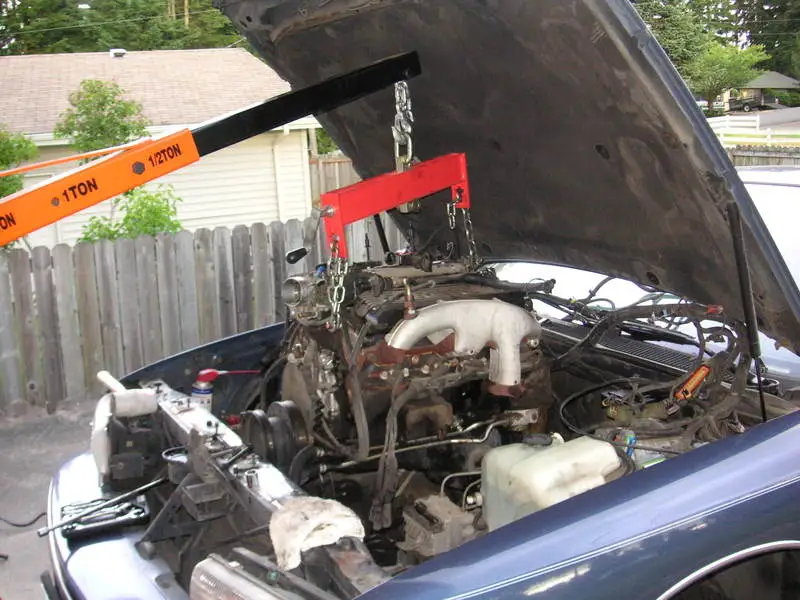

I have used a ziploc bag and rubber band to keep tranny fluid from falling out. Also parts store sell an attachment with a long lead screw that makes it easy to shift the weight of the tranny as you pull it out. Came in real handy when trying to install a 440 w/tranny in a 68 charger by myself.
yeah that thing makes it way easier. without it you'll need a couple friends to guide it in.

whats this attachment look like and called? can you find it at your local chain auto store or is it more of a specialty / order only item

I think you can rent it at autozone, its like 2 feet long, 1/2in all-thread the whole length. cant remeber what its called

Engine Load Leveler for use with an Engine Crane.
