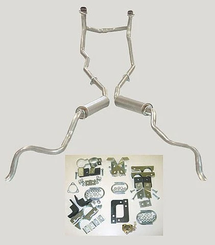

Just to clear any possible misinformation:
H- better low end torque + louder than no crossover
X- Better mid and High end torque + quieter than no crossover
The system in the picture is not mandrel bent therefore it flows at least 50% less efficient that a mandrel bent system like the Magnaflow or Pypes kits.
