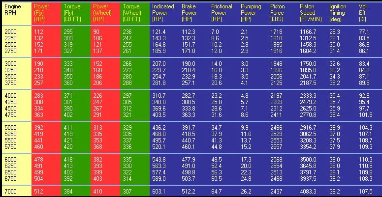

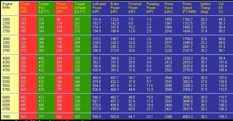

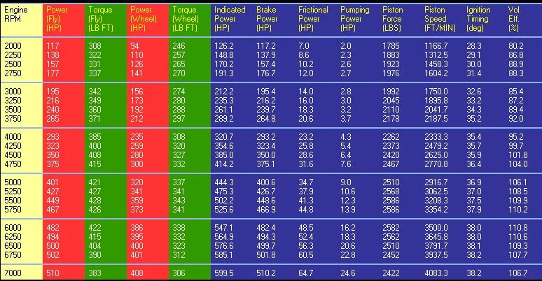

What I found using a Comp XFI236HR-14 236/248 Hydraulic Roller Cam ( https://www.compcams.com/xfi-computer-controlled-236_248-hydraulic-roller-cam-for-ford-351w.html ). The Comp grind is only .579 lift. I stretched it to .608 for these tests.
The first one is at straight up degrees. The second is -4 from suggested. Also, note the ignition timing...I wish the simulator would let you pick a better combustion chamber. They give you 3 to choose from from each (flat, wedge and a Hemi/Pentroof) The ignition timing setting is on auto in the Sim. Your results obviously varied. I entered the flow numbers at each point of lift off the TFS spec. Spec'd a high performance open plenum manifold with a 1000cfm throttle.
The last one is advanced 4 degrees. Look at the meat in the middle. That's got street car written all over it.
Looks like this page is reversing the order of the pics as I post them. Highest number is -4, middle number is 0 and lowest peak is +4, but the middle of the power is the best at +4, by far.

Yeah the ign timing is way off from what it realistically would be, lost like 15 horse bumping up the timing to 31 if I remember correctly.

Wouldnt advancing or regarding the cam just change where the car makes power and not necessarily how much power The car makes?
You can make a litte more peak, assuming the heads are capable of flowing the air, but for the most part, you're correct. Really what youre doing by adjusting the cam timing fore and aft is trying to find the meat of the power band in the most likely used portion of the RPM range. That's why I suggested advancing the timing a little for the street. Even if its a street strip car, if its a daily driver, it'll be more fun to drive with that beefy mid range than wringing it's neck for top end giggle time. This comes from a guy that built an N/A Bug engine (early 80's) that ran almost like a two stroke, made almost no power until 4500 rpm, then would literally rip the front wheels off the ground in 2nd gear, or smoke the tires to the 9000rpm shift point. That car was fun, wide open. But driving away from a red light with a cop behind you...trying to behave yourself, not a lot of fun. My Turbo Charged 355 in a 66' C10 was way more fun.
