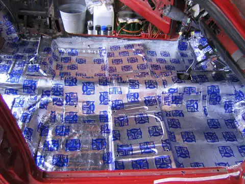

I forgot to tell you that I did use Fatmat, and you definitively can feel the difference. I bought 50 ft which where enough for the floor, firewall, kickpanels, and quarter panels. Here is a pic from the installation:
