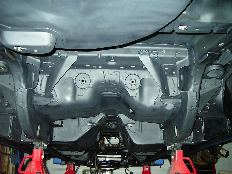

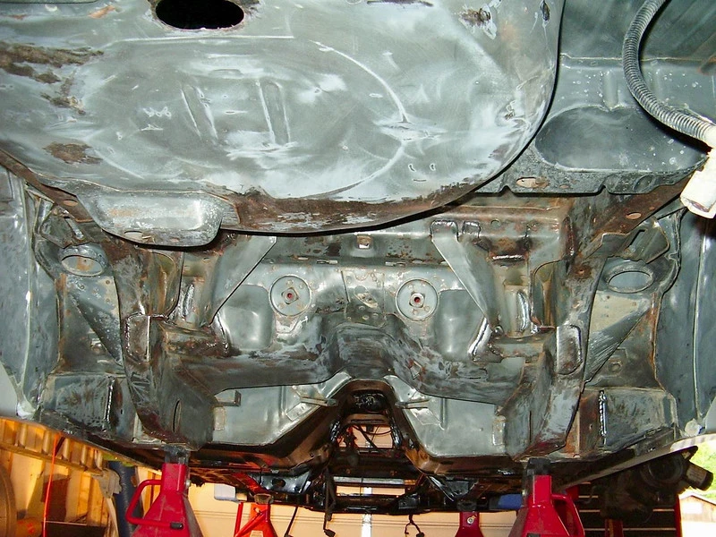

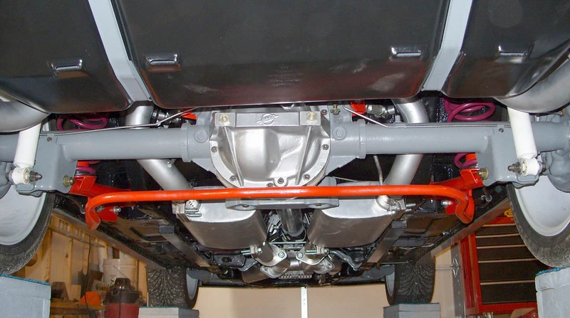

I used Chassis Saver Black. Took the whole underside and engine compartment down to bare metal, two coats of Chassis Saver, two coats of black primer, then two coats of semi-gloss black paint.
Went from this:
To this:
To THIS:

I use Chassis Saver too and it's been real good to me. My 2 cents.
Went from this:
To this:
To THIS:
DID 1 GALLON COVER THE WHOLE UNDERNEATH AND UNDERHOOD AREAS? OR DO I NEED MORE?

That came out awesome Capri Debris, really nice.
