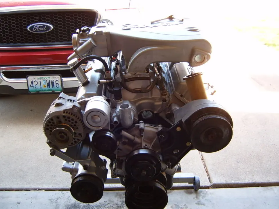

I got my kit today. And it didnt come with instructions... Does anyone have them that they can upload!?!

Thanx! Ya I searched there and got those too. But I dont understand those instructions.. Do I have to take apart my PS pump?
Does anyone have a good close up pics of theres installed?

yeah sorry bro. i just looked at the instructions i posted. what a sh.tty set of instructions lol. it doesnt tell you jack. i wouldnt think you would have to take your ps pump off its bracket like it shows.

No you don't have to take it off the bracket, Its quite simple really. The holes line up with the 3 on the front of the head, and thats what the 3 short bolts are used for to hold that bracket on. Then the 2 long bolts are used to hold the ps bracket. The black bracket is like a support and bridges over to the water pump bolts for extra support. If no one posts a picture by tomorrow ill get one for ya

as mentioned above, the cast bracket bolts to the head and only can fit one way, the black stampint is a support off the wp.
as for a 351, i dont see how. the back bracket sure, but the support in the front would need to be a different size to make up for the increased deck.
