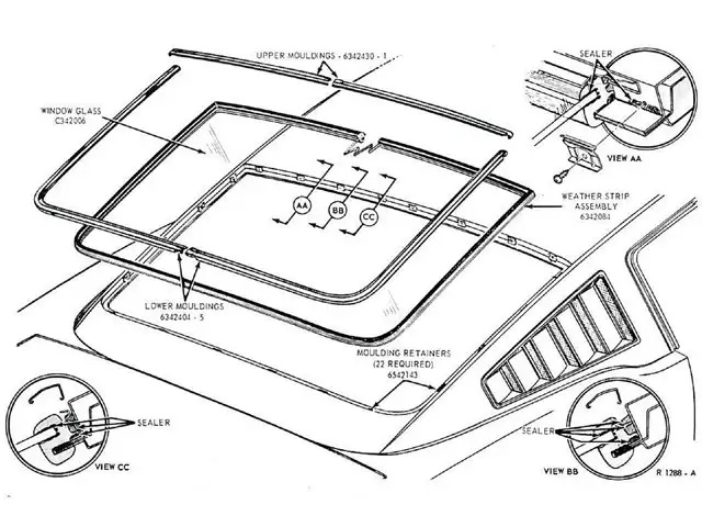

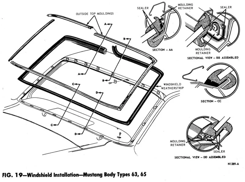

You have to use the seals. Easy if you know how to do them. Use 1/8" cord the pull it in, and nearly two tubes of Glass Bedding Compound to seal each glass.

2+2GT--offhand do you know the Part # of the glass bedding (3M?) for the rubber seals shown?
Don't want to order in the wrong stuff.
2+2GT
Apr 25, 2009
3,333
10
79
Southeastern Pennsylvania
Nov 29, 2010
  • Nov 29, 2010
3M Glass Bedding Compound. Glazier/Nolan has it, their number G22007. You can probably find it locally, though.

Just did my first glass install on my 67, TOO easy, just a little messy, but like they said, nearly 2 tubes of sealant, you can probably buy 3 and get both glasses in if you don't waste too much. Just have a friend, some 1/4 nylon rope, and some soapy water in a spray bottle, pops right in. Be prepared to get messy, as much as i tried to be careful I got it all over the glass, but the razor blade took care of that.

Im talking 2 big calk gun tubes. Took one and a half for my front glass. I ran a bead inside the gasket before I put it around the glass, then installed the glass, then a thick bead of it around the outside of the gasket between the body and windshield. Almost filled up the whole gap there. This is what is recommended if you DONT put sealant under the gasket between it and the body, but that takes a special sealant gun that usually only a windshield shop will have.

No, we mean the big 10oz tubes. I use about 1 1/2 - 2 tubes per glass.
I once re-installed the front and rear glass in a 66 coupe, had been done twice by supposedly professional glass shops. They got there while I was snapping the last of the mouldings on, and watched me clean the excess sealer off, mostly my fingerprints, from the glass and mouldings. When I started to walk away, the woman asked if I was "going to take it outside and test it with a hose". I said, "no, because it doesn't leak."

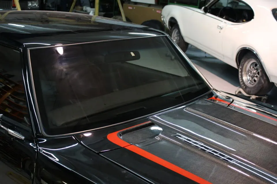

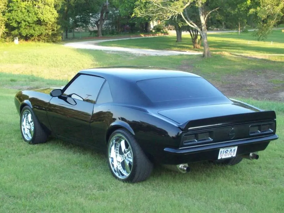

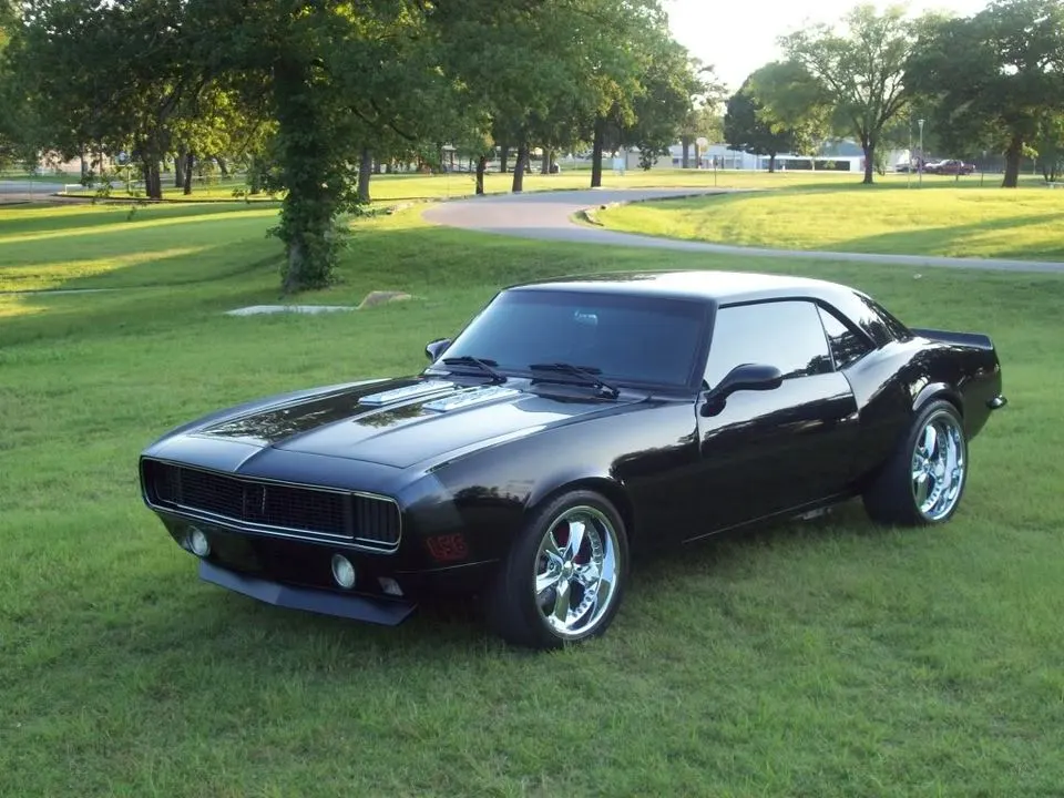

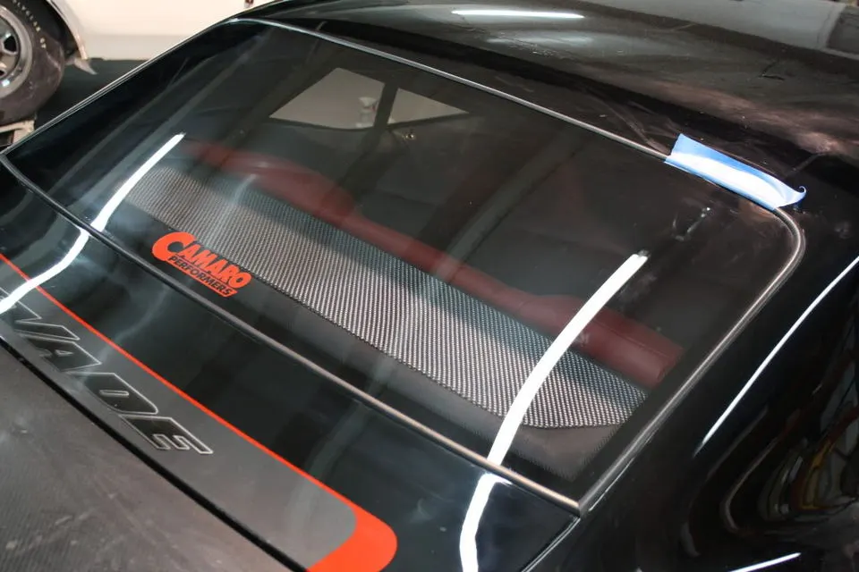

We actually have a Flush Mount Glass kit coming out for the 64-70 Mustang fastbacks and coupes.. Hopefully they will be coming out in the late spring and we are currently taking names for a waiting list.. Below are some pictures of our 1st gen Camaro kits, the Mustang kits will have similar style..
With these kits, there are NO Body Mods, so they will fit in completed cars and are completely reversible at anytime. Please feel free to contact me off of my website at anytime for questions.. We have some very notable builds that we are sponsoring, so there will be plenty of coverage coming up..
The weatherstrip is completely optional on the rear glass, these glass kits put the actual windshield and rear glass at sheetmetal height.. The rear glass comes in smoked options along with clear, and also comes with a nice rounded edge that allows it to be installed with out weatherstrip. The windshields come with an intergrated antenna built in the tint band, so it is complete hidden from sight, and will allow the elimination of the fender mast antenna...
