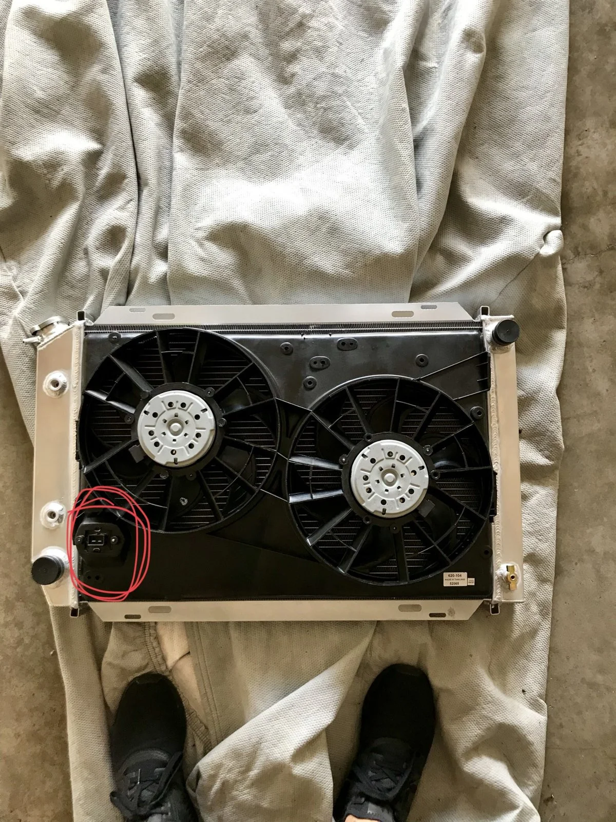

As far as the fans go. Trim tabs like you mentioned. I ran small small diameter black hose that I cut open around the perimeter of the fan shroud to help seal it to the radiator. To attach the fans I used a very unpopular method, radiator zip ties! They work just fine for me. I'll get you some pic's in a moment if I can find some on my work computer.
Awe man a little crack on the weekends never hurt nobody!! I always do that my mind kinda runs in several directions. Probably why my brake swap to so long bc i started doing 3 different areas at once. Any ways so you just split the tubing down the middle and let it cover the edges to insulate and cushin it kind of like how the black Magic’s extreme has that on theirs. Wonder if I can find something like that at HD? If radiator ties are frowned on then what else could one use
I imagine HD sells tubing, I got mine from the auto parts store and saw some at Ace Hardware also.

Hmm yeah gonna have to look more into it. I tried to look what black magic uses on their extreme fan but I wonder if something like this would work?

Do I need to do anything with the circled red area or with my new fan controller will bypass that? I saw a video on YouTube and the guy took that out and dremeled it bigger for whatever reason

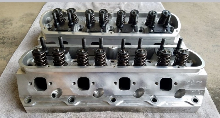

Picked these guys up, along with some TF 1.6 rockers and some pushrods. Now to decide on my cam. Should I leave my F cam or swap to the trick flow stage 1 or 2. A guy I’ve been talking to states that the B cam is a much better fit for these heads. What’s your all opinion on that? What would you do!!!

Who's the guy you were talking to that said a B cam would be a good match to these beautiful heads? What is the intended use of your car? Street, strip, track?
Streeter on the weekends here and there, car shows, probably no strip or track days.

lol b cam come on now
That’s what I thought, now I know custom is the the way to go. For now though I’m gonna get everything on my block and see what I can do with it, I am looking to pick up a new dart 302 SHP from a guy near me here in Austin with two of them new in boxes which he wants 1850 for to build a new heart, stroke it and then go custom grind. Just trying to see my F cam will be ok and leave it, or if switching to one of the trick flows like a mentioned would be better fit.
I don't think it'll be worth switching from the F cam to the TFS. I'd get a custom cam. It sounds like you're building quiet the quality engine so why cheap on the cam and lose HP?

My comments were mainly aimed toward the built Dart engine. If you're going to slap these heads on right now since it's not that much more effort then I say run your F cam and enjoy it that way until you reach your next phase of your build. The F cam is a decent forced induction cam due to longer duration and minimal valve overlap but seems out of place in such a high dollar quality build you're planning. It'll be right at home in my stock 302 and would allow my twin screw to breath a little better on the exhaust side of things :D
