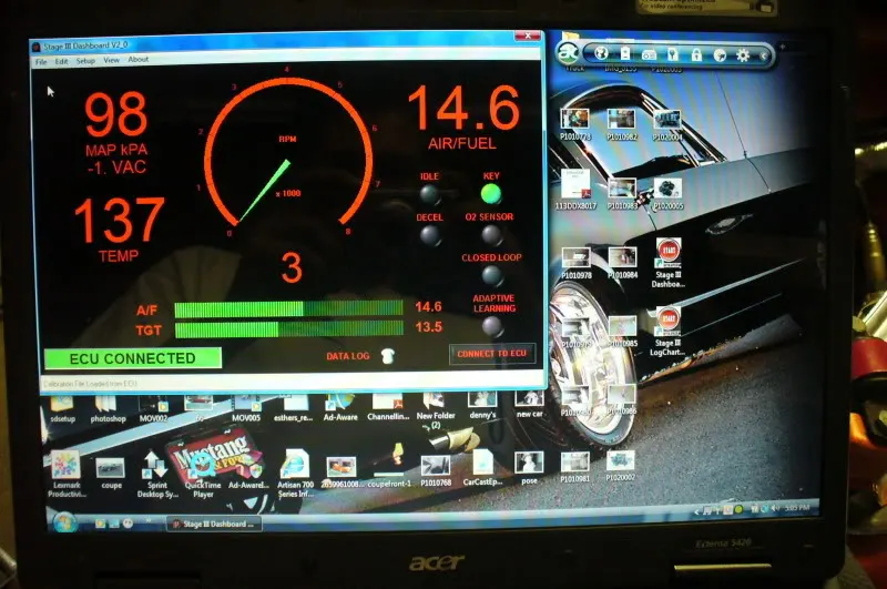

I have a few more things to do like move some wiring and re-route the return line.I also need a bonnet stud since the t/b has a smaller thread hole.I havent driven it yet, but its WAY more responsive so far.I hope is was worth the house payment.If this dont work my jet boat will run awesome

I can say that Cody, the tech guy there is more then helpful.I took it around the block (no tags on car)and its very smooth, then the boost comes in and were skatin. I can tell the more I drove it, the more it was learning and fiiling in the cells on the fuel map.I need to do adjustments for the turbo fuel map, but it looks like its going to be easy to make changes.Dont belive the "afternoon install", it took me a few days and few beers to finish it. Most of it being chasing down fittings and hose and a 2 year old tugging at my pants.But it really is a 3 wire hook up and replacing the carb(and return line).

I have been driving the car a few miles after work. The driveability is great, but its still learining the fuel map. Under boost the a/f is staying at about 11.7-11.9, while cruise is about 13.5. The car feels totally different and the power is now unusable.Before, the boost would come on strong and pull,now its just blowing the tires off whenever the boost comes on.Cold start is nothing more then cycling the key a few time(to get more fuel to prime) and then it starts and idles at about 950 without feathering the pedal like i used to.With my laptop in the car i can see the fule changing as i drive and also see that my "expensive" Autometer guage is off by about 20* so the car has been at about 170-180*, barely going into closed loop.

The car is running great.Have a idle issue when coming to a stop, but i really havent had time to mess with it since I dont drive it that often.But it runs great,starts easy and is now very dependable regardless of the weather. The only down side, it really calmed down my cam
My manifold has 2 ports for the water temp.My Autometer still reads about 18-20* higher then the laptop shows and I have verified this with a temp gun.Only thing i can think of is tapping the intake or having a bung welded for another sender.
