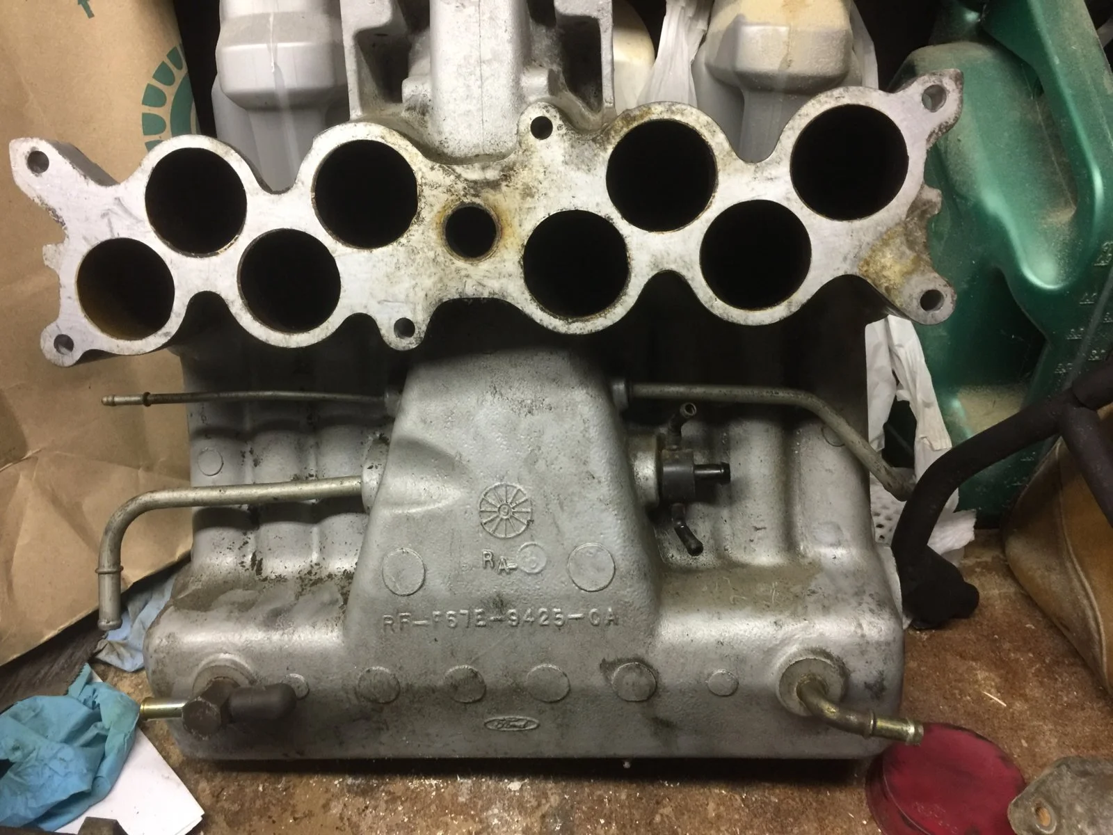

I picked up a GT40 upper and lower intake, and was wondering what the black 3 piece fitting is used for(mid right of intake)? Also how to run the rest of my tubing? Thanks

3 port fitting is vacuum in center, and coolant on the sides. Pull the fittings and drill tap and set up like below

Thanks for all the info! I appreciate it. Are there any pictures on how the hoses should be set up on my upper intake? Do I need to tap in those brass barbed fittings or can I use what’s there? Are the 2 little coolant tubes that branch from the vacuum tube suppose to be used or are they capped?
Vacuum is the same throughout the intake manifold. The only thing that isn't supposed to share a vacuum line is the fuel pressure regulator; it gets its own private vacuum line.
