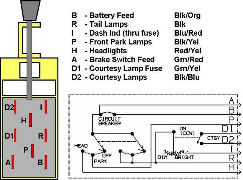

Get a 12V probe test light and check for voltage going through the light switch.
If good, check at the dimmer foot switch. Here is a diagram to help you get started on the headlights:

I had a ground on the harness (drivers side front, in the plug cluster for the headlight/turn sig/marker lights) that just needed to be connected. Fixed the whole issue.

thanks 68 converted. It was the ground wire on the new front harness that was not connected. Headlights actually work now! I still have the issue with the left brake light not working at all.
