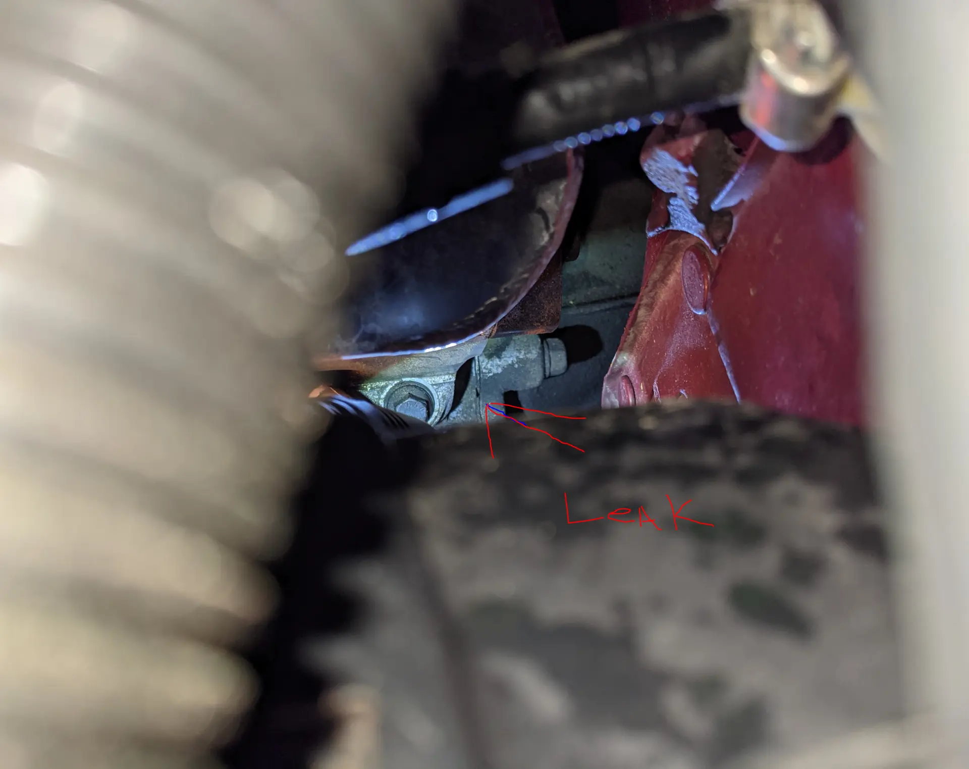

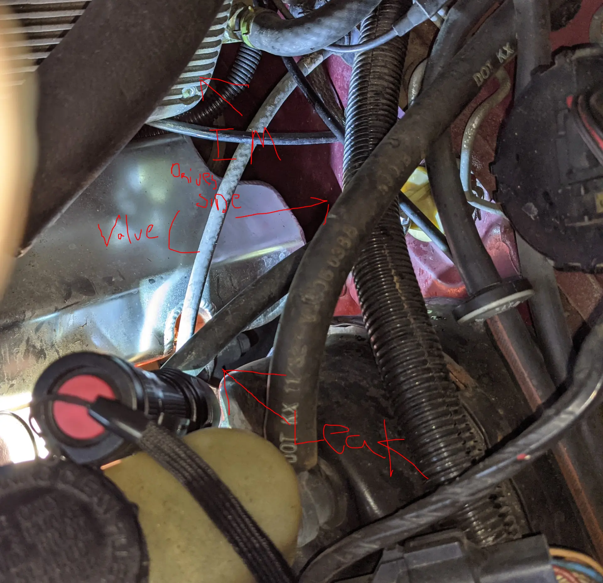

I have better pictures of the leak.

I checked the plugs the look good and no water coolant in the oil. I uploaded better pictures of the leak.

Check above at the back of intake , it might be running down to were you see it leaking. If not and it's coming from the head then you know what.

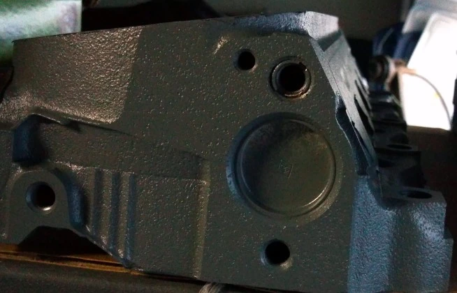

Could it be the freeze plug on the back of the head?

AFR 165 don't have freeze plugs...I don't think. The lower back corners of the lower intake could leak coolant past the gasket. There are freeze plugs under the headers on both sides of the block. There's also on in the back of the engine between the engine and transmission. The lower head bolts go into coolant ports. If one of those loosened up it could leak coolant.
Keep us posted.
