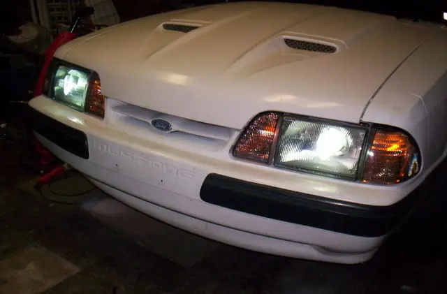

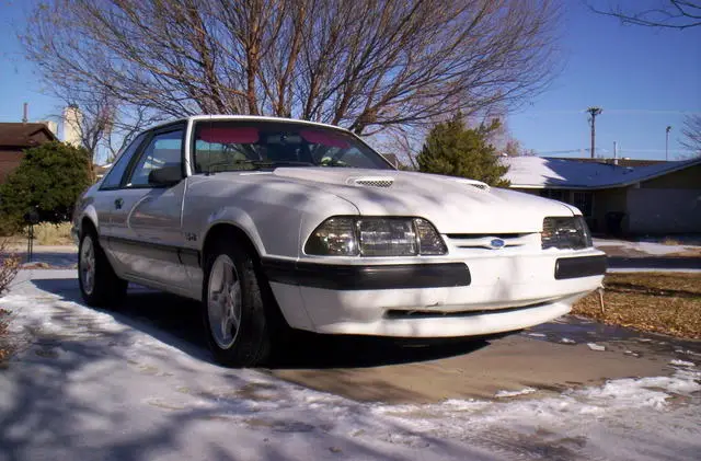

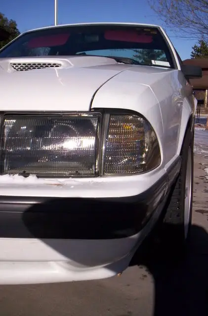

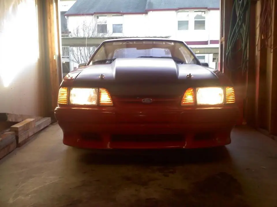

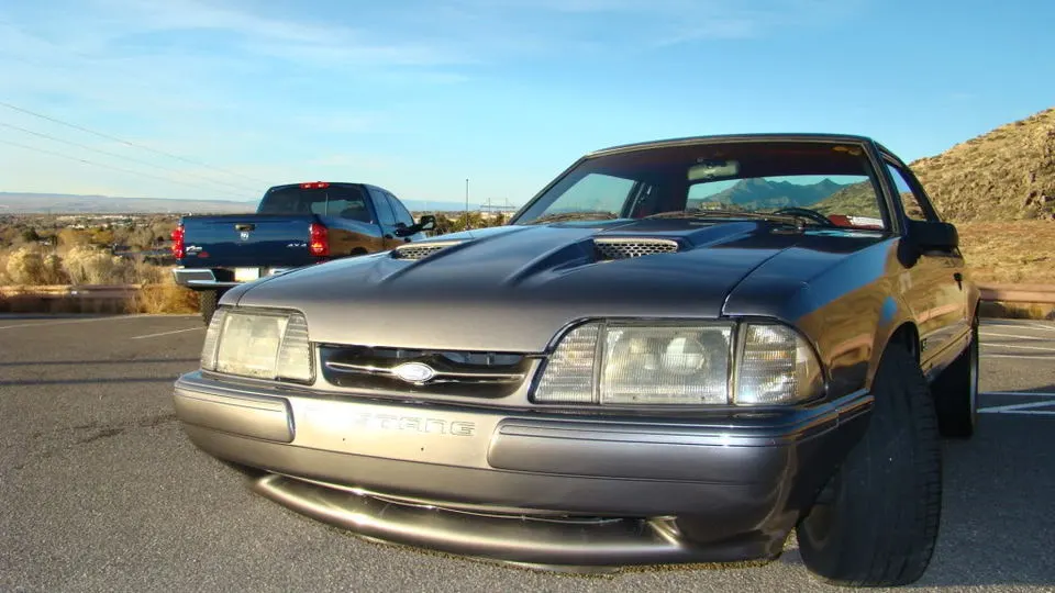

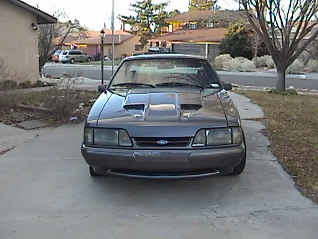

Got my HID's in today they are 55watt.WAY better then stock headlights!
Stock on HIGH beams:
And my 55W HID's on LOW beams:
They draw less power when warming up and when all the way warmed up then the stock HIGH beams!I would of got down lower but they are to bright to look at dead on and also would distort out the pic!peace

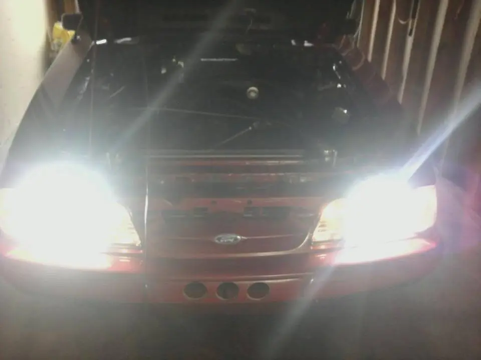

Make sure they are aimed at the road....nothing worse than driving towards some dude with HID's pointed in your face. Lookin good tho

wow that is a huge difference. easy to install?

There are lots of plug and play kits. Just make sure you don't get a cheapo kit. I have them in my Explorer, night and day difference when driving

hid retro-fit the right way.

You're going to blind people.

Damn, that's a lot of glare.

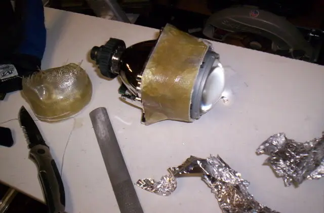

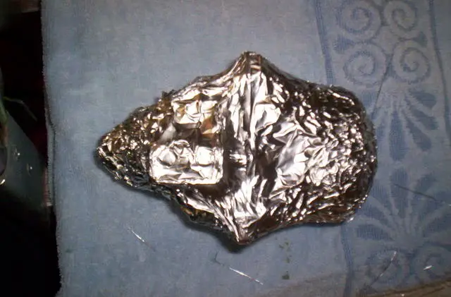

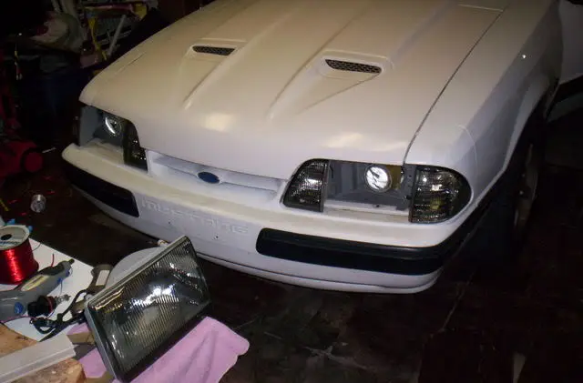

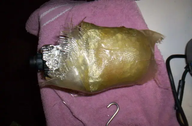

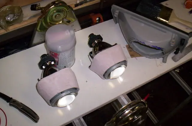

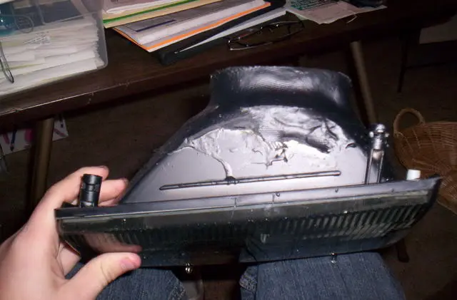

If you have the bulbs/ballasts... All you need is the projectors and either a shroud or make your own shrouds to seal the beam in... i made my own, wrapped the projectors in aluminum foil, then wrapped in fiberglass, bondo'ed smooth and painted them black to blend in.
Then it's a matter of cutting the rear of the headlight housing to fit and align the projector. Attaching the projector to the housing and that's really about it.
I figure for less than 200 you could finish up the HID retrofit... between 100-150 for the projectors and around 35 for the shrouds... then the cost of fiberglass and spray paint and bondo... it's not too bad.
The projector would have a better cut-off line if the headlights were not fluted. but it gets the job done.

So you custom fitted your's to your headlights?Do you have a pic of the back of them of the finished product? looks good and i will do that soon.I talked to them today and they recommended the projector i should use.So i could buy that from them and then mold it into my housing,then use the stock adjustments too level them? peace
