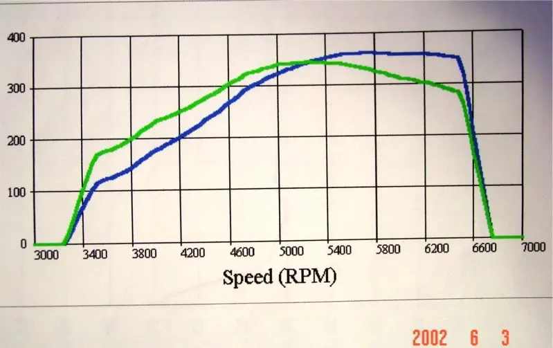

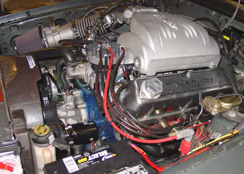

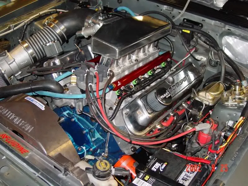

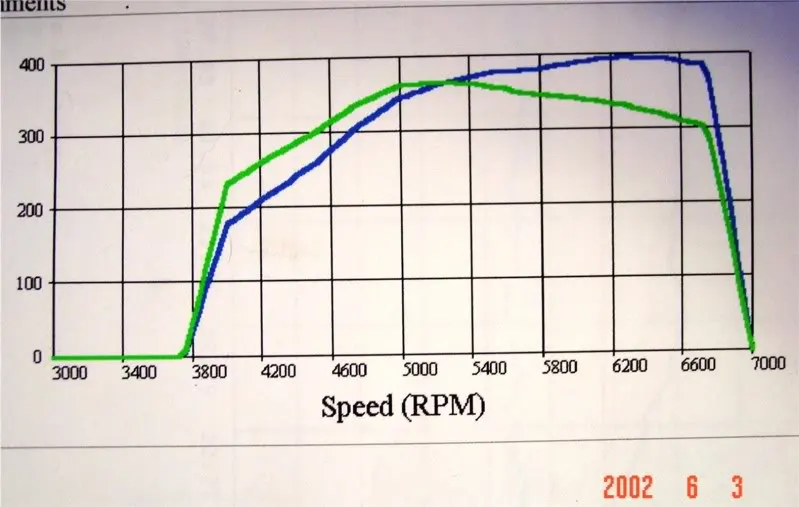

That should do the trick but, you just need the upper P/N TFS-515U1108...
Trick Flow Specialties TFS-515U1108 - Trick Flow® Box-R-Series Intake Manifold Upper Plenums
It's $399 and you should be able to sell you upper pretty easily, retune may be necessary. I used a Hogan upper here's the pics...
Before w/tfs
After w/hogan
TFS dyno
Hogan dyno, same dyno same day...

where did you get that hogan intake from?I want that but in black,and i need to see if it will work for a turbo? I dont want to waste anymore money like i already did. peace

depending on what the car will be used for should determine your intake. Based on gmsux's hp charts it looks like the trick flow would be mo betta on the street. Anything will work with a turbo, man hahah. The reason the hogan makes more hp is because it has shorter runners. You will prob run quicker at the track with the hogan na and with turbo but I doubt it's cheap and you have to draw the line somewhere. Hell, have your heads worked also if you have the cash.....

Hogan's are expensive, I got a deal on mine at about $600 for the upper. I'd definately go with the TFS box upper for $399, much better $/HP ratio. It should accomplish the same thing being box upper/short runner.
The hogan was much better on the street as well, look at the charts carefully, it gained everywhere. A 351 does not suffer from torque! It needs short runners, look at the difference in RPM for the HP peak!!
Of course, I also ran a custom flat tappet cam to maximise the low CR and there ar other reasons too that I can get into later why the flat tappet is better in the 351W IMO.

Also, I need to add that notice in those photos, I was still running the stock type MAF setup, I later switched to an SDS programmable speed density system and gained another 40rwhp driving the car into the 10.70's with 9.3:1 cr and the flat tappet cam.
