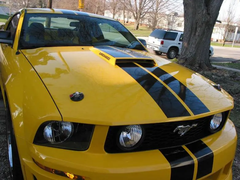

Hood flutter seems to be fairly common at high speed. I had it around 80 or so and worse the faster I went. I think the squareness of the front traps air and it can't escape quickly enough. Anyway, a nice set of hoodpins will solve the problem. Increased safety and good looks as well. It's a win+win.... Mine are from RingBrothers, pricey but very well engineered and they look just awesome. Most of the others I looked at mounted too far inboard for my tastes.

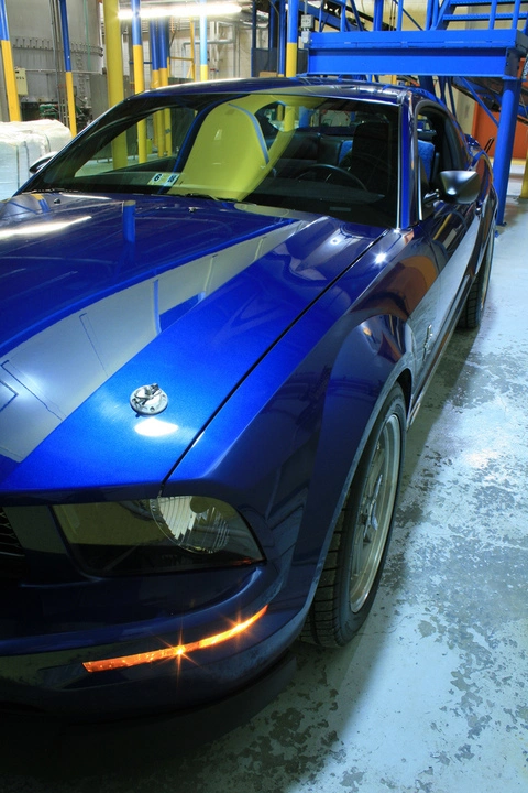

Picked up a set of Scott Drake (same as Shelby but without the name) hood pins yesterday and will be installing them over the next week. Note that the lanyards can be taken off by removing then reinstalling the safety ring - no need for cutting. I'll be leaving the lanyards off. Will try to take some pics etc during the install.

klaw said:
Picked up a set of Scott Drake (same as Shelby but without the name).
Same ones I got, but they are not positioned exactly right and the pins are "off" which is noticeable. They don't have the same angle as the scuff plates. I mounted them in nearly (if not the same) location ScreamingRoush did as I also don't like the closer to center location. After cutting the holes, during the test fitting of the pins, I rotated the scuff plates/studs in many directions and this was the best looking one.
They're in and work...besides...mine isn't a show car
This is the worst one.
