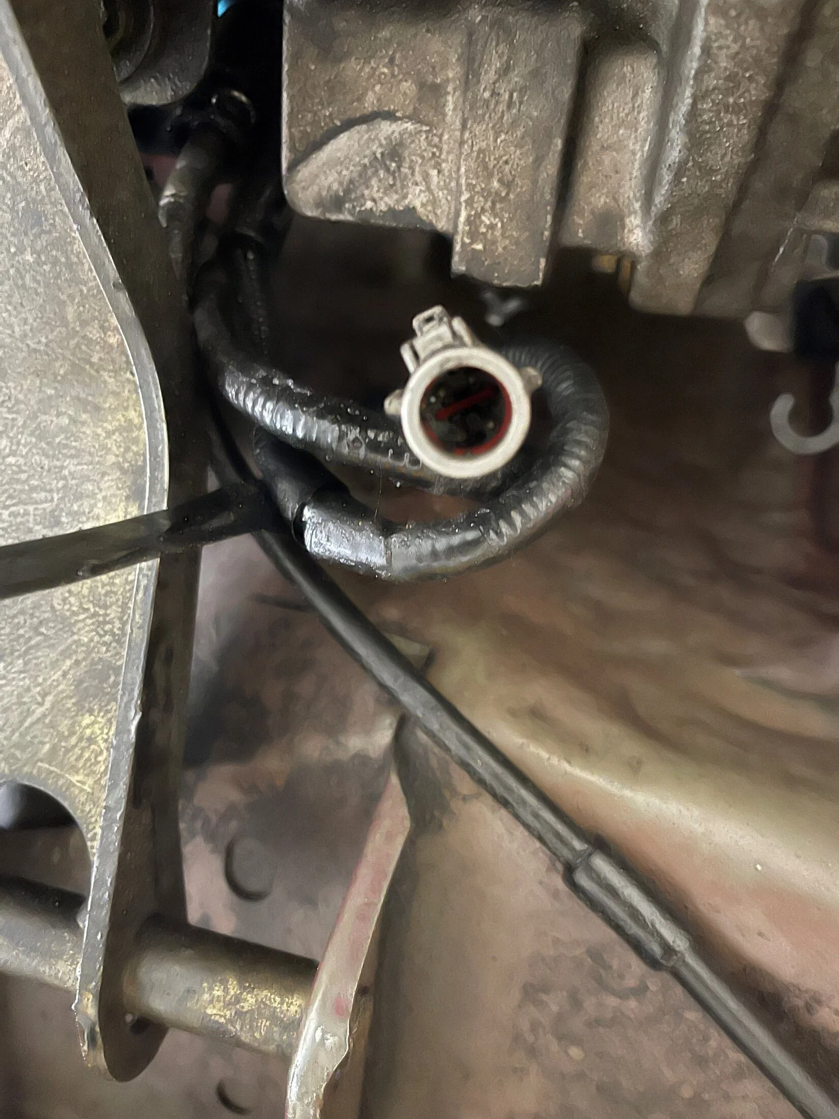

Ok, Ive been doing some checking. It's not the NSS, I dont think. Its the reverse light harness, based on the photo of this plug and whats on LMR's site.
But, why does that keep the car from starting?! This was the plug that had the connecter wedged in it. The NSS is on the tailshaft housing and I have that, and its plugged in.
The NsS is on the reverse light harness. It’s that red/blue jumper wire as the manual cars use a clutch safety and not an NSS.
So you do need that jumper intact.
Ar you confusing it with the NGS on top of the trans, because that does something different.
Ah, ok. I ordered the harness for the reverse lights, pictured above. I should have it in a couple of days.
