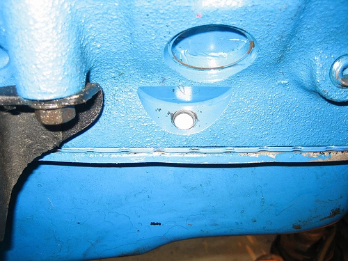

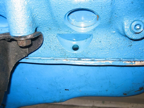

Here's how I did it...
I found a tiny freeze plug and drilled my block exactly that size. I drilled about halfway down the oil hole (not all the way through!) so as to make sort of a ledge that the plug could bottom out on.
Then I wiggled the drill around in the hole to make the hole sort of hourglass shaped.
Next, I flipped the freezeplug around backwards and using a punch, I hammered it in until it bottomed out on the ledge. A few more taps on the plug and it widened out. I tried hitting it from the other side and it wouldn't budge - it was in there good. I put a dab of RTV on either side of it just to be sure.
No leaks! (Not from there at least )
Wes
Before
After​
