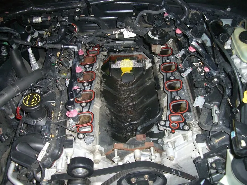

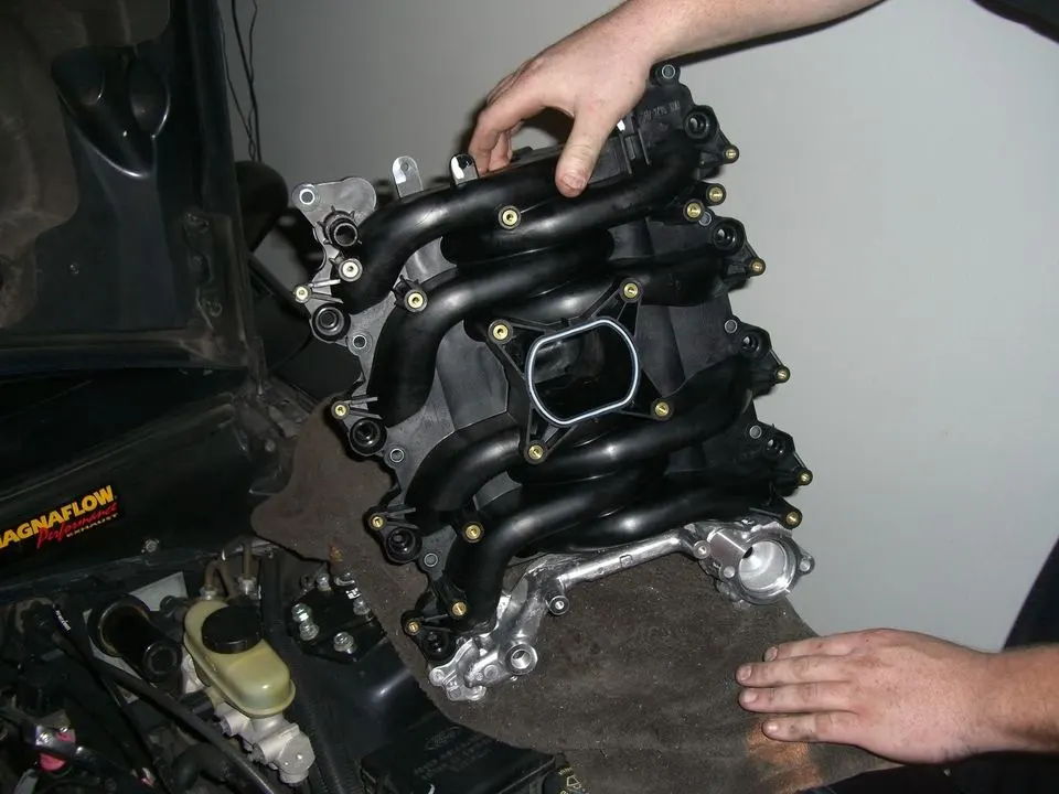

Hey guys, just filling ya'll in i replaced my manifold. Thanks RedDaemon for the write up. Only p.i.t.a. was the fuel regulator, everything else came as i went. Was my first major fix besides doing my suspension upgrade. Anyways, heres some pics. And i didnt get a typhoon intake, (what i really wanted) i had to get the car up and going a.s.a.p.
the new manifold.

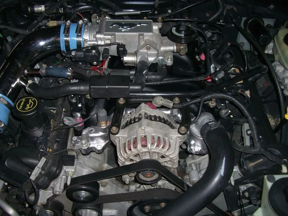

and the results. Notice how i accidently put the serpentine belt over the idler pully, and not below, however, once going over everyone again, checking plugs, wires, blah blah blah, i looked at the little map for the belt, and caught this...and all i can say is THANK GOD, that would have sucked .
