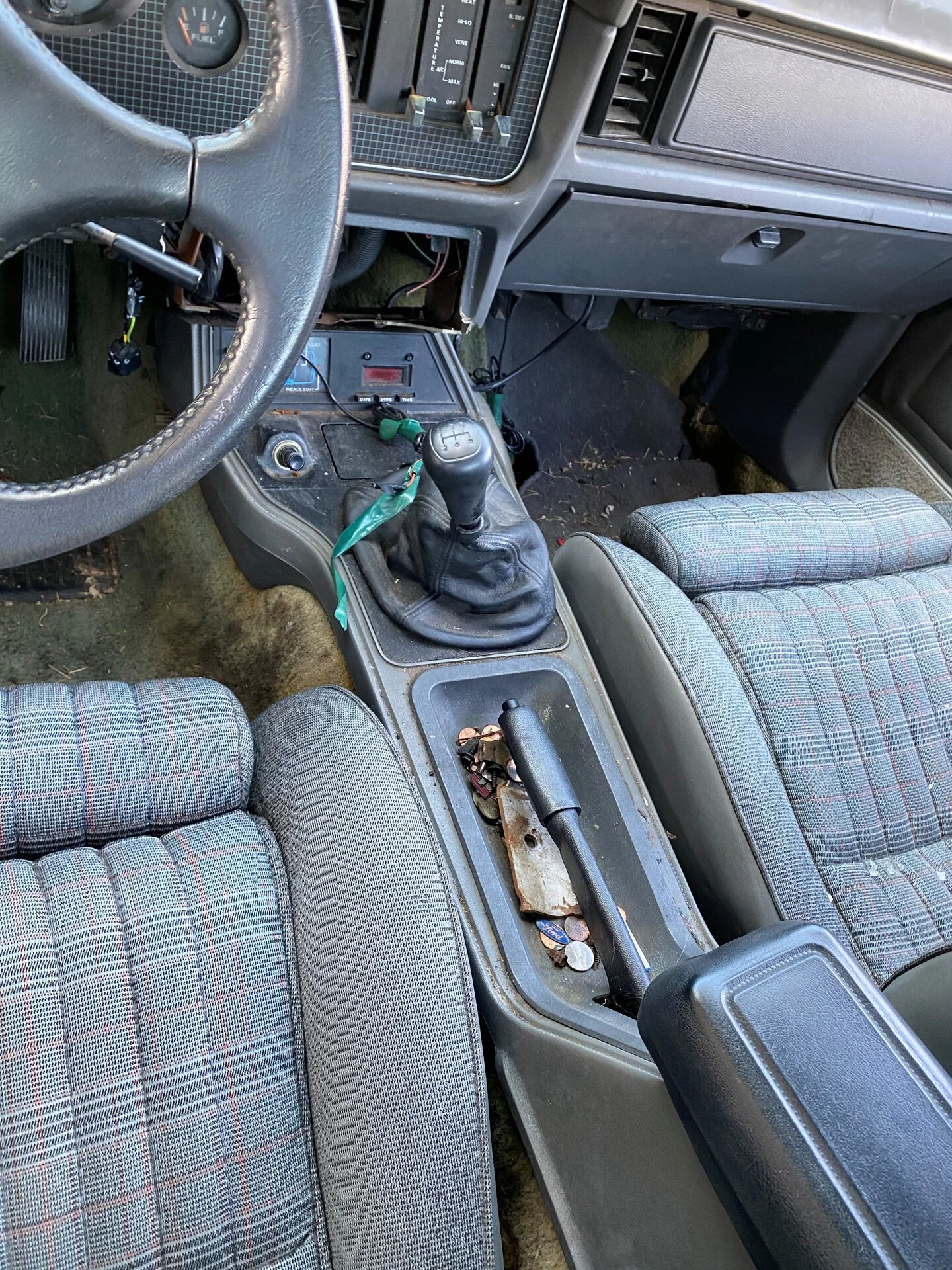

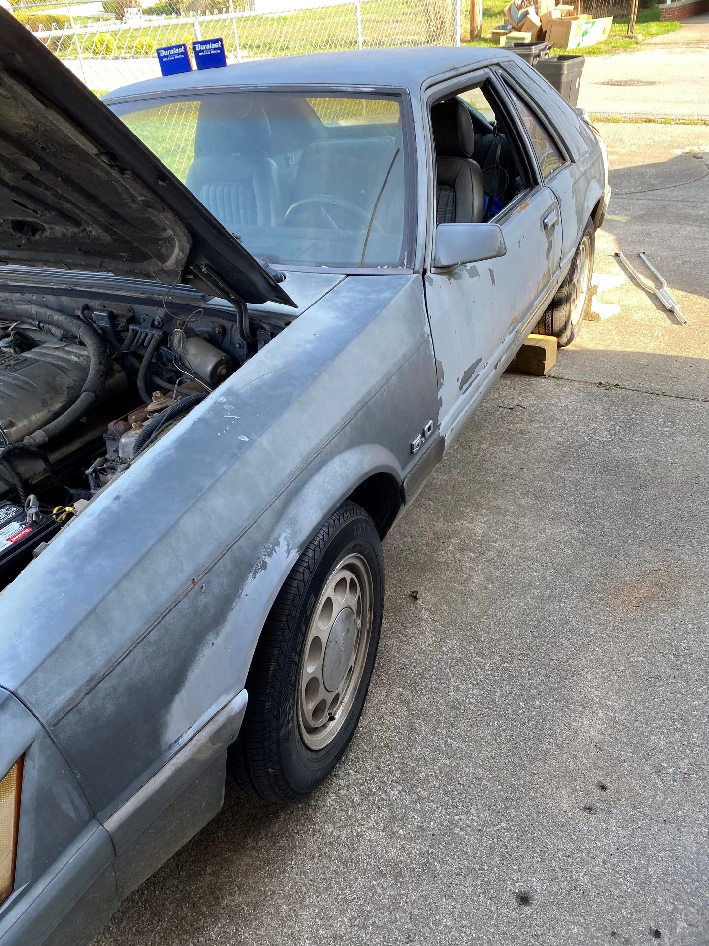

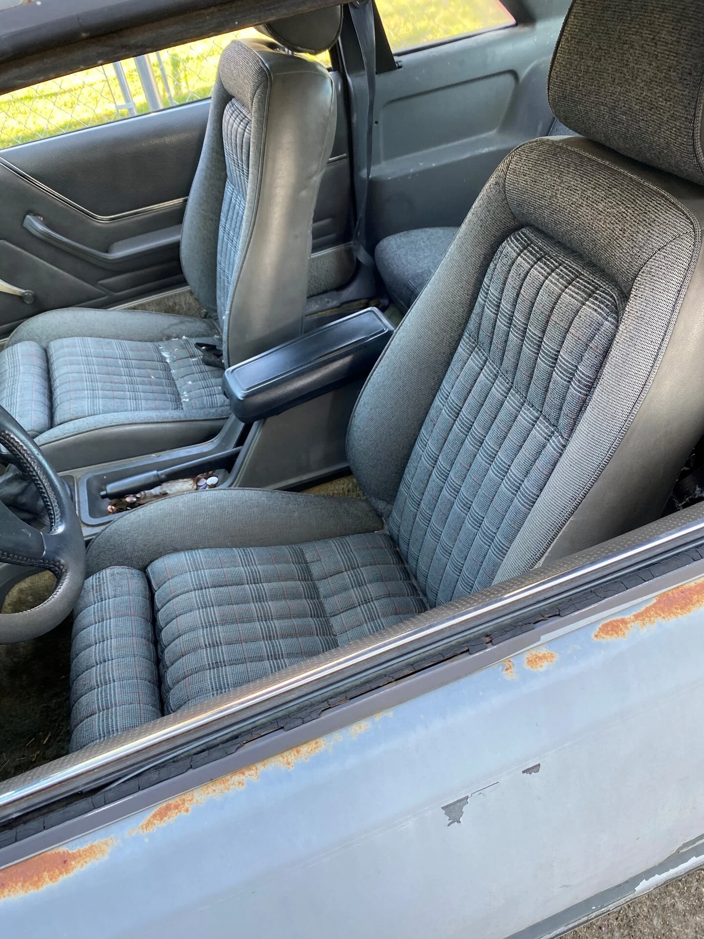

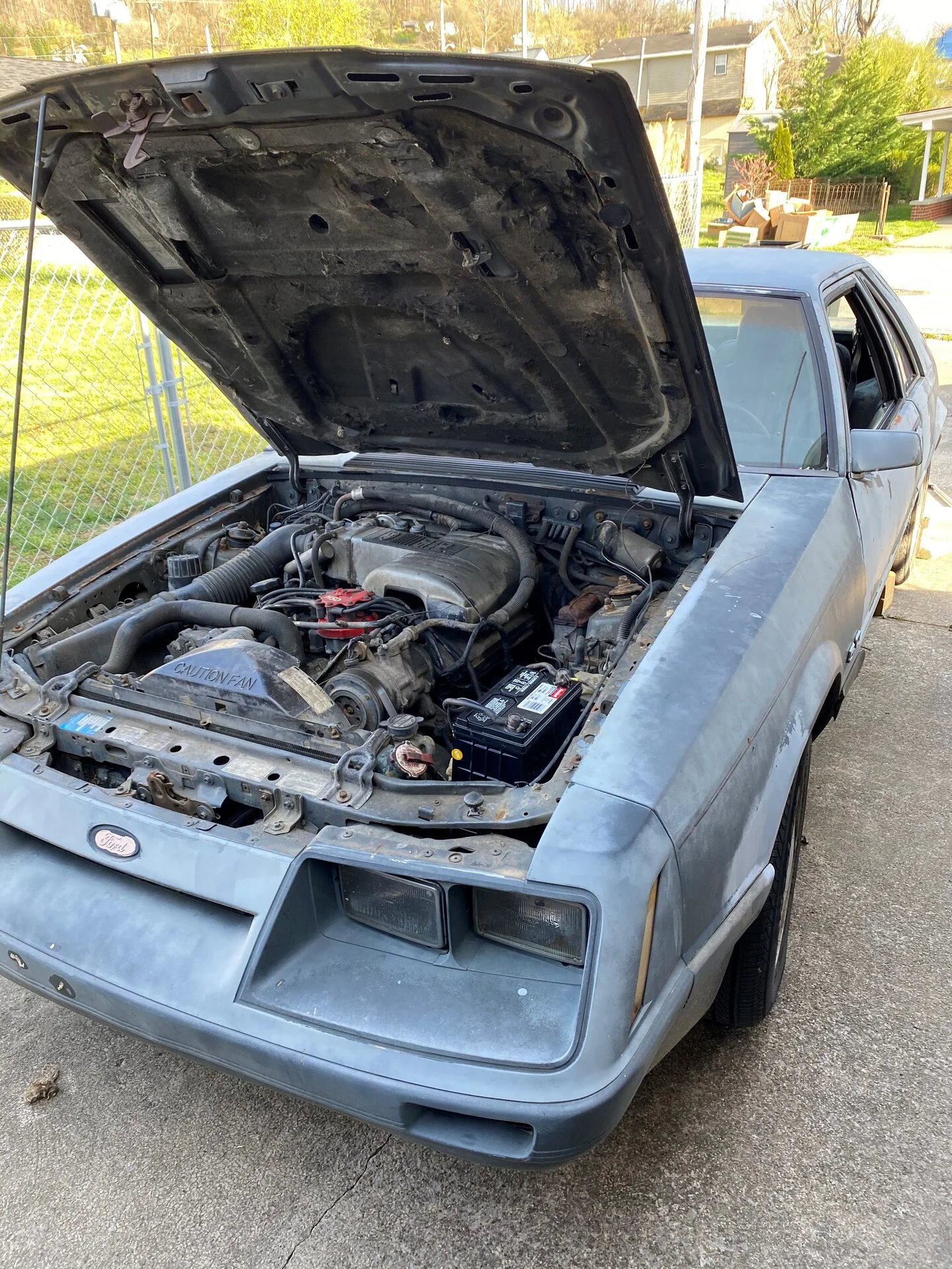

I attached a few pictures of it. It's rough and I have a long road ahead of me but it runs and drives great so that's a plus. Goal number one is just getting ahead of the body work primarily.

I have an ‘86 GT in silver, and it’s almost as rough-looking as yours!
A couple of observations:
- It appears to be a hatchback, while I think the SSP (police) cars were all notchbacks.
- The seats are not ‘86 seats
- I subscribe to a couple of Fox-body parts pages on Facebook, and periodically see nice dash units for the four-eye cars. You may want to check those out.

Since you have an 86 you need to worry about piston to valve clearance issues.
If i were you i would just consider the trick flow package and forget messing with random parts.
While i don't have an 86 many say the Twisted wedges clear.
Either that or you quite possibly will be rebuilding the entire engine.
I am NOT the authority on this issue, so do your research.

Looks like those front seat are from a newer car. Nice little project you have there!!
I have an original ‘86 5.0. I added the TW 170 heads to mine, and no issues with piston-to-valve clearance. I’m running an E303 cam with it and 1.6 roller rockers.
