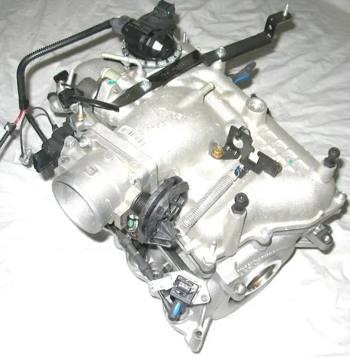

Found a Lincoln Intake Manifold
1stanger1 said:
thanks ...i am just having a really tough time finding an intake for my motor so i can stick the damn thing in already!!!
if anyone has one or know where theres one at i would appreciate some info...
its a 32v lincoln mark VIII motor
Check out this Ebay listing, it may be what you are looking for:
Ebay Item number: 280322040149

1999-2004 Aviator 4.6 DOHC Intake
This is a 1999-2004 Aviator 4.6 DOHC Intake Manifold. Should fit!

you say it will work but they say not......i have an early model dohc from a 93 lincoln mark VIII they say that that intake wont fit my heads

wont work for him, he has the older heads with two intake ports used on 96-98

you only choices for intake are as follows in order os power:
1. short runner cobra 96-98 intake
2. stock 96-98 cobra
3. stock 93-96 mark viii
4. stock 97-98 mark viii
my info has the last intake as practically useless. it looks cool, but hurts power with mis-matched ports and a last minute design.
im using it(97-98) for my turbo as a starting point, but i have 2 early models laying around.
