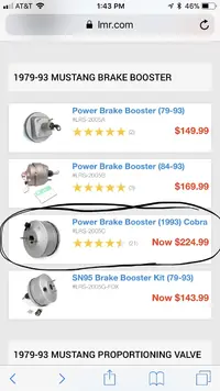

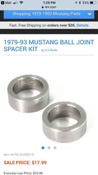

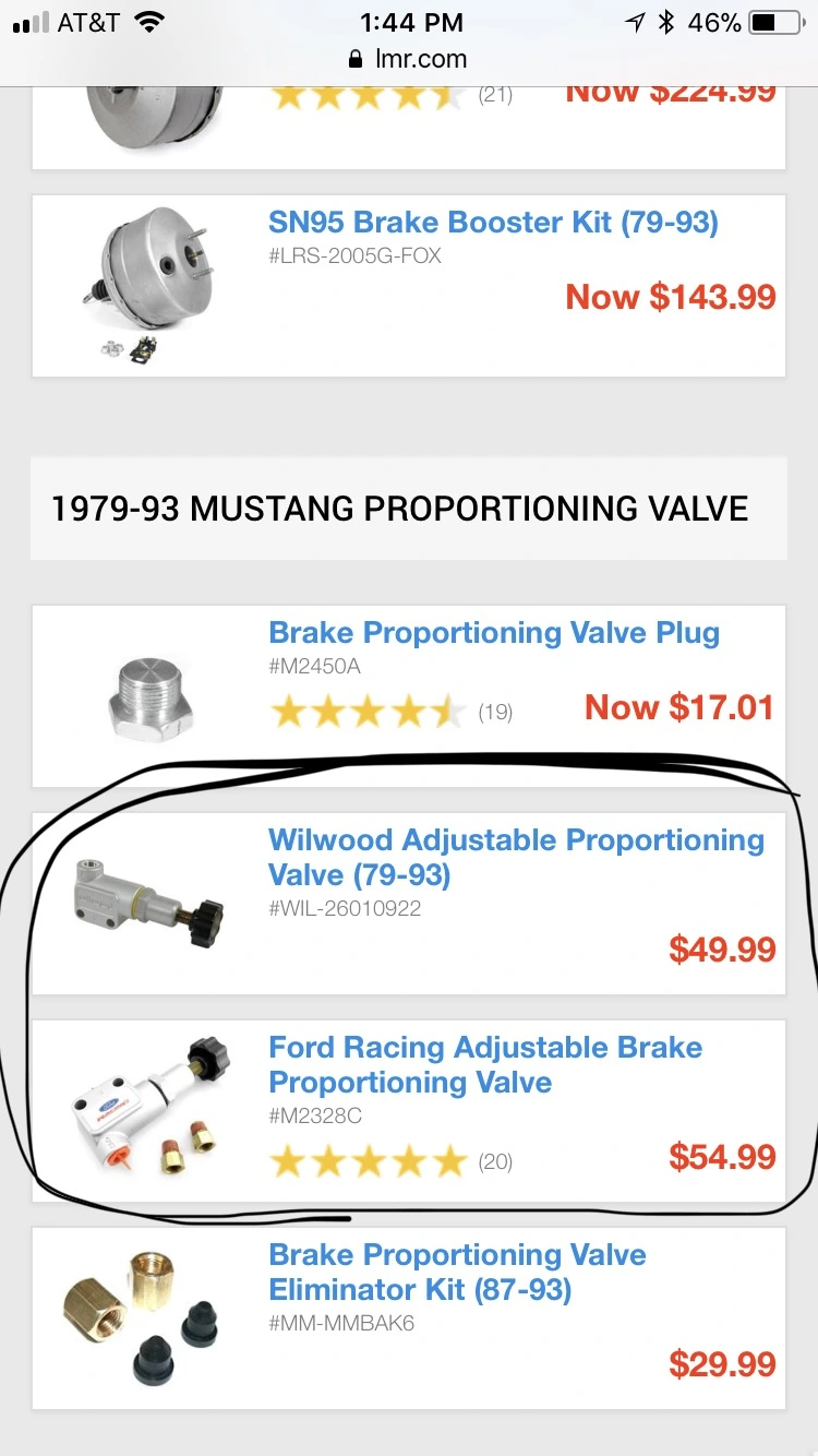

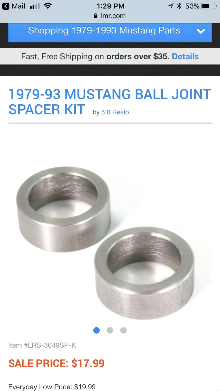

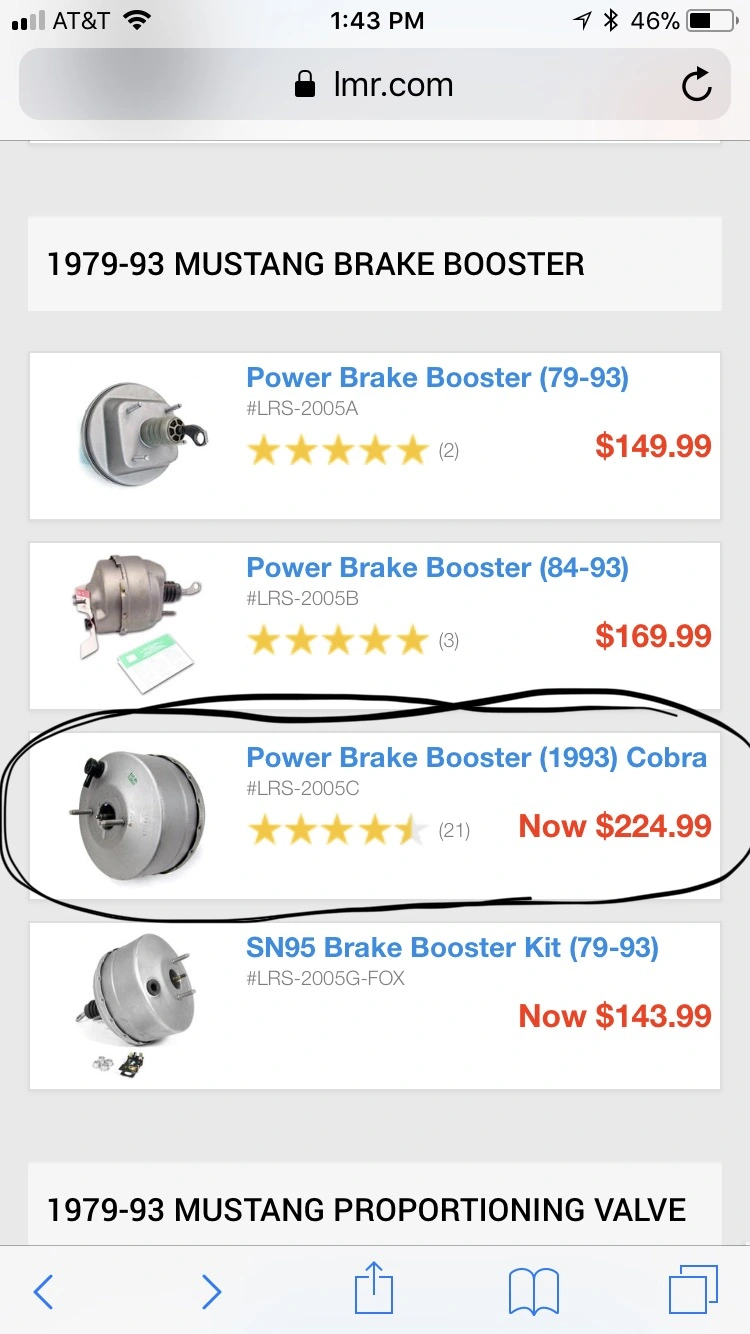

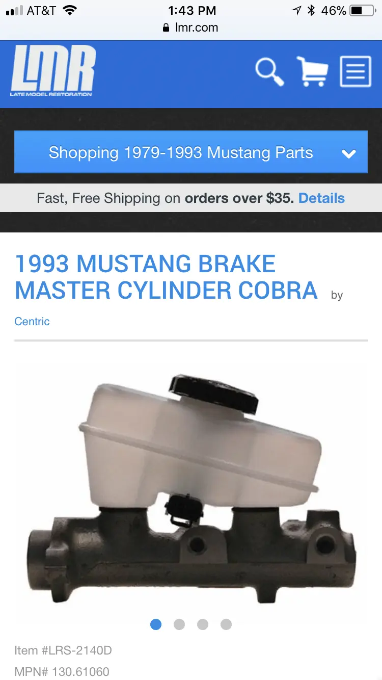

Ok guys so picked up these 94/95 SN95 spindles for 160 off Craig’s. They look pretty decent missing a couple lug nut bolts, but other wise that’s it unless there’s something you all see. What is the little gear tooth thing on one of them and do I need it or can it come off? So I know @Mustang5L5 kinda helped guide me a little, where would I find the passenger side brake line adapter, and a 3-2 conversion kit? Rotors and rear disc set up I will be getting from northracecars.com Going to grab these items, are the ball joint spacers the right ones? Also are either of these proportioning valves ok. Thanks any other input will be great, another task I will be trying to conquer on my own.
