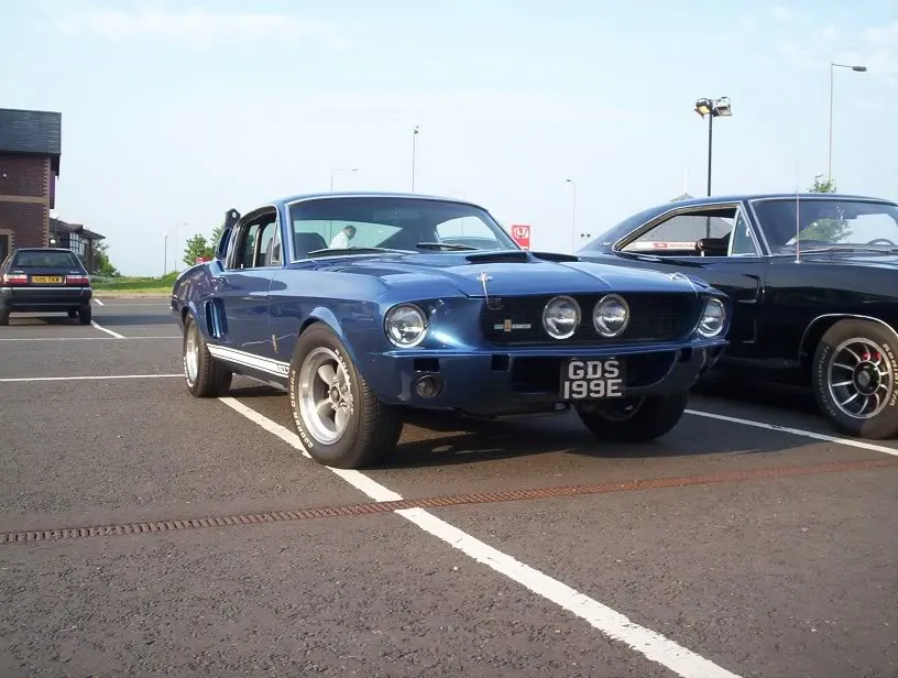

hello yes its a bargain over here in the u.k,the plus side on the mach1 is its clean and rustfree.The mechanics are easy i have been working on mustangs since was 15 and havnt stopped yet.My username on mustang forum in uk is GT350.Regards javed
