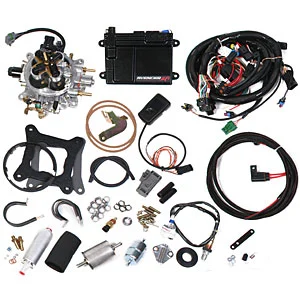

The simplest thing for you to do is to replace the carb w/one of a multitude of mfg's making an efi conversion for just that purpose. It will be throttle body, and will kinda look like a carb.
Witness Holley's Avenger series system. Literally plug and play, self tunes, and all you gotta do is replace the carb w/ the throttle body, wire in a few out side sensors, replace the fuel pump w/ the one supplied, and you're injected.
I had the older version of this on one of my 347's. It didn't self tune, and required a laptop to program. Once tuned, It started after one crank, and managed 415 HP N/A on the engine at the rear wheels w/ only a mild flat tappet cam, and some wusskin alum head.(I forget.)
The only thing easier for you to do in lieu of this is to fall off a log.
