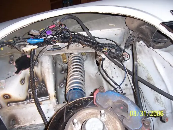

Most of the computers are the same just the A9L's are better curves in them and the 93 cobras are better also and are set up to run 24# injecters. I do think the auto trans computers are diffrent,and you caint use a standard trans ECM with an auto.Your no cranking issue could be this little hoodi ki it's the single little wire that goes between the 2 big post wires. I dont know what it's call but if you have a starter relay with 2 of those little posts and you dont put that wire on the correct one it wont respond when you hit the key. Most stock starter relays are a 1 prong hook up so you caint go wrong. The little prong usually have threads on it . Zoom in on this pic to see it better. peace

thanks for the pic. i checked out mine and its hooked up?
