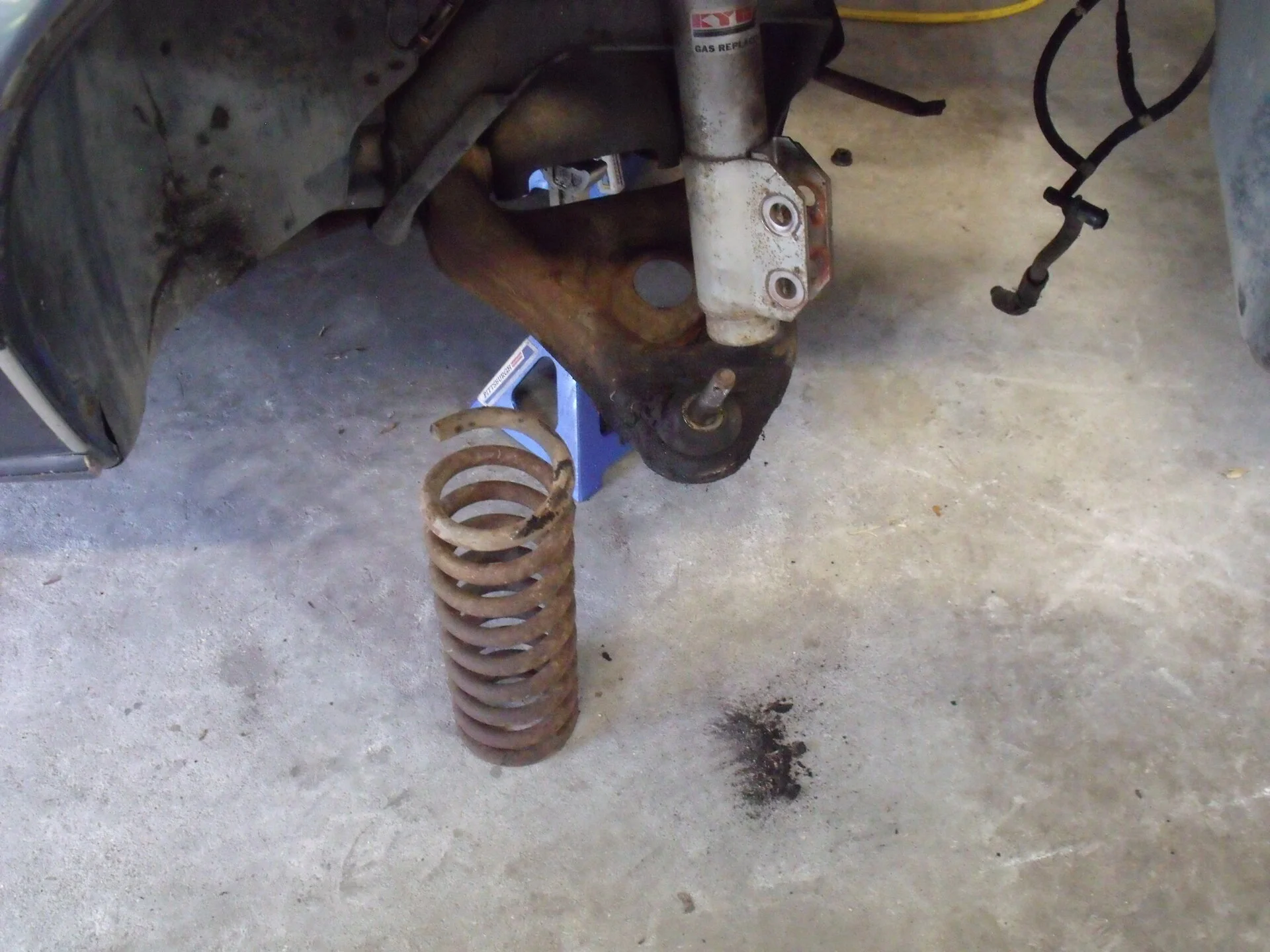

Are you putting the hack right under the balljoint? You should definitely see the shock/spring compress just a little bit
... Yes, under the ball joint...... Could the TRX springs in it be a bit stronger??
Anyway I pushed out the strut bolts and the car moved up about 1/2"..
Popped pretty good when I pried out the spring... I was glad the spindle was there to stop it...
One side done....

Just make sure you are clear when you pop it and I usually put stuff in the way when I do that. I’ve never had one shoot out
Its been many years ago, but I did a few of these before on other types of vehicles and I never had them as difficult to do... Seems as if after letting down the A arm, the spring would just fall out........ Maybe I am not 25 anymore??? LOL

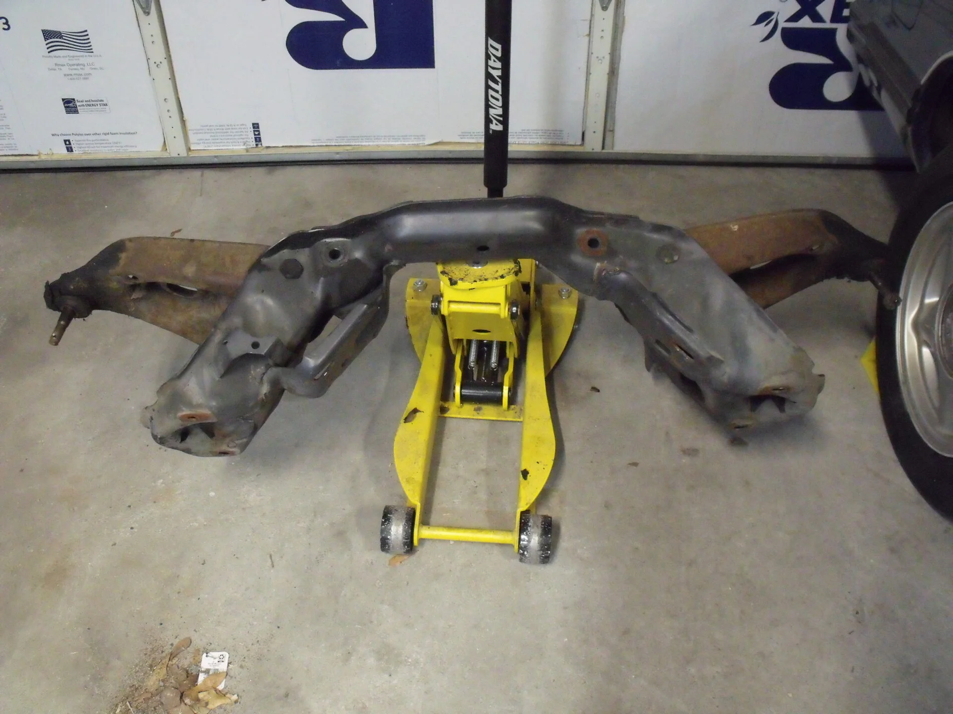

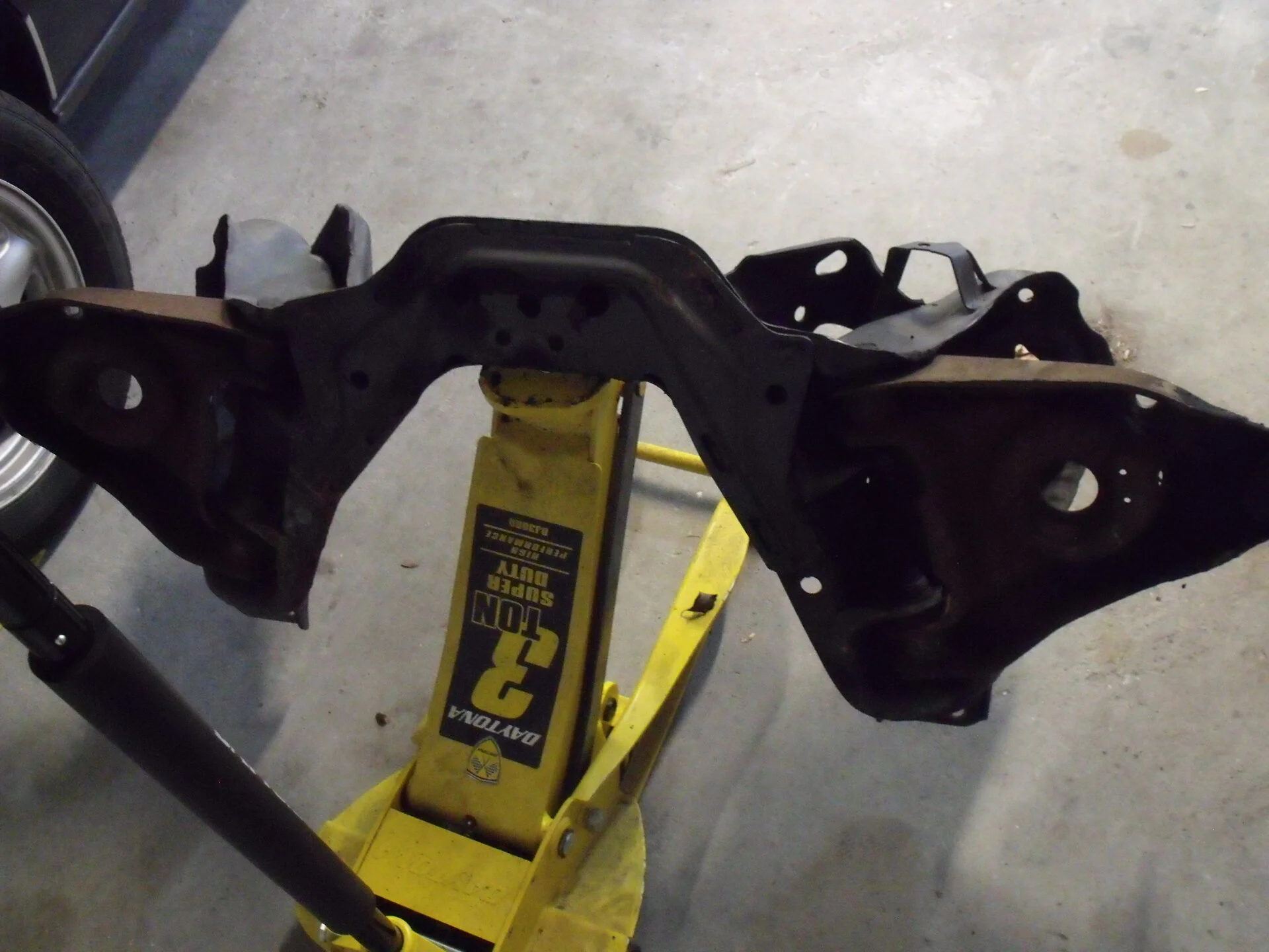

OK, I beat this bitch...... Thanks to everyone for the help and advice......
Gonna yard the engine back out and take out the K member......

Surprised myself how easy it was to slip the engine in and out...
I just set it on its mounts, and used a jack to raise and hold the end of the transmission. No nuts or bolts and no tranny crossmember to mess with...
