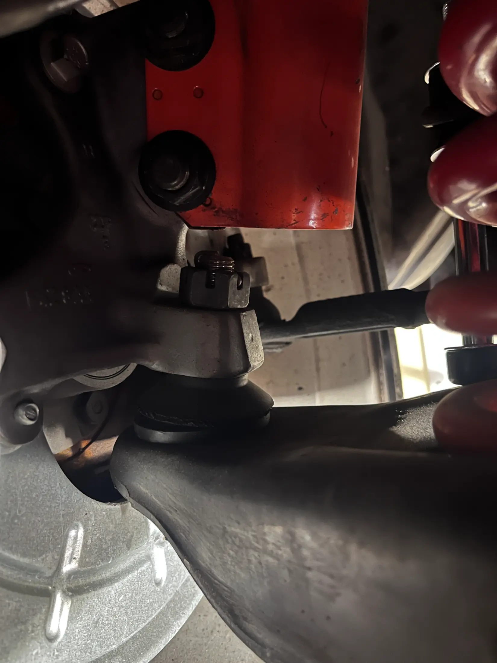

I checked my existing ball joints, they look to be the SN95 ones:
No spacers. I also jacked the car up and did the kaslcustom method (watched one of his videos)of using a long bar (jack handles) and put it under the tire and lifted up. Per him, if the ball joint is bad I should hear a clunk/knock when lifting and releasing tension on the bar. I didn’t hear anything, can’t shake the tire up/down or side to side. I may just add some grease for now and focus on other things.

Yup, those are indeed the SN95 type ball joints. You might want to just check and make sure the ball joints are torqued correctly. I would also check the strut bolts and lower control arm bolts to make sure they are tight.
Reactions: gkomo
Did I read that without the spacer the nut runs outta thread before they torque down?
Or was that a dream :O_o:
I believe what happens is the castle nut goes so far down that the cotter pin hole it too far above the nut for it to be of any use. Small safety concern I guess...
From my research, if you run a fox ball joint with 94+ spindles without a spacer the castle nut will hit the ball joint taper (end of threads) before being able to tighten down all the way.
The SN95 ball joint is shorter therefore the castle nut can torque down and line up with the cotter pin hole properly.

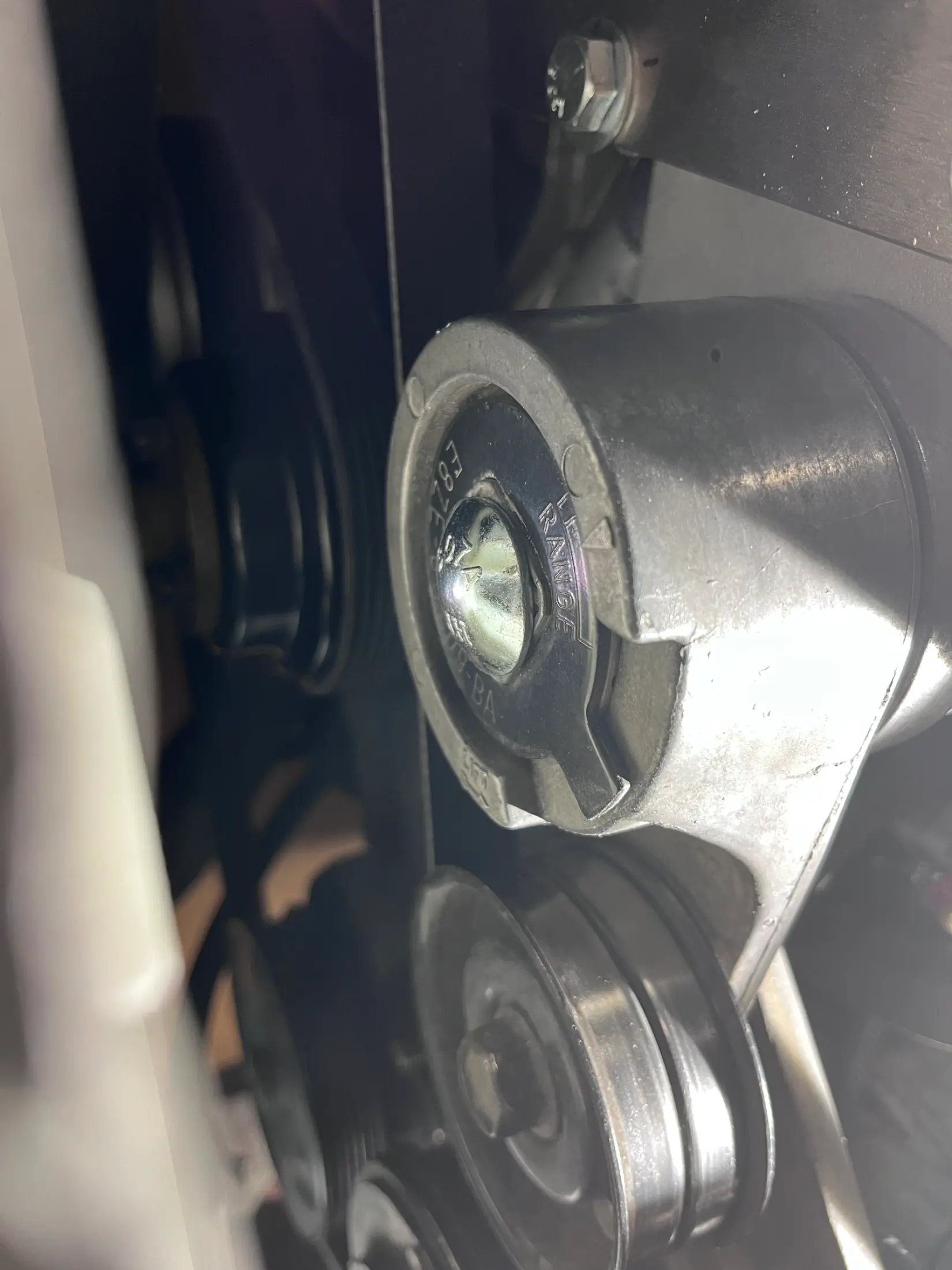

Super stoked, got my 90” belt on and the fitment is much better:
The 90.31” belt was at the opposite “looser” side of the range on “E”… my gut is telling me the old belt was just slightly too long and was slipping. Hopefully tomorrow I can fire her up and see if the 90” belt works.
