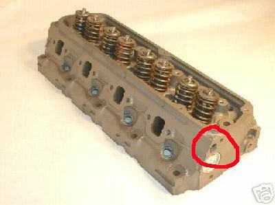

I mean it would take all of 30 seconds to stroll over to the car, pop the hood, look at cyl 1 on the pass side, look right at the corner of the head near the valve cover and see if there is an “S” or a “T” there.
that would be a start.
