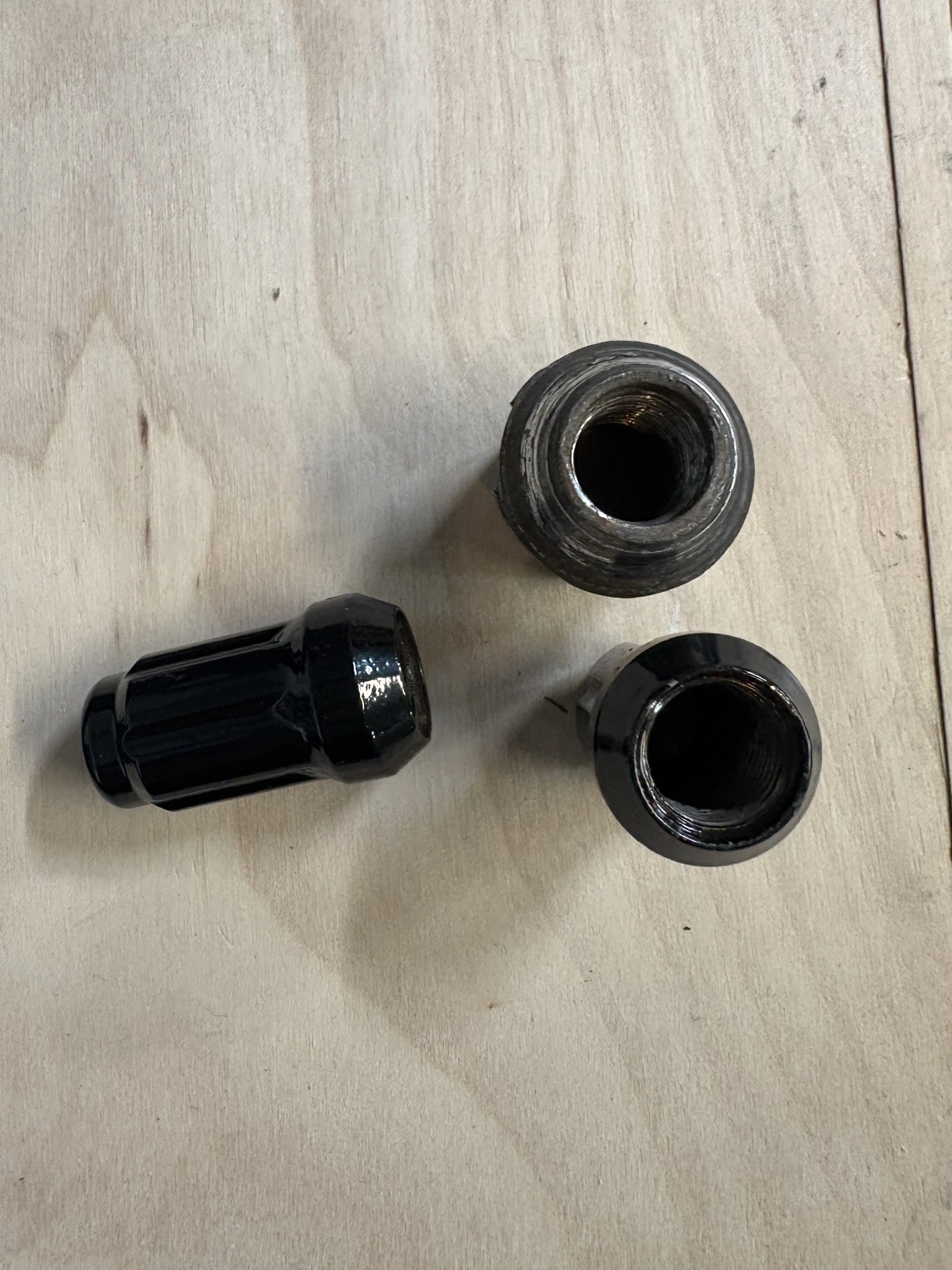

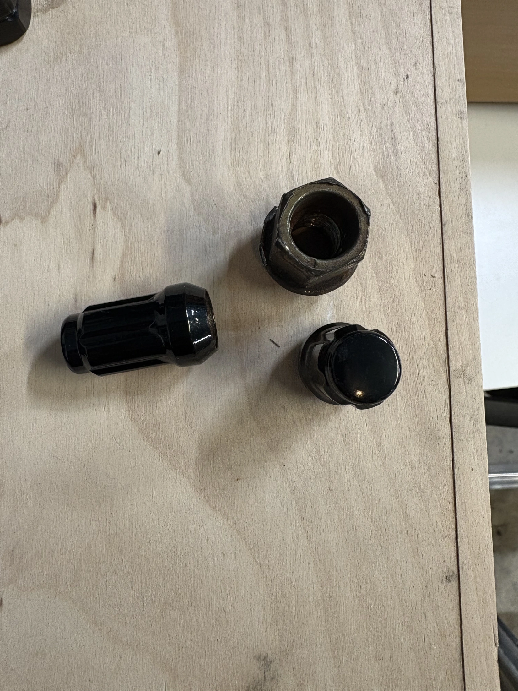

Idiot question here.
Bought some new acorns from Napa because of discovered a couple lugs nuts were missing and rounded when replacing pads and calipers. They look nice but look much smaller. Will these replace these safely?

The old are not the original lug nuts. Depending on what wheels you have the originals were either acorn style conical seat or open style conical seat.
The Napa ones will likely be find provided the threads do not bottom out inside the lug. Shouldn’t with stock studs but with anything aftermarket you’ll want to check.
