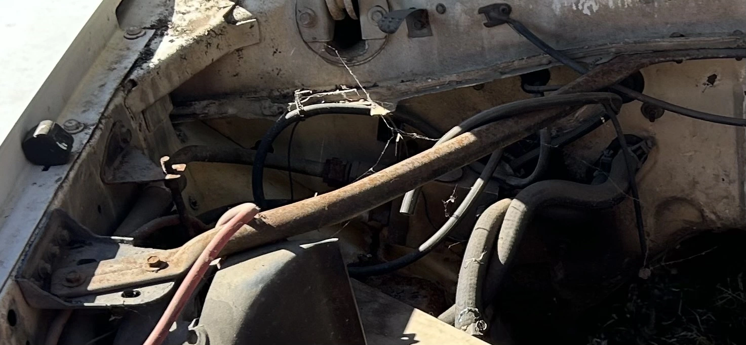

My 78 t-top II is missing the drivers side brace that goes between the left fender and the firewall. I have seen them called export braces or t-top braces but I haven’t been able find one that looks like the one I have. I’m assuming it’s original.
Anyone have any idea where I can get one?
Here is the one on the passenger side.

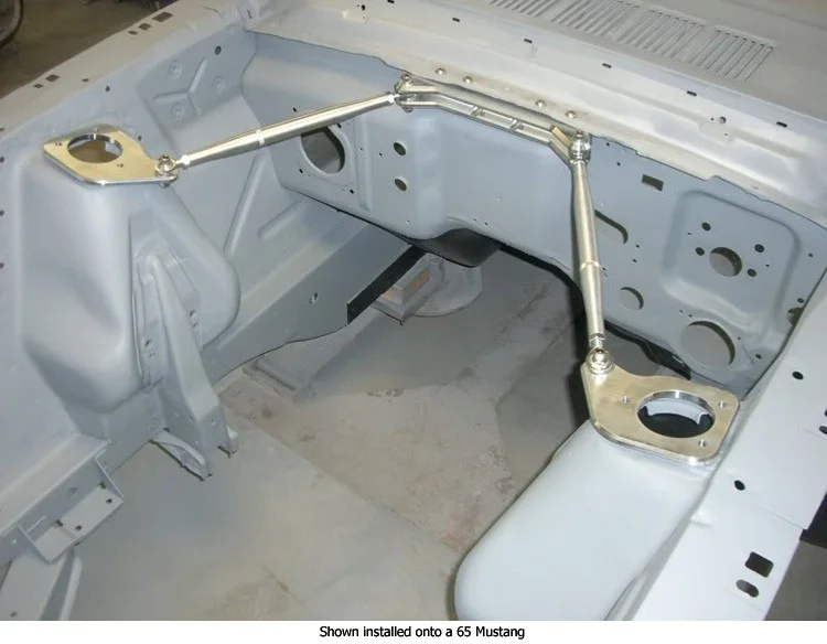

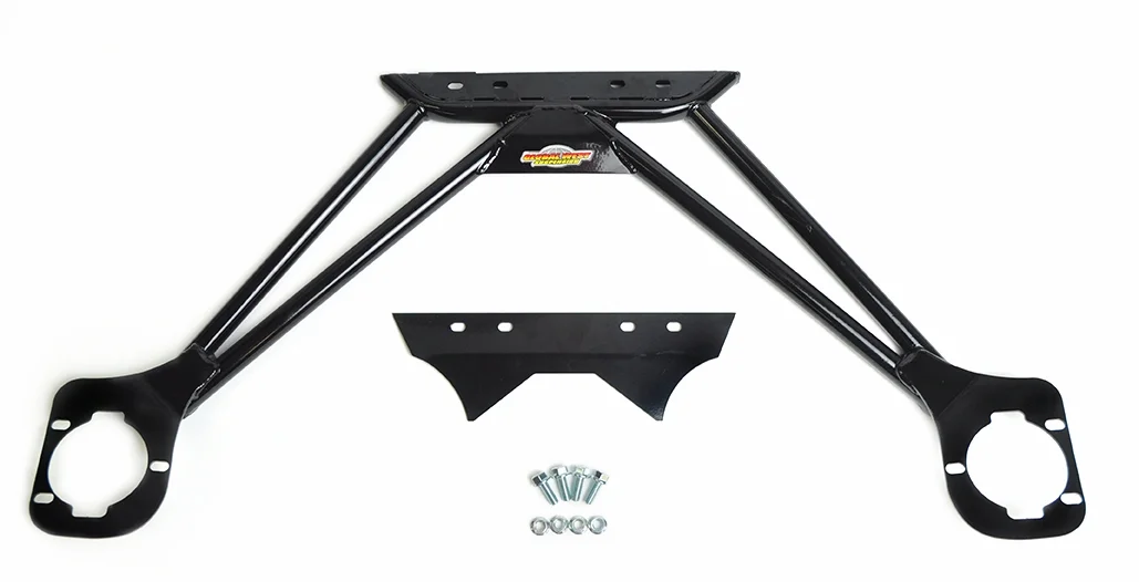

I would love to see your result. Export brace it is called on the 1gen stangs.
The same thing is on my todo/wish-list... but will not happen soon (as most things).
Perhaps this pictures inspire you for your solution (they are all 1gen stang)
