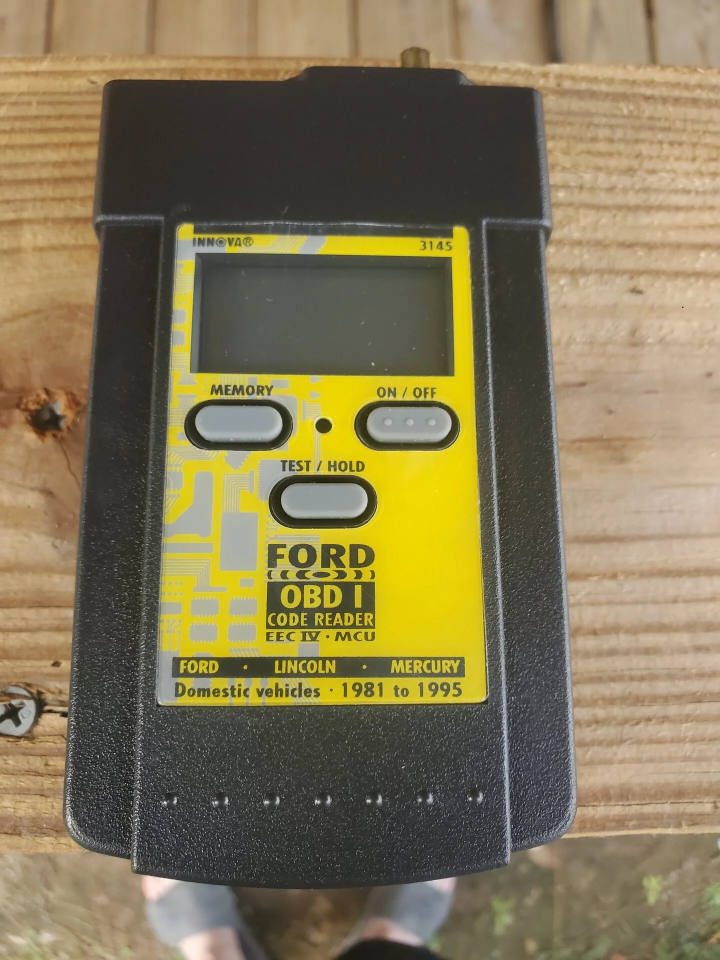

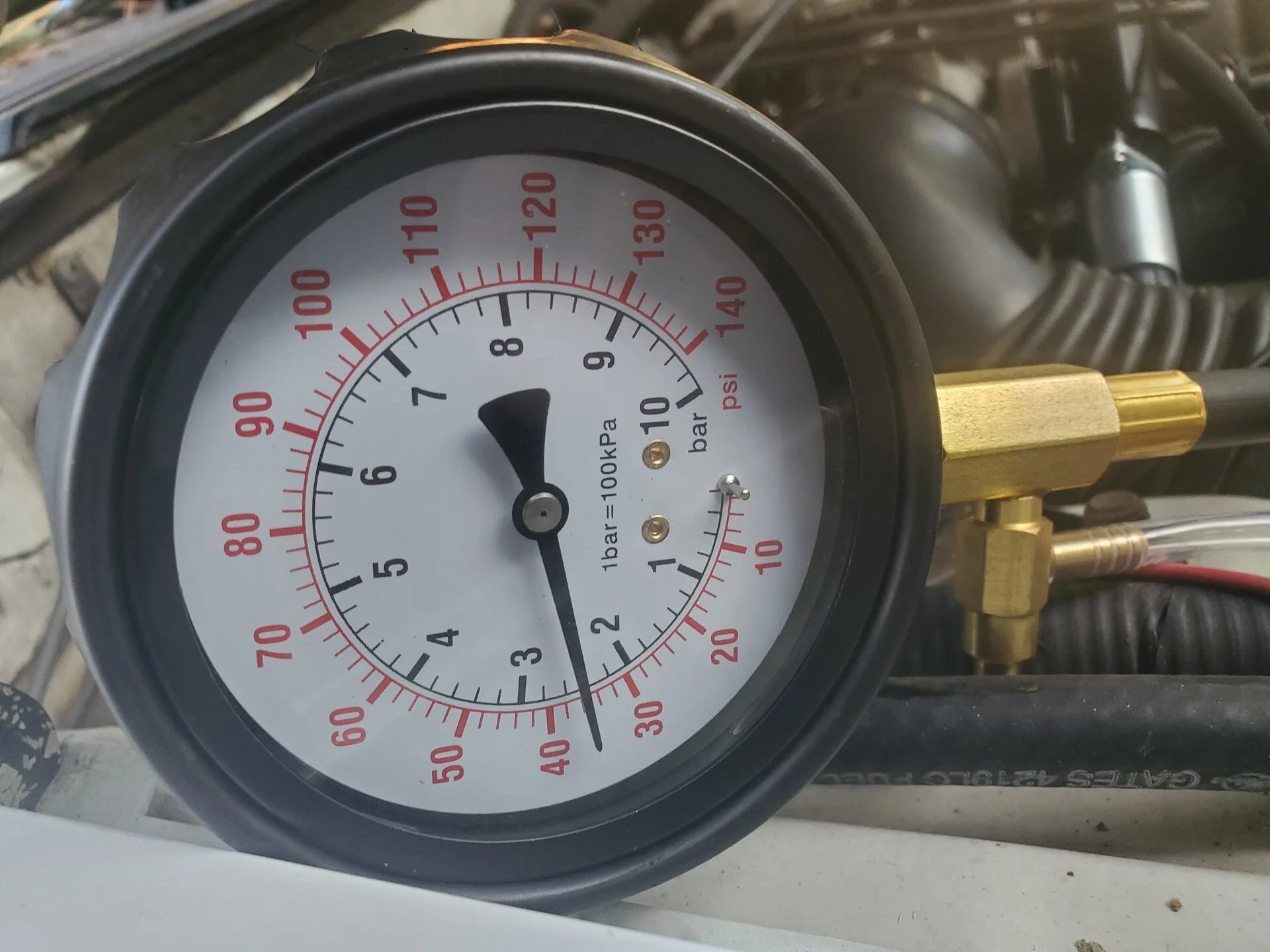

I have a 92 mustang with a 5.0 that's running really rough and not much power. I'm confused as what to try next on it. It has a B cam, 24# injectors, eldebrock upper n lower intake, but bottom end is stock. I've owned the car for close to 20 years and it sits alot. I have put new plugs. Wires, distributor cap, rotor button, new coil, n new iac. I done a base idle reset, and I checked fuel pressure and it's at 35 psi. I bought a code reader and it gave an egr code but when I try to do the test with it running it almost instantly dies. I tried idling it up, but it still dies when I try to do the test. Sorry for the long text, but I'm hoping someone has ran into this before and can point me in the right direction

codes showed an egr code while not running the engine, but trying to pull codes while the engine is running shuts the motor off almost immediatly
