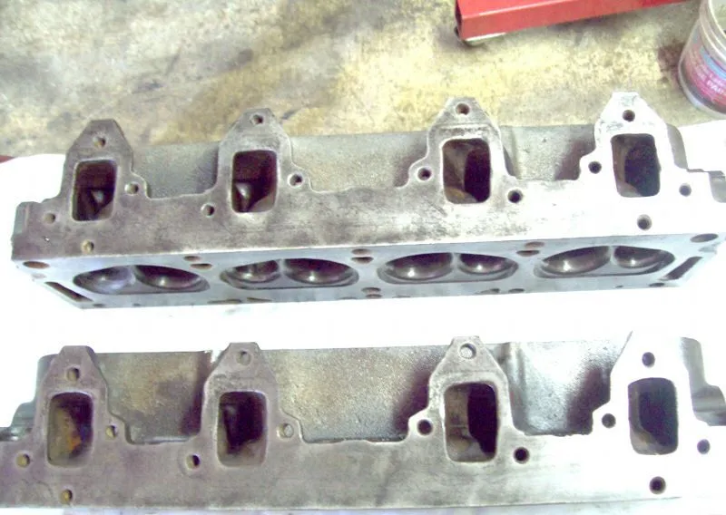

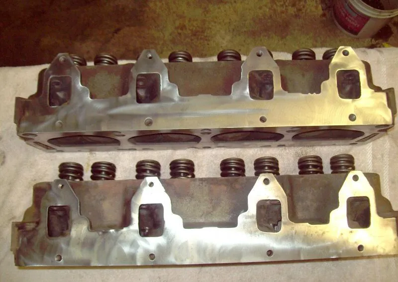

Most any 390 block will do, but the truck/big car heads (by far the most common) are different than the Mustang/Fairlane. Internally, no problem, the cam is available new (same cam as the 428CJ) and the "S" code intake is all over.
Big car:
Mustang:
