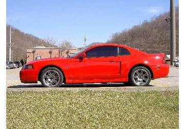

I'm not interested in the Xpipe due to the raspy sound. I want the traditional muscle car sound that the Hpipe gives, just need a little more volume than my CB alone.
