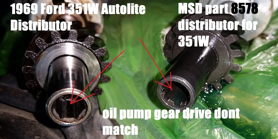

I am trying to install the MSD digital distributor PN 8578 and series 6 ignition control box. The bottom end of the distributor that connects to the oil pump drive gear does not fit on the drive gear. I tried several times inserting. Comparing with the original distributor the threads in the hole are very different. I talked to MSD on the phone and they said they do not make different bottom end shafts for this distributor. So WTF?
Any ideas would be greatly appreciated because I am F'd right now.

It is probably not slipping over the oil pump drive shaft .Some times you need to turn the motor slightly by hand to get the shaft and the distributor to slide together . The gears will stay engaged .

Heres a pic of why it wont fit. Ive confirmed I have the right MSD distributor for 351W. They also dont look same size in this pic but they are same width.

Find an alen wrench that fits inside the dist.shaft and try it in the other one you will see it is the same .The problem is the oil pump shaft some times will not be aligned and needs to be turned so the gears on the cam shaft ,the distributor ,and the oil pump drive key will all come together .The distributor will mesh with the cam but the oil pump shaft will be slightly off ,that is why you need to either turn the oil pump shaft or turn the motor over slightly so the shaft will align and allow the distributor to drop all the way in .

Ok thanks! I totally forgot I can turn the oil pump with a socket wrench extention. I hope your right! This is at least the 3rd big parts order i have had go horribly wrong this year.

It is not a problem ,it is just how Fords are .you may have to try a couple of times to get it to align. Be careful not to drop the socket in the block ...Then you will have a problem

I discovered the oil drive gear is a 5/16 nut on 69 351w. So I got a 5/16 nut and was able to get it to fit. After pushing it in and out a few times it got easier so it will fit. So now the issue is getting it PERFECTLY lined up so it will seat. I have been rotating the gear by hand with a socket a teeny bit at a time all afternoon with no luck. I also marked the socket where a flat surface is so I could try line up with where it lines up where the rotor is on the distributor but no luck. I guess all I can do is keep trying. Besides taking the oil pan off I haven't found any tricks online to make this easier. If there is please let me know. Thanks,

Set the distributor in place so it is as close to your number one spark plug wire in the distributor cap as possible .The gears should be engaged ,gently push down on the distributor as you turn the motor with a breaker bar and socket on the crank bolt .It should not have to be turned very far and the distributor will drop in place .
Just remember as the distributor falls in it will rotate the rotor a bit more so allow for it .
Once it seats you can turn the motor back to top dead center if that is where you had it .
Edit : I would set the motor to top dead center if it isn't already ,then set the rotor to drop in on the number one spark plug wire on the distributor cap .that will make it easier to get your timing close enough to start .

I did this at about 5pm yesterday so this is how I got it done. But thanks for the suggestions. Over all you helped me figure out a different solution.
After 3 hours of manually turning the gear. Teenie tiny turns. It still would not go on. I wont say how I got it to fit because I will take tons of hell for it. But I "adjusted" it and it went on after only like 10 minutes of trying again.
The problem was that the "precision machined" product was overly precisioned and it physically will not fit a 5/16 gear. You have to make it fit yourself.
