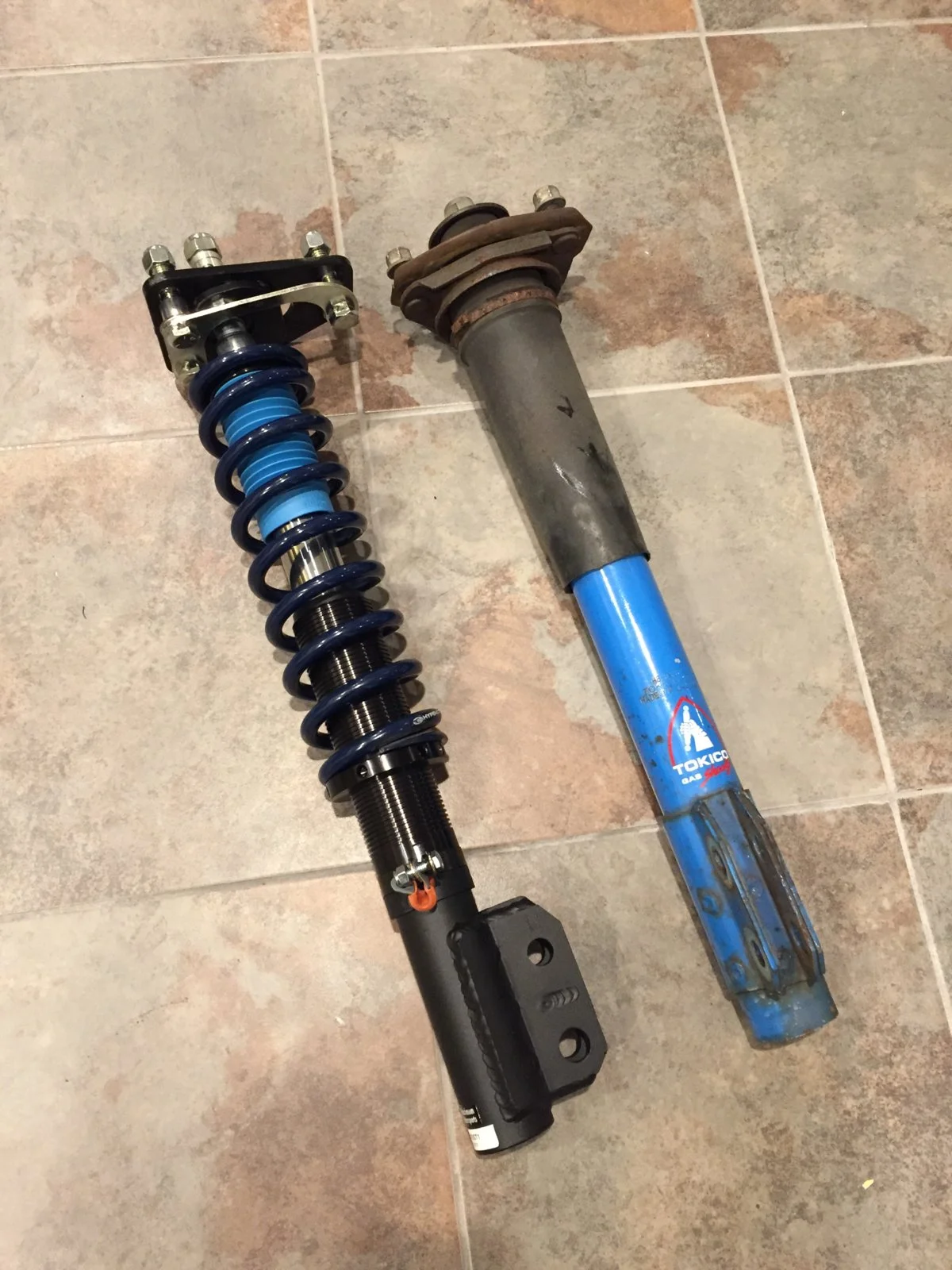

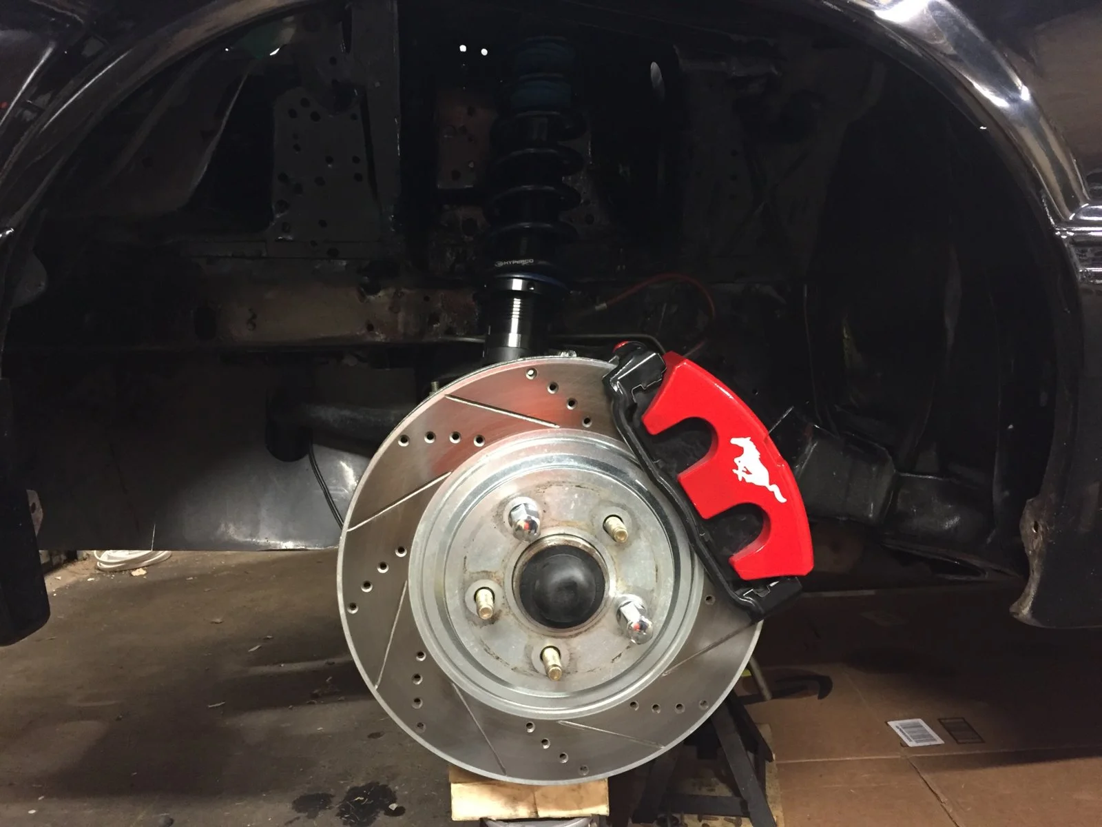

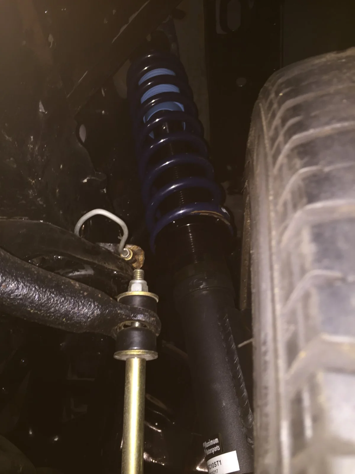

Removed the coil over to start relocating the brake line mounting bracket. Didn't have a good sharp bit so I had to stop.
Assembled the other side for now. Gonna be some time before I install it (car too close to garage wall and needs to move) so is easier to move around this way.

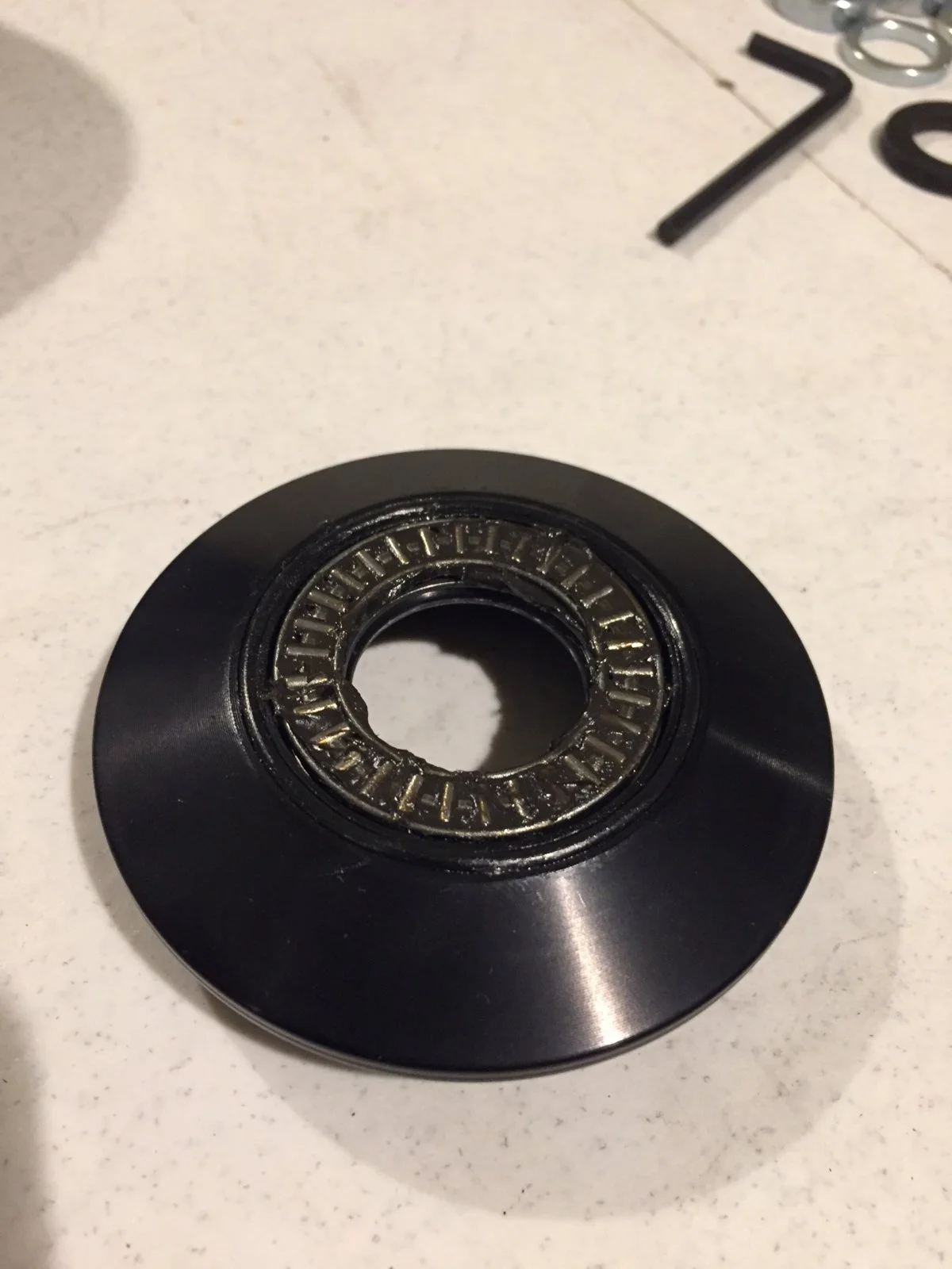

Compared to the old blown out Tokico. Going to hang onto this for now. When it's time to measure bumpsteer, I can toss this strut in vs taking my c/o apart to pull the spring out.

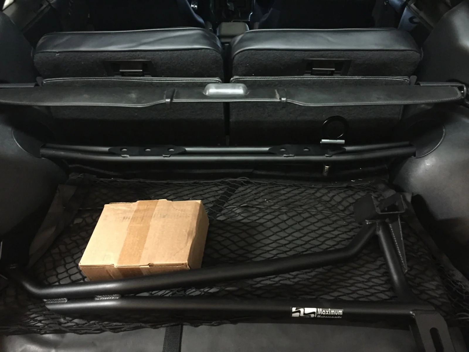

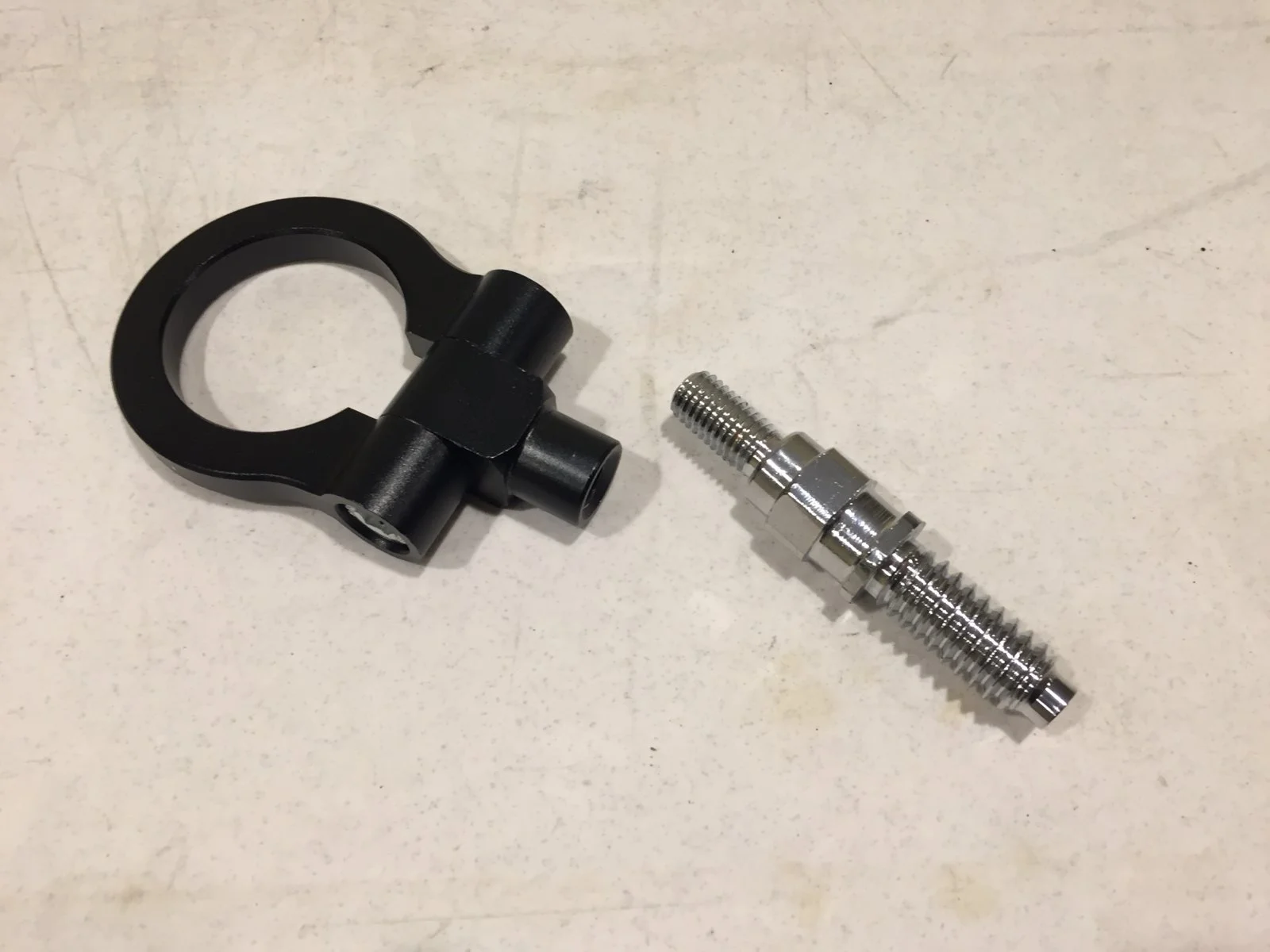

Found a tow-hook on eBay that I'll mount to my rear bar for the tether location. Just need to get some hardware

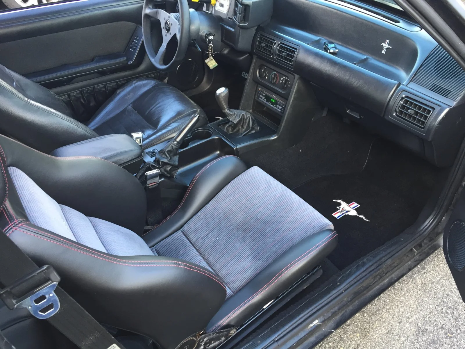

But now with a functional rear seat and seatbelts and a tether spot, I can take my boys for rides this coming summer.

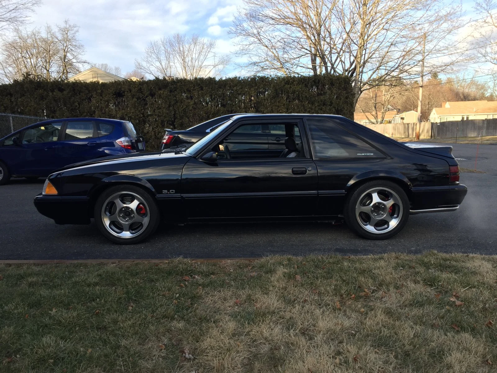

And before Karthief says it...yes I know that's not where the panhard bar goes
