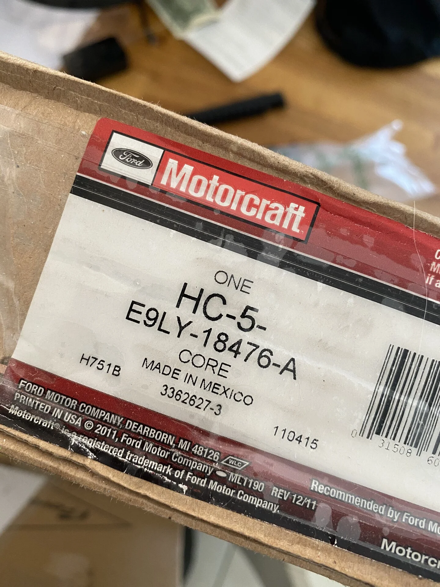

Also, what the he’ll is growing out of my starter?
300 miles or so since I swapped this. Might be worth an email to them

Flywheel get resurfaced, scuff the plate and clutch assembly with sand paper and run it.
What's up with the freeze plug above the starter? Was it leaking onto the starter?

This might have something to do with it.
Factory block heater freeze plug leaking green, oily residue right over the starter.
Good call
I wasn’t kidding when I said this engine leaked from every gasket and sealing surface.
