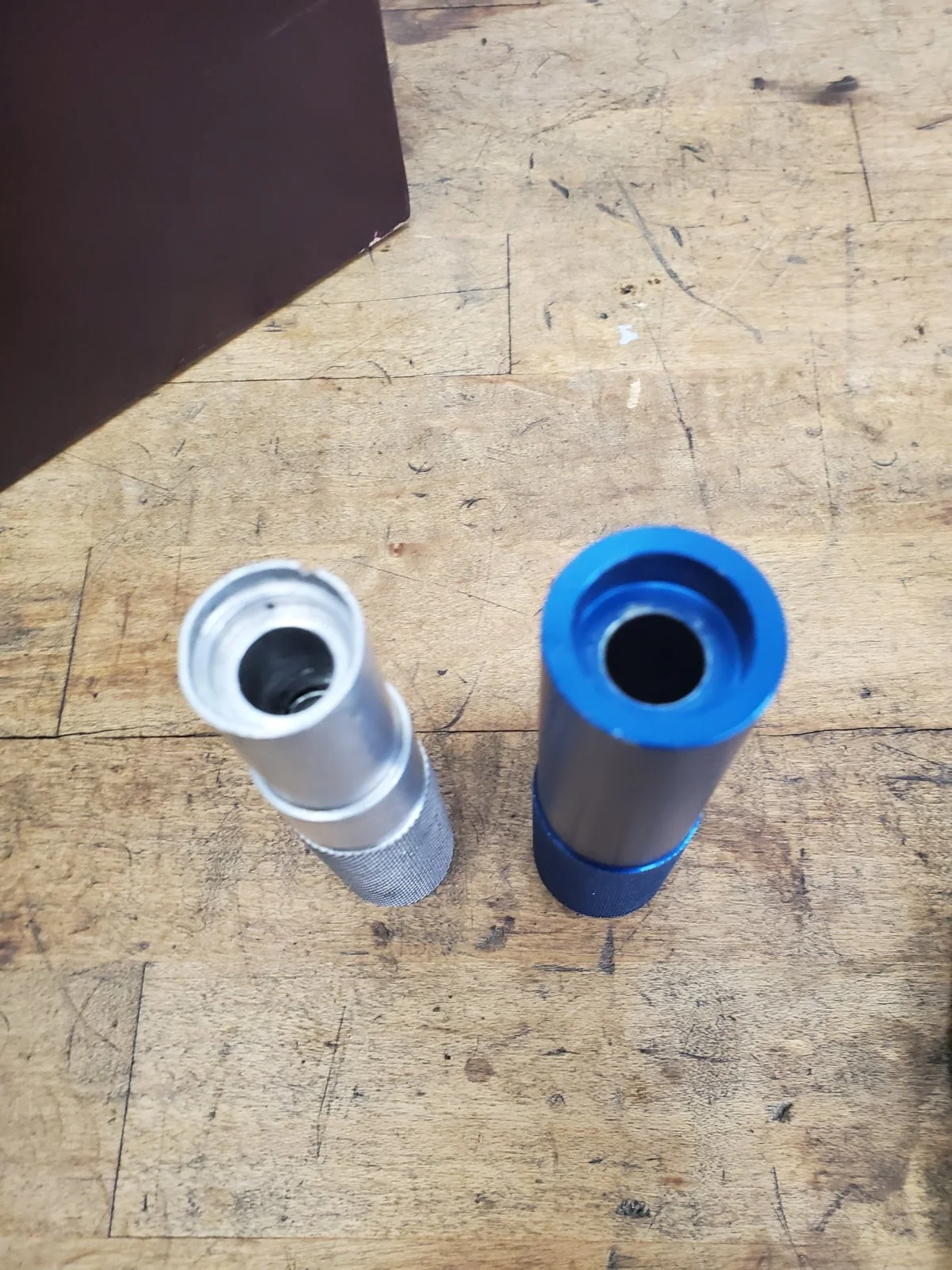

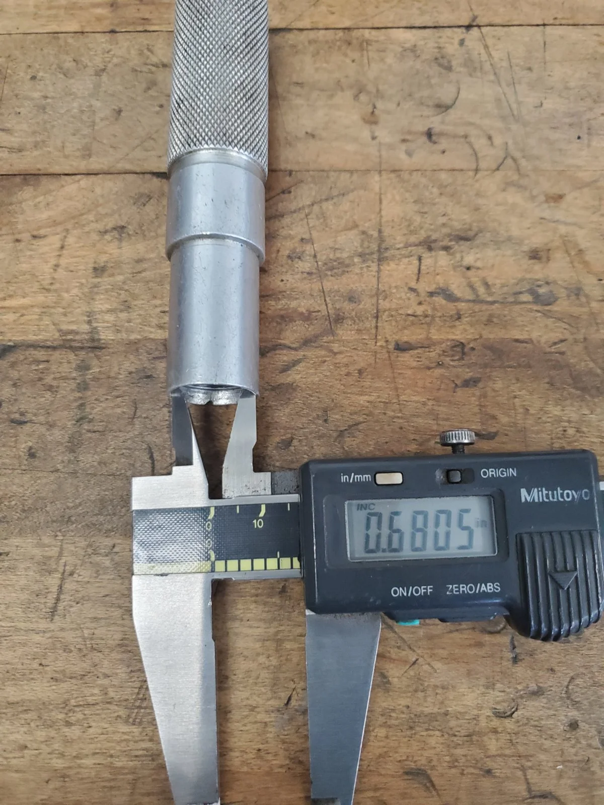

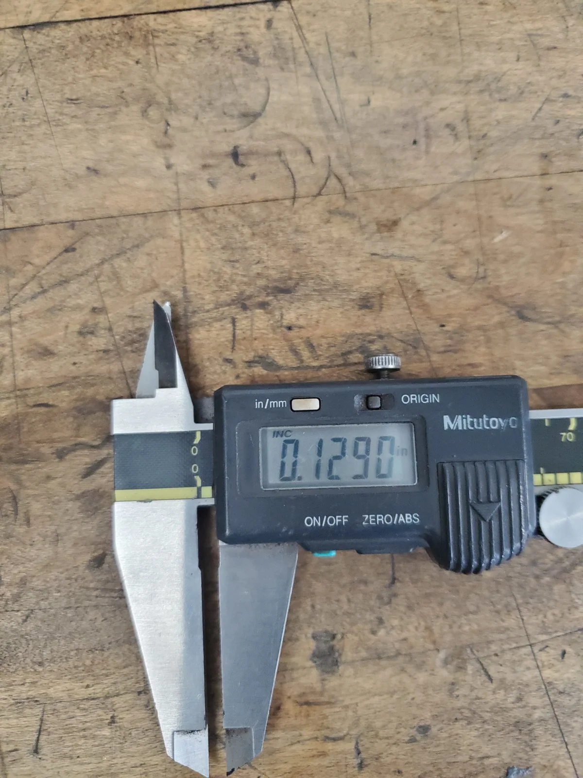

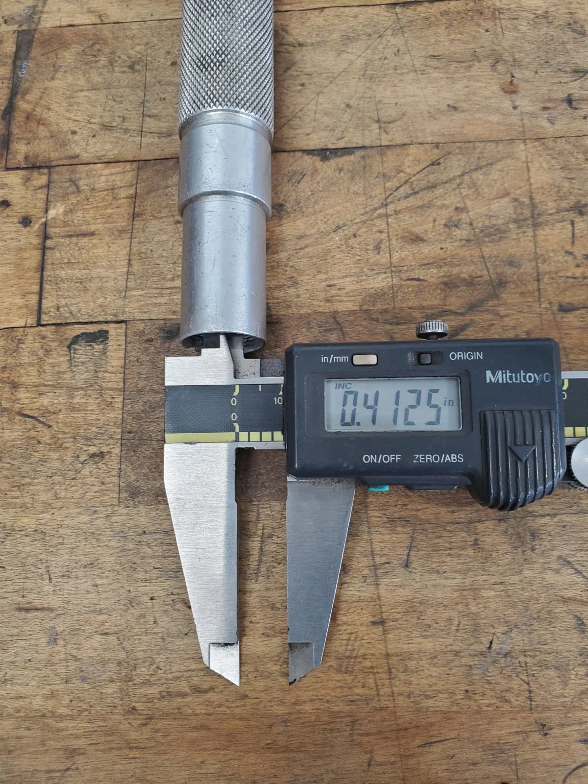

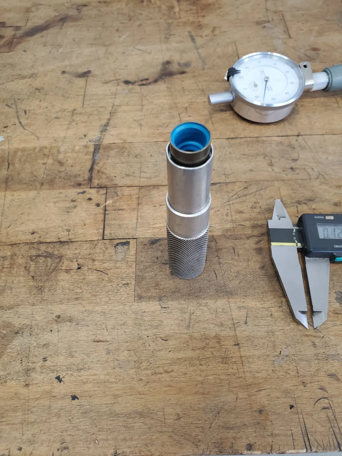

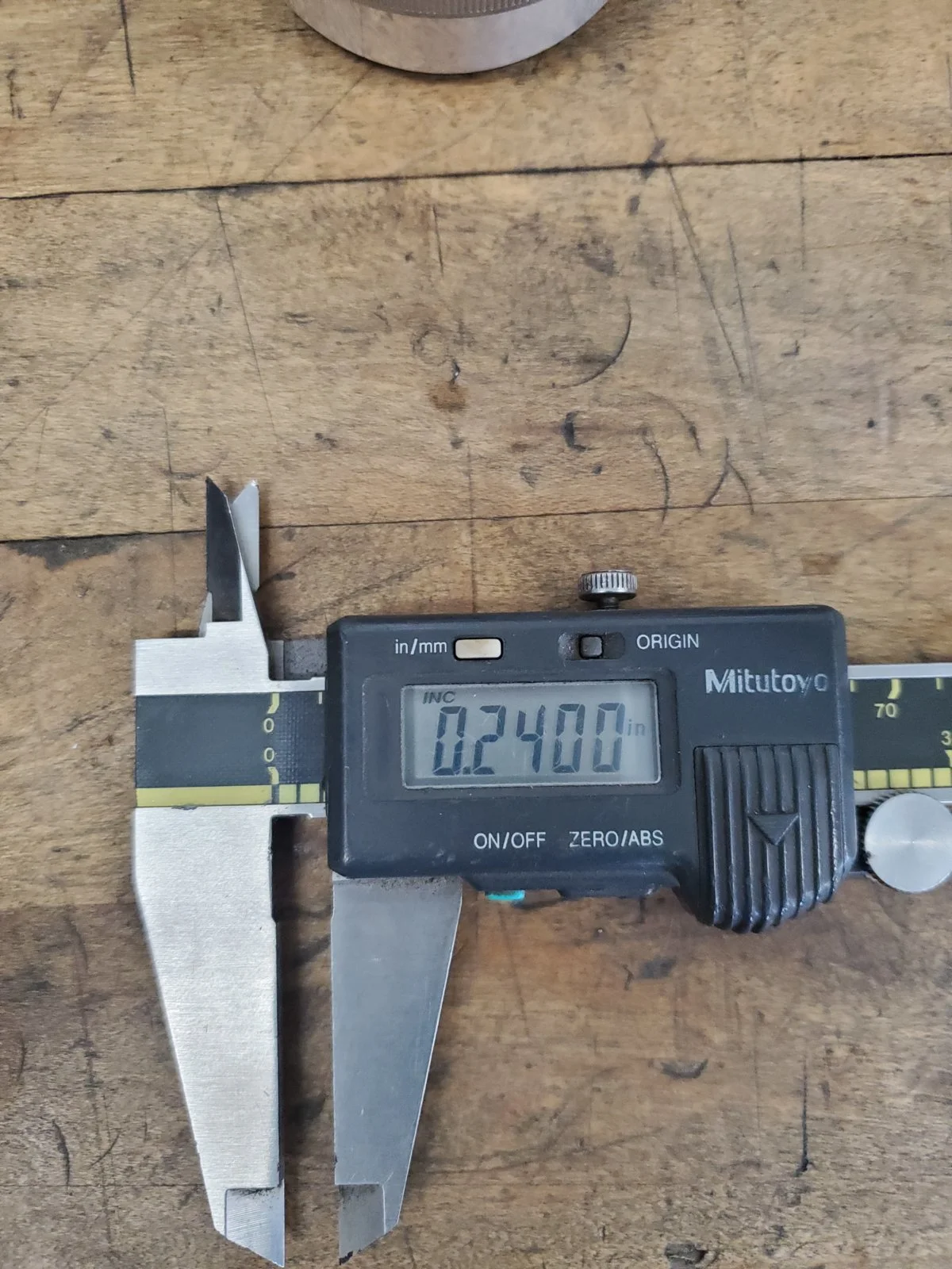

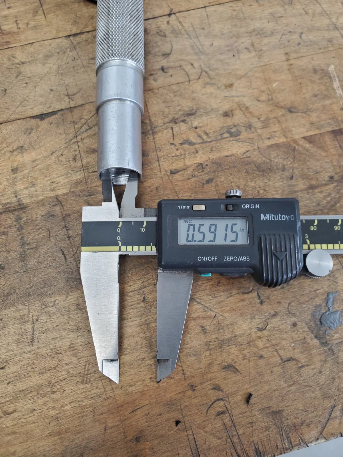

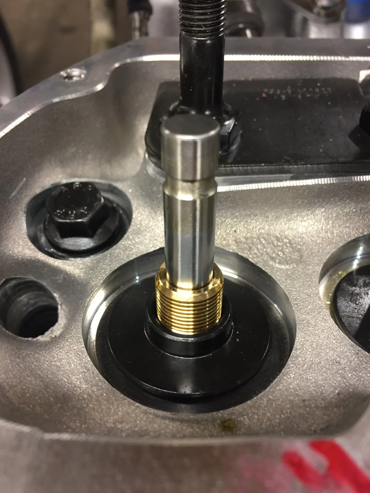

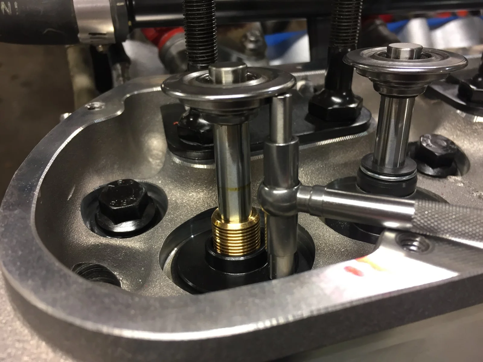

I have 2 styles, the blue would push on the top of the seal and probably be ok unless you were careless. I got dims for both but am just posting the silver as the double step grabs the outer body better. Diameter may vary depending on size my sample is .623 OD for a 11/32 stem.

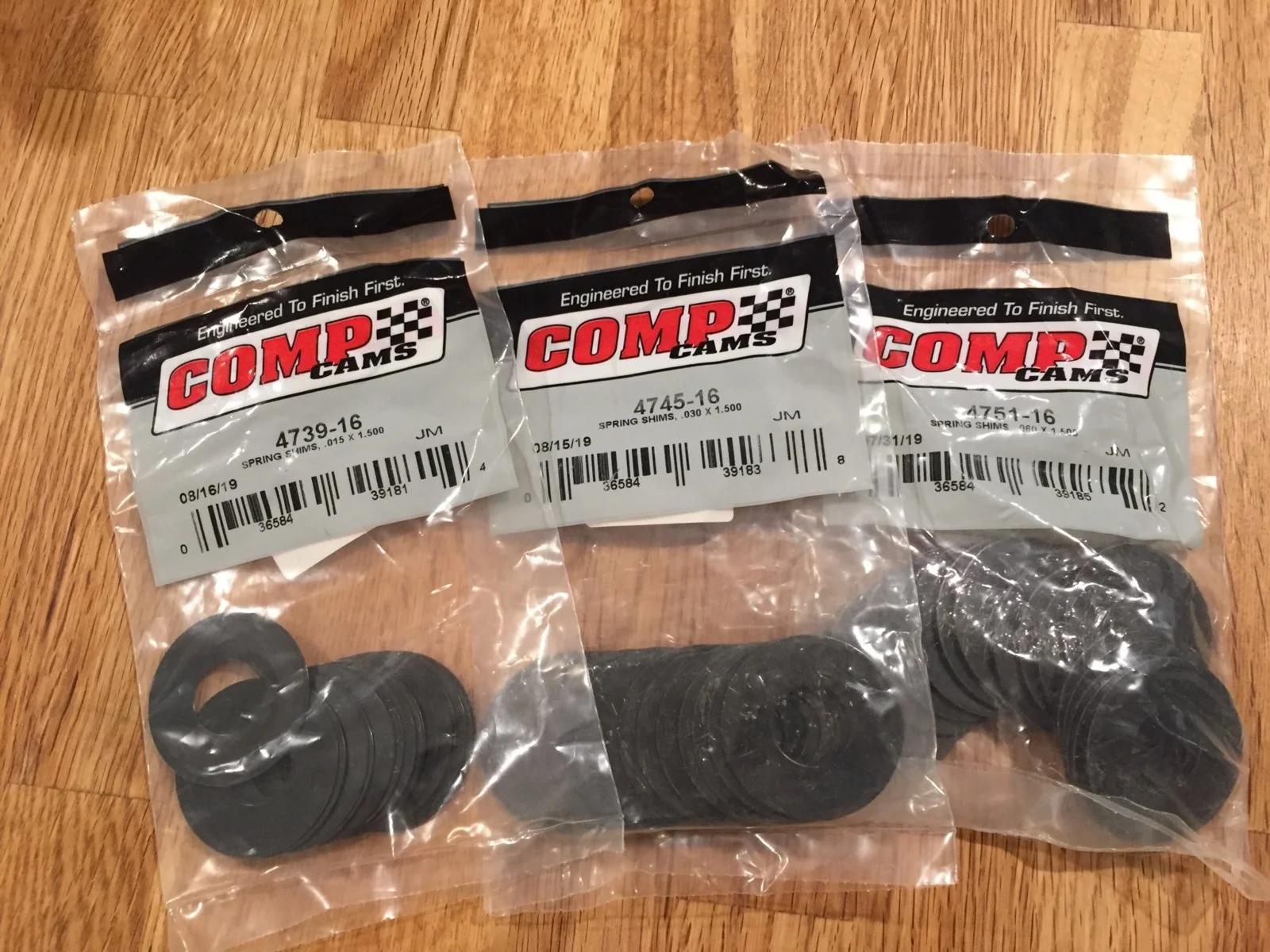

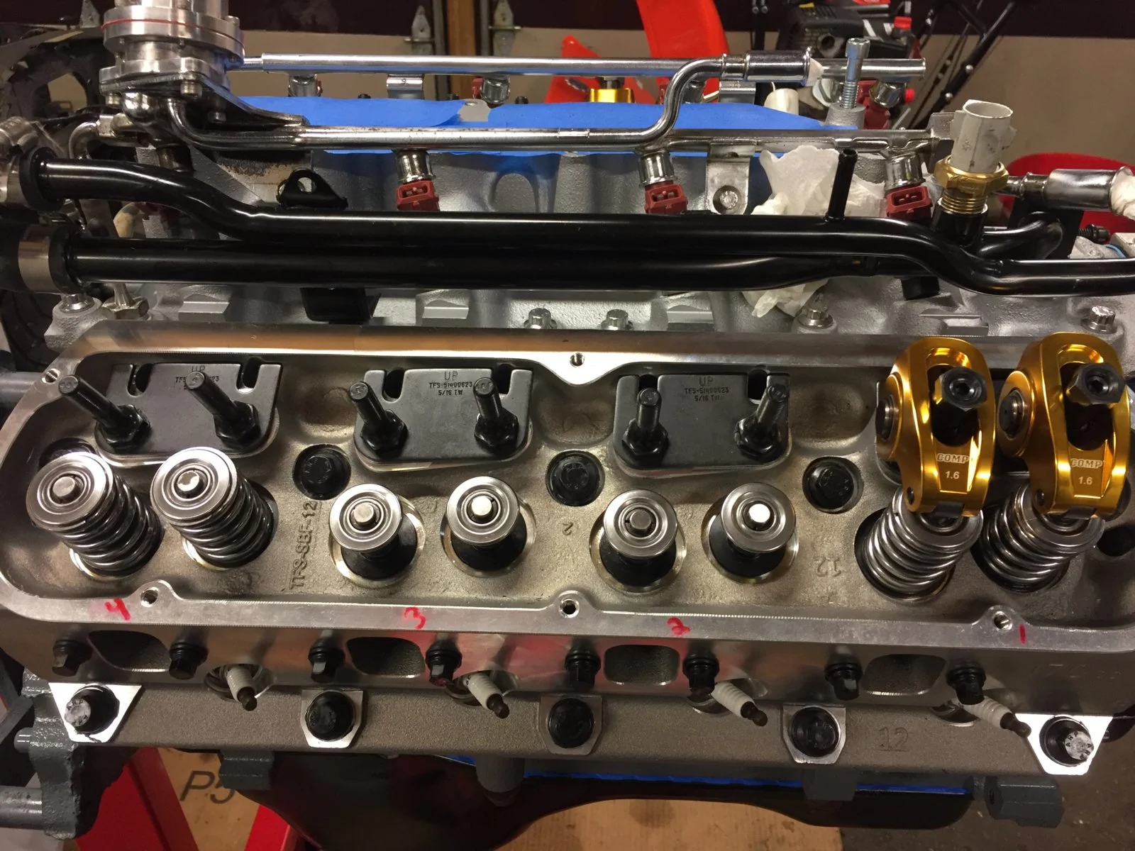

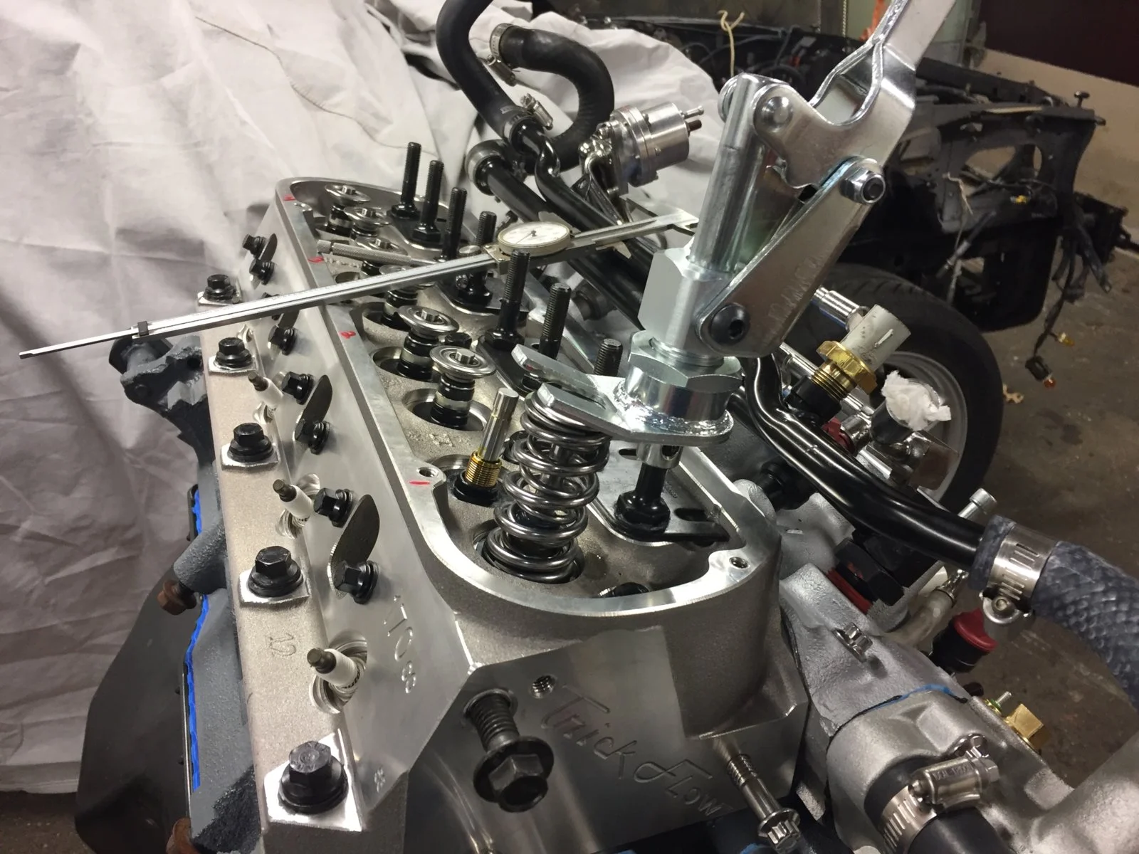

Shims showed up, so I decided to try and set up a few cylinders
Was a slightly tedious process given installing the retainers and keepers. Install, measures, remove, shim, install, measure...and so on.

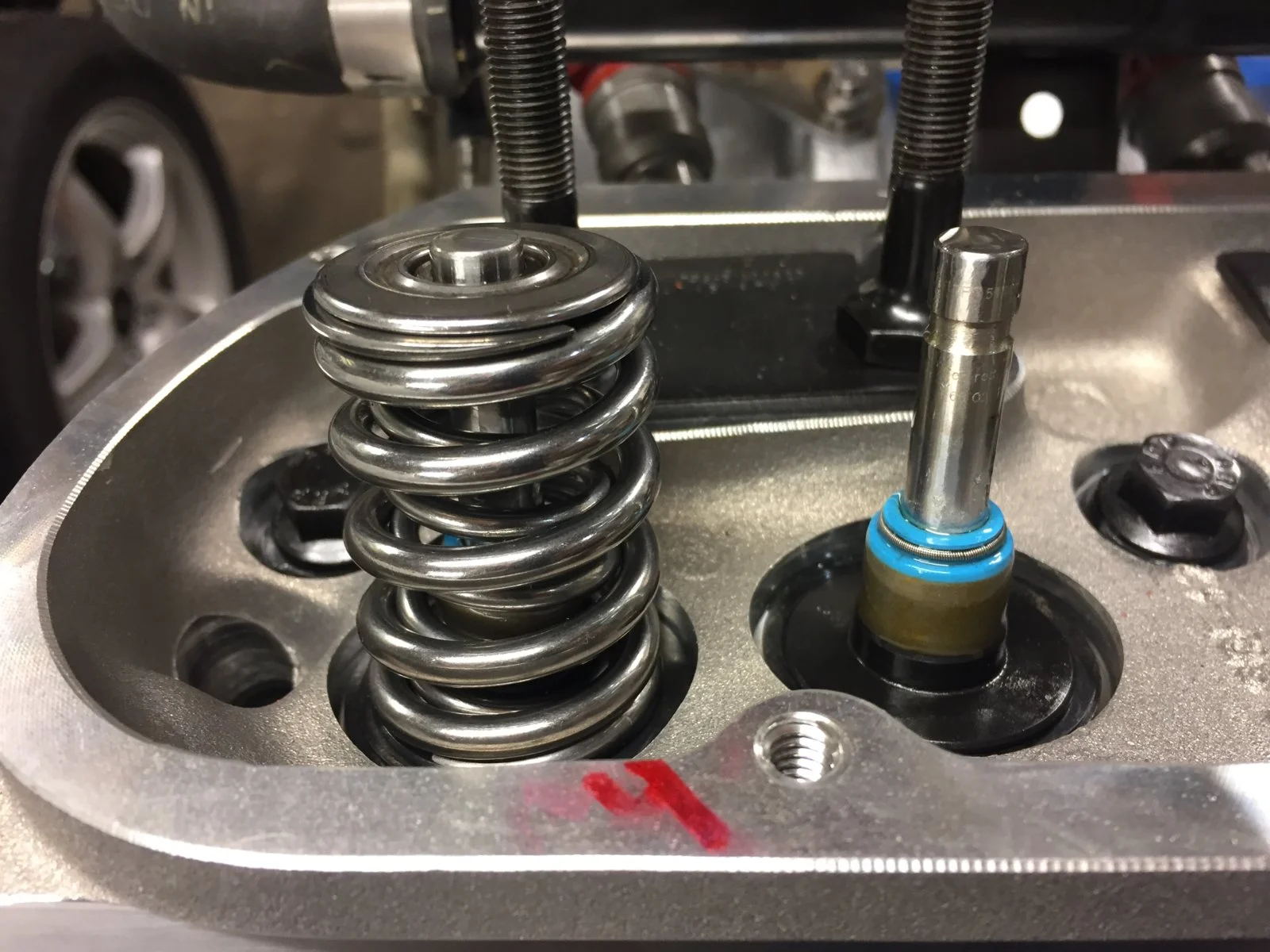

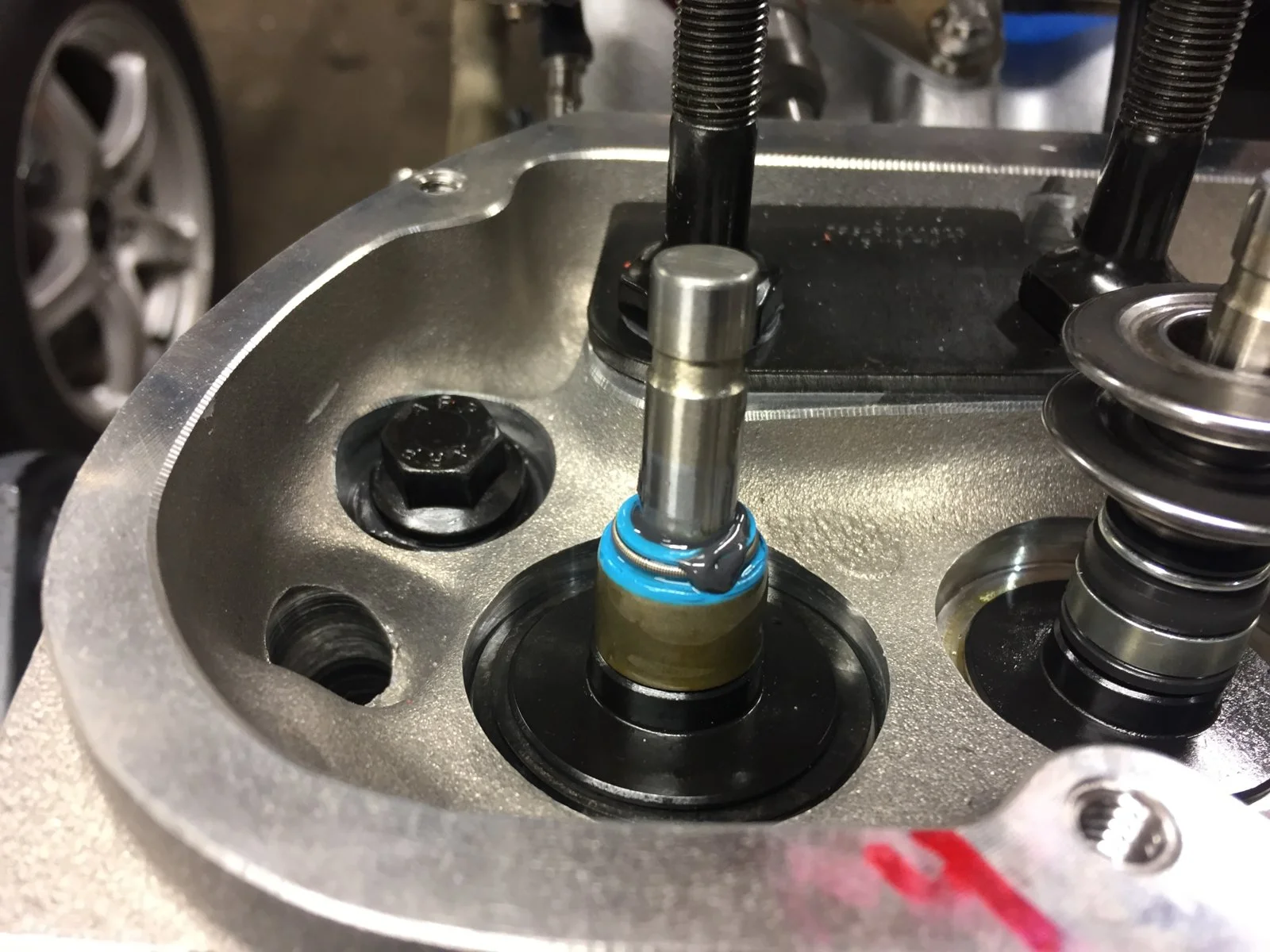

Valve seals weren’t s big deal. Found an appropriate driver. The metal shell version definitely is superior to the clamp ring style.

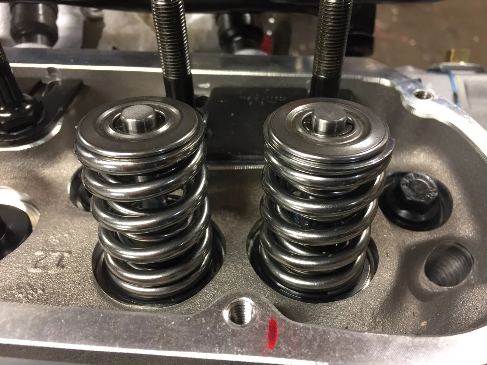

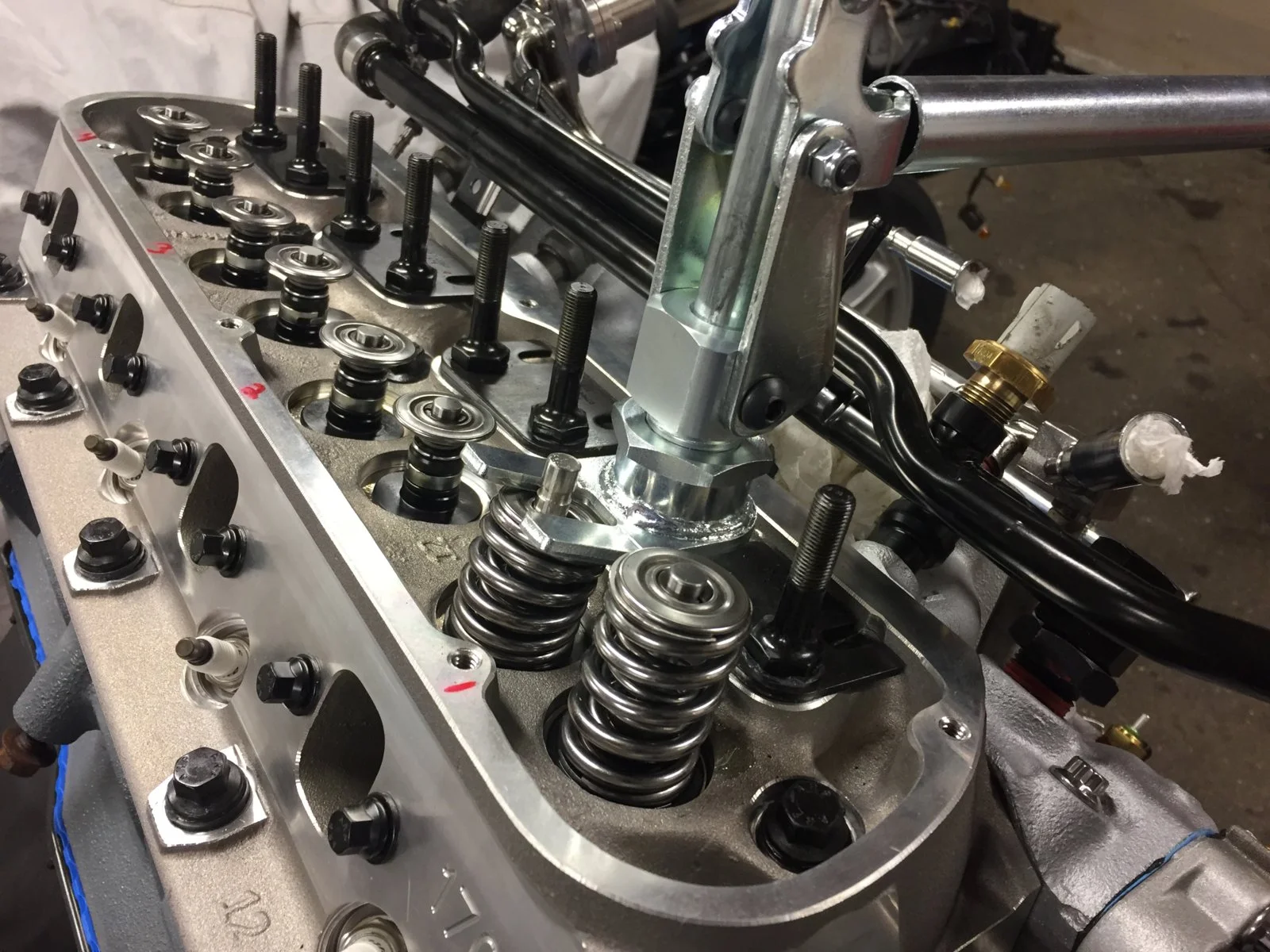

Spring install was no big deal with the proform tool.
And just becUse I had to see the final look.
Took me an hour to do 4 springs. Stopped for the night

So....I thought you were installing the blue metal shell valve stem seals? Don't I see the black ones in the new pics? I probably misread something. Excellent pics, like usual.
I reinstalled the black ones just to hold the valves in place. Without them, the valves slowly drop down into the cylinders. I'm doing the cylinders in pairs to have the cylinders up at the top of the bores to provent the valves from dropping, so i'm changing them out as I go. Less risk.

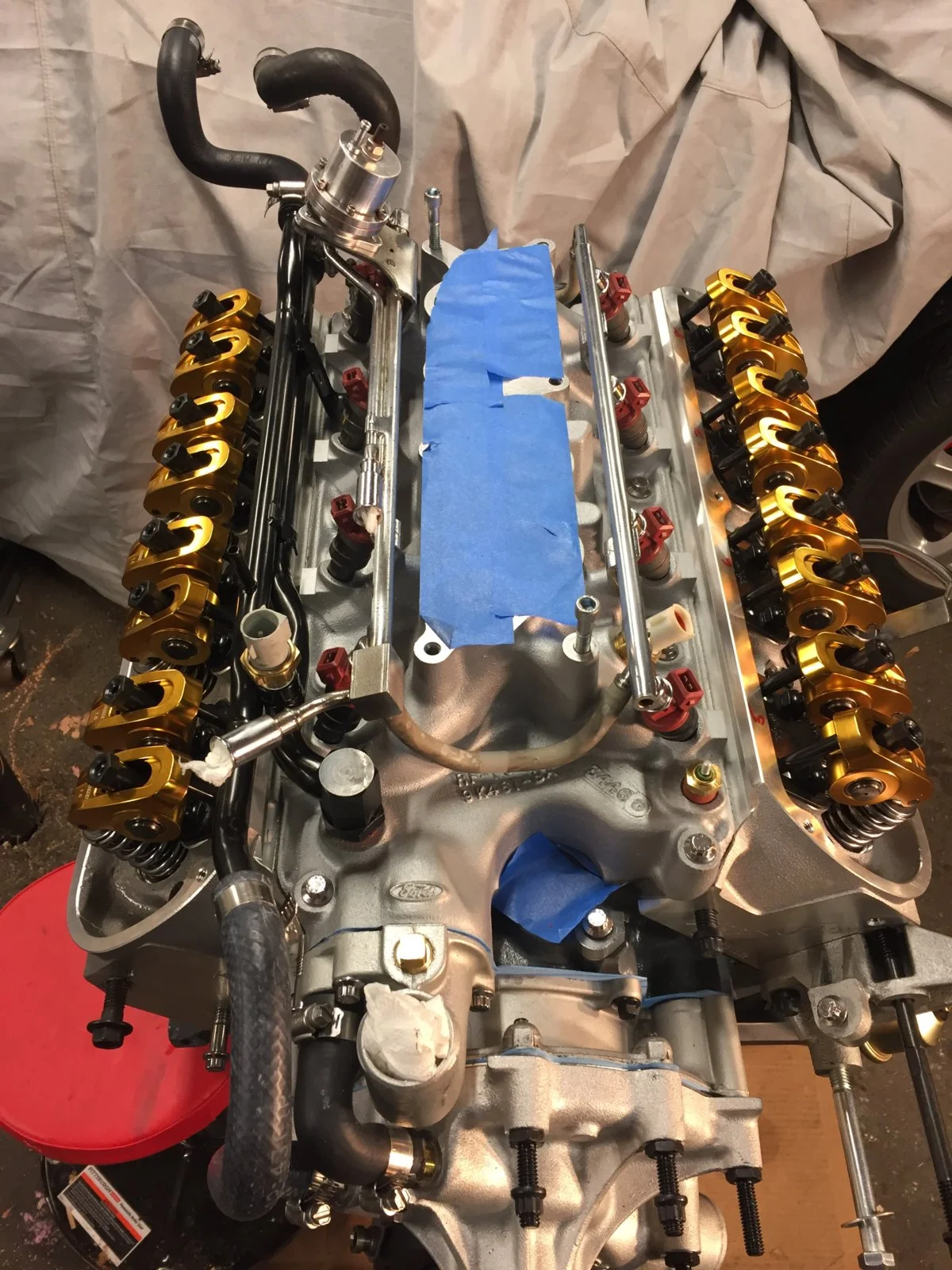

Next hurdle is adjusting the rockers. Just ordered an oil pump priming tool. Getting closer

So what made you change the valve seals over the ones that came on the heads? I am going to be rebuilding my heads soon, and want to pick out the right style. Your attention to detail is very helpful.
New ones are supplied with the spring kit. They seemed much sturdier than the ones TFS supplies.
Also, the act of pulling the old ones off does kinda nick them up a bit, so the fact that I have brand new ones in the package to install is sort of a no-brainer when you consider the issues surrounding reinstalling potentially damaged ones.

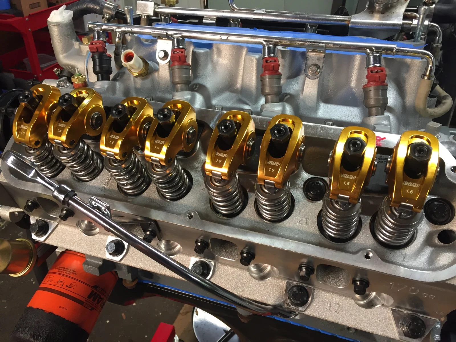

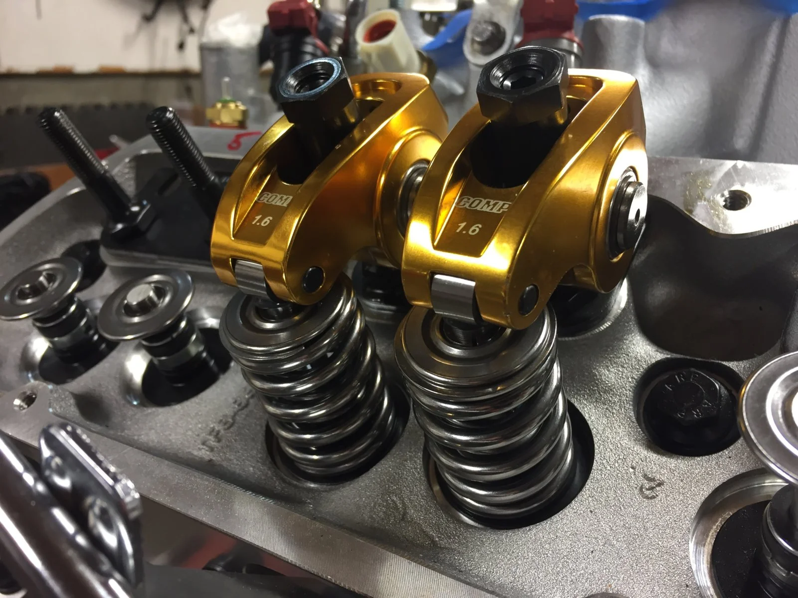

So, all that's left to do is adjust the rocker arms. Still haven't purchased valve covers yet (I honestly can't decide) but i'll take a page out of @TOOLOW91 book and slap the stock ones on for now so they don't get scratched up when I reinstall the motor...which isn't going to be anytime soon. I just want to get a cover on there now to keep crap out.
SO...for rocker arm adjustment, I have them set to zero lash right now. These are brand spanking new lifters, and while I can feel the spring in them and can tell they are fully lifted up, do I need to prime the oil system first and then set the lifter preload, or can I do it on dry lifters?
The install instructions say set to zero preload, and then go 1/2 turn past and lock it in place. Sound good?
I do have my oil pump priming tool arriving today? Should i toss some oil in it and prime everything up? Would give me a chance to verify pressure with my guage, as well as oil the top end up, fill the lifters, and just verify all the rockers are getting oil before i button it up.
I ordered a new engine stand to allow me to put the engine down and bolt the flywheel/clutch/bell and trans up. Should be in the mail shortly.
OH, BTW, the valve spring install got quicker once i got the hang of what i was doing. Took me about 2 hours to do it on the engine. I made it easier by already having all the springs off anyway. I intitially balked at the idea of buying the $65 Proform valve spring tool for what would be almost a one time use really. The compressors i could rent were crap. Only reason i breezed through this install was due to this particular valve spring compessor. It made the job a breeze. SO easy to use and no damage to any components or cursing or swearing on my part. Having the right tools really does make the job easier
