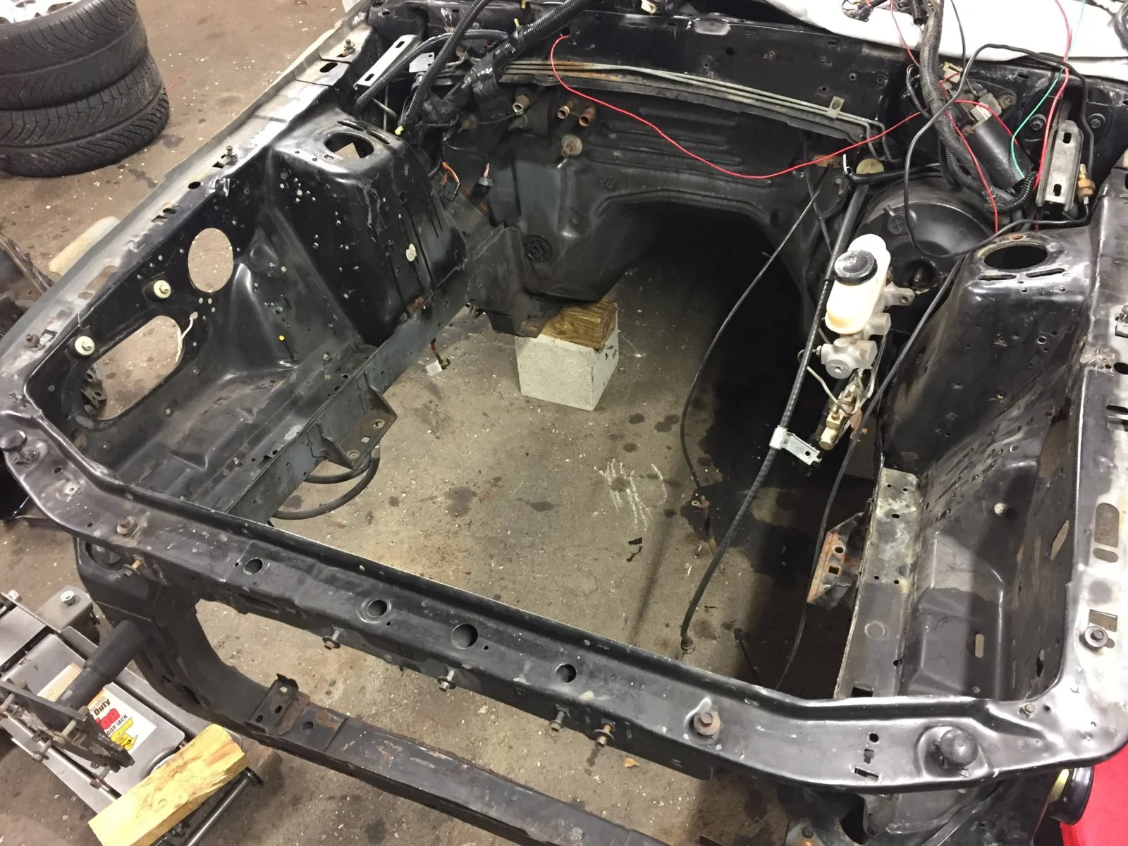

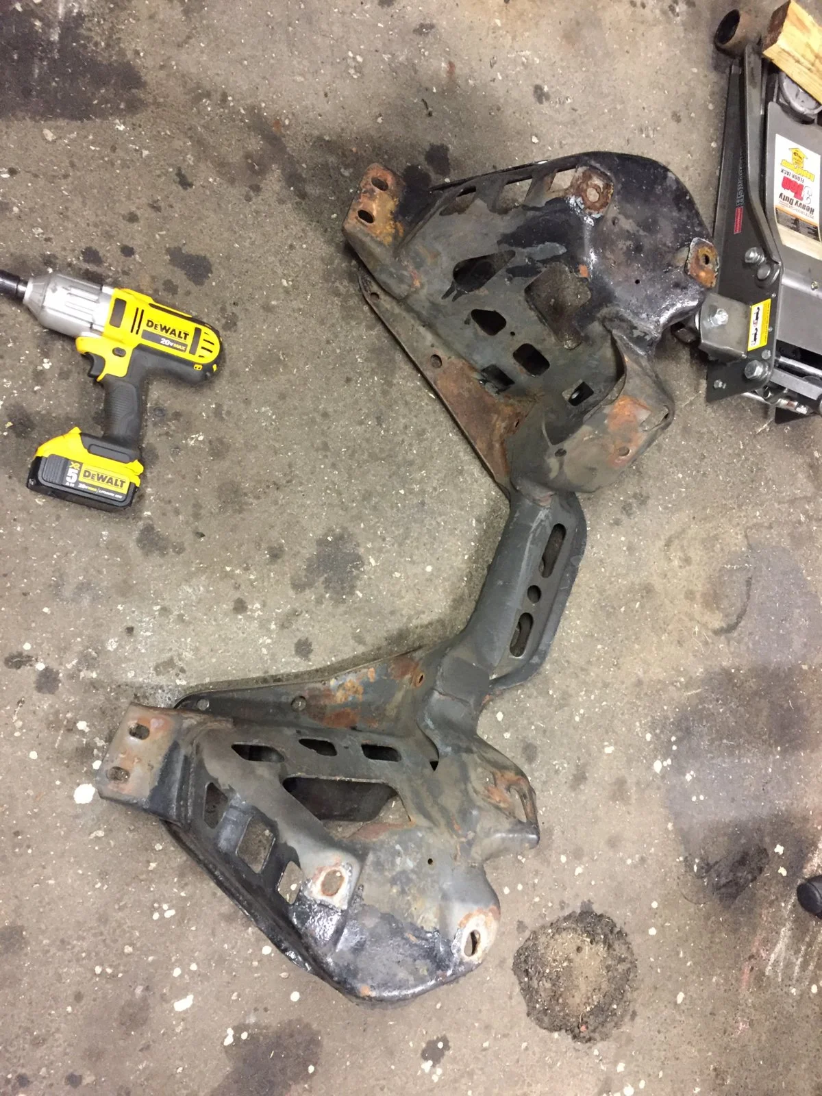

Dude, I hope this doesn’t rub you wrong, but I still feel like your front wheels sit toward the rear of the wheel wells... Is it possible your K member is pushed backward, and that may have something to do with the brace not fitting?
I actually suspect you may be right. Between the brace not fitting and some crude measurements I took, I think the drivers side wheel is more rearward.
More reason why I'm eager to pull it apart and check it out further and replace the k member.

But taking crude reference points it does appear one wheel is set back slightly more than the other. Of course i'm also using a tape measure to figure this out referencing the rear axle, which could also be off slightly as well.
My eyeball-measurement says something does look a bit off on the driver's side front, but that could just be the picture.
2nd, measuring from the axle is no good until you verify that it's straight. Your rear axle is likely off, because foxes are well-known to have imperfect body-frame alignment. The difficulty is finding the baseline reference to measure from. After "stringing" my own car, I can tell you that finding good points of reference on the car to determine a center-line is really tough. I ended up using some best guess points by going down the frame rails with a plum-bob, marking points along the floor, drawing lines representing the frame rails on the floor, and then using a right-angle rule to draw a perpendicular line on the floor. I taped a 6' straight rule to that and used it to measure by. I had to find spots on the rear axle housing that I could be consistent with. I'd drop the plumb bob from them, and measure back to them. Then I adjusted my control arms until they were as close as I could get them. You'd want to do the same from points on the k-member & it's bolting points to figure out what is really off.
In case your eyes have already glazed over, I've attached the pdf reference that I kinda followed, while substituting my own methods for what I had available and how the fox chassis is (crankshaft is not centered). It amounts to finding the center line, taping a perpendicular straight rule and then measuring to various points from that. It's the route I'd recommend for your measurements, too.
Frankly, it felt like a lot of guess work. It didn't really feel perfectly satisfying, but I still can't think of a better way to ensure the rear end was aligned correctly. Maybe an alignment machine would be better, but I don't know too many alignment shops I'd trust to start jacking around on my control arms, lol. Perhaps in your case, just knowing the rear is properly aligned is good enough, but then, is it centered? I thought I posted about it and took pictures, but I'm not seeing it...
