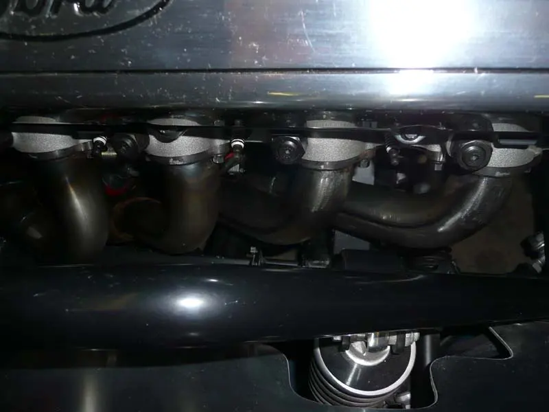

My headers

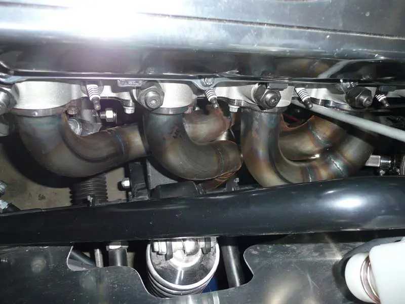

Here are some header pics. Driver side is 99%...some clean up work on the links I added and still need to weld on the reducer flange.
Began work on the passenger header.
