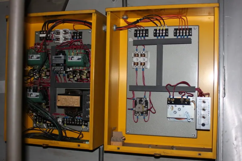

Productive couple days though. Got both my RCM panels out and got most of the wires traced. Have one major one to pull and some to disconnect from the Tbolt itself and she'll be ready to come down. Can't wait till she's mine and I can open her up and see how she looks
Here is the RCM panels. The one on the left is a RCM1A the one on the right is a RCM3. The 1003 thunderbolts used the added RCM3's to control the hi/low tone

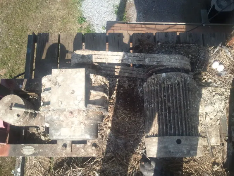

Saturday I was able to get the chief to pull the tower out and set it up so I could get up into the motor box (big square box). Holy **** and I do mean that literally. The thing is full of pigeon crap. There is a couple eggs in there and some small birds that were running around in there that were with a pigeon. Not sure if they are "baby" pigeons or not. You can see the one in the pic. It was all but sitting on my foot. It's gonna need a date with a power washer when it comes down. It's basically ready to come down off the poll whenever my friend with the crane can come by
