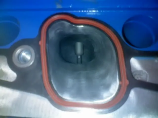

It still amazes me you're able to run those kind of times with self ported NPI's. There are only a few people with ported PI heads on a NPI block that come even close to yours N/A.
How in gods name did you perfectly port the heads yourself???
98COBRA281
Nov 24, 2007
1,348
30
59
Port St. Lucie, Florida
Oct 6, 2010
#39
  • Oct 6, 2010
  • #39
what if i told you it was the first set of 4.6L heads i have ever done? and i was only 17 when i did them?
here's an intake port with a pi gasket on it
seriously tho, i have been doing motor, head, ect work for years now, ive been doing it with my dad since i was very young, i used to port the heads on my briggs and stratton 5hp gocart! i even ported my goped 2 stroke head...
