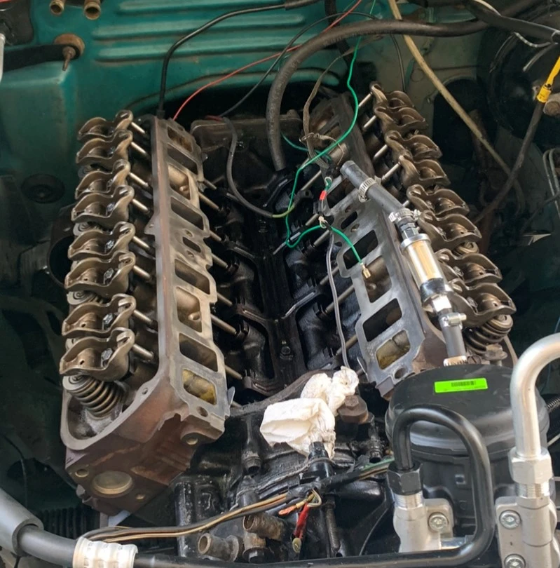

I got the GT40p heads. They look great and there doesn't seem to be any issues. Added bonus: The heads already have upgraded valve springs. Upon further inspection, I actually have a roller cam/lifters. I find it interesting that the previous owner told me it was flat tappet, considering he, well, owned the thing.

Update: Got the heads on. Lapped the valves, cleaned mating surfaces, and installed. Took a while but got everything put back together. I screwed up the firing order and thought something major was wrong. whoops. There is a noticeable increase in power and everything is running well. New headers are still on the way... still have the bad stock ones for now. I'll post another update with the part number if I can get those to fit without plug clearance issues.

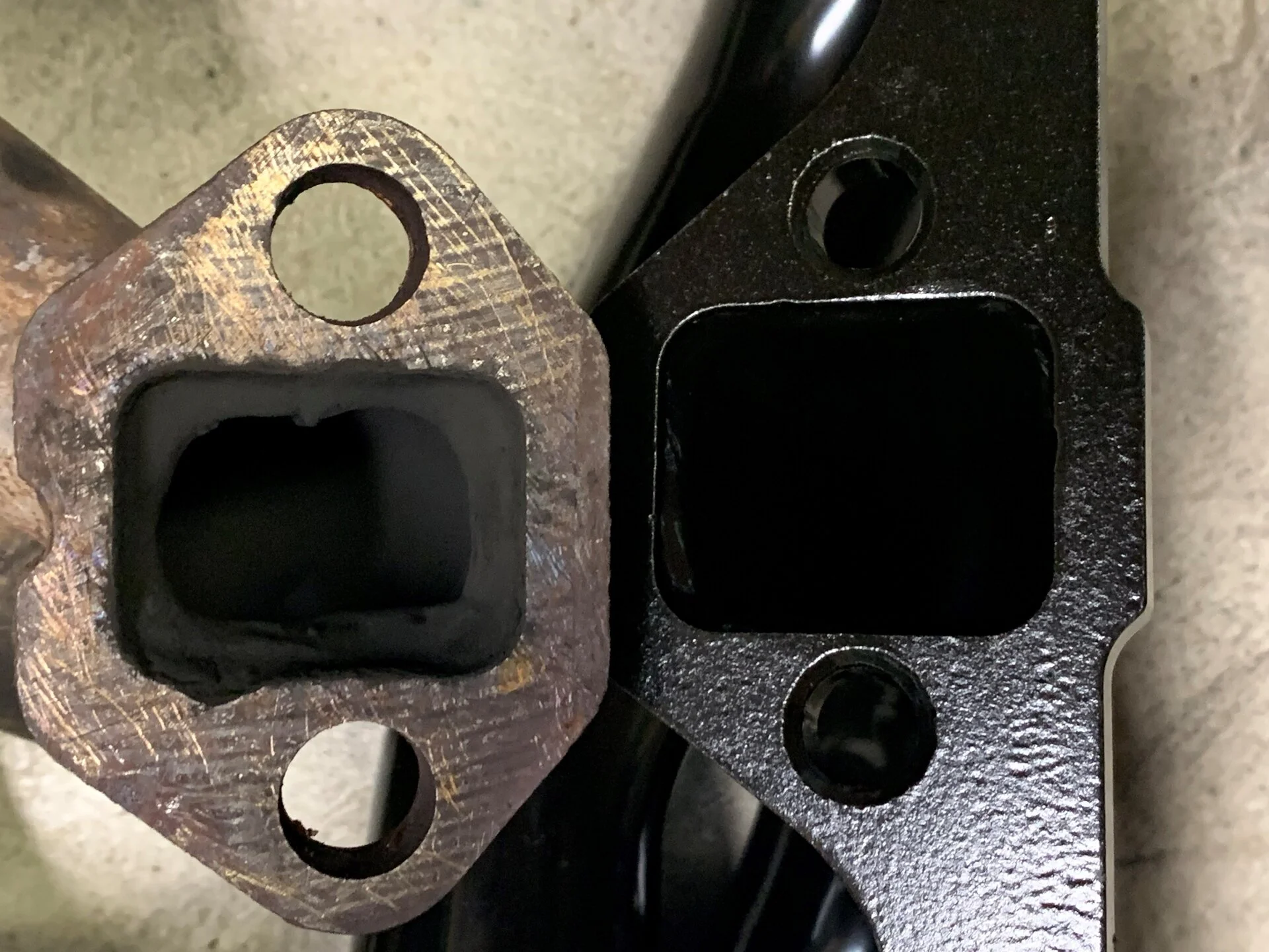

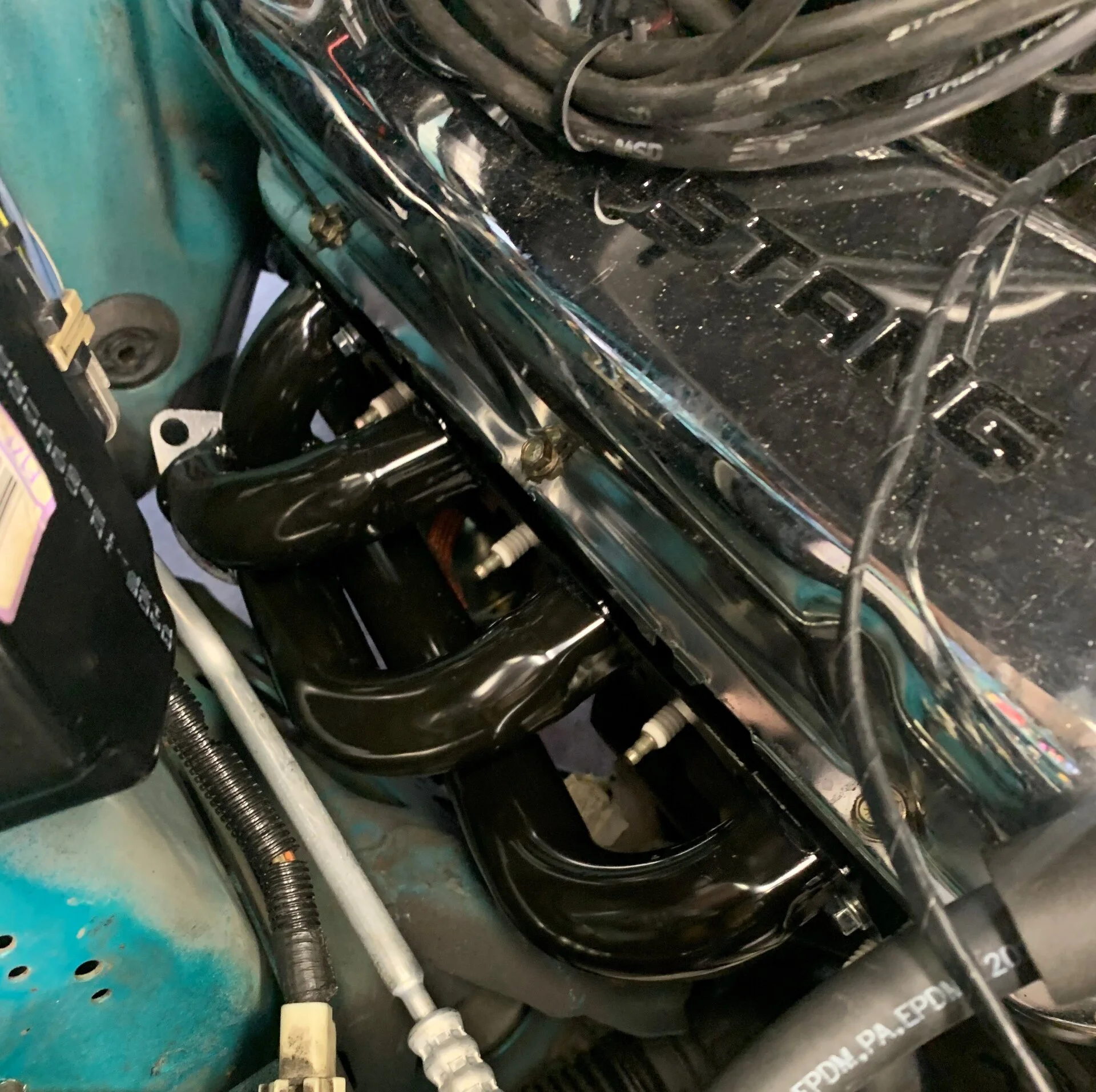

Installed the headers. I can confirm the Speedmaster 746-PCE316.1002 will fit GT40p heads without clearance issues. I have 45 degree plug boots, but I think normal ones would fit too. Might touch the header though. The only piece I had to remove to make them fit was the dipstick.
The driver side was a little more crowded, but the plugs were pretty much in the same spots.
I haven't had a chance to see if there is a difference in power yet. Sounds better idling.
