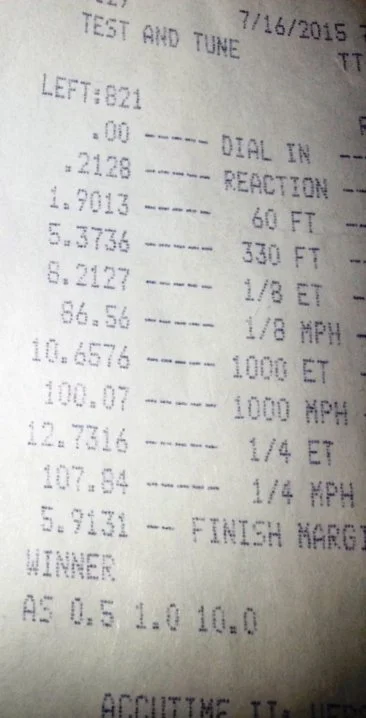

First run was a new best ET and Trap. The car was very cool and I hit the rev limiter just before I ran through the stripe. The 6AL has a "6000" pill in it. As you can see from the dyno, it seemed to cut power before 6000. I wasn't sure whether the dyno was right. I thought perhaps the the MSD Box might be more accurate. Nope! The car should run 112 with the current tires by 6000 RPM. As you can see, the dyno was right. The car is cutting out at about 5800-5850.
RXN: .2128
60': 1.9013
330: 5.3
1/8: [email protected]
1000: [email protected]
1/4: [email protected]

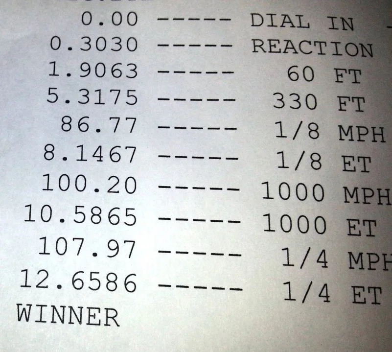

2nd Pass I got the car back down to the temperature I wanted. This would have been the fastest run of the night if the rev limiter didn't cut in so early. I think I shifted to 4th gear a little earlier than usual and I believe it picked up some speed because it felt like I was on the limiter for over 100 feet before I hit the stripe. I think it would've had another 1mph in trap speed, but I don't think it would've made much difference in ET since the cut was at the end of the track. The time slip looks funny because I had to go up to the tower to get it printed. Something weird happened with the time slip equipment.
RXN: .3030
60': 1.9063
330': 5.3175
1000': [email protected]

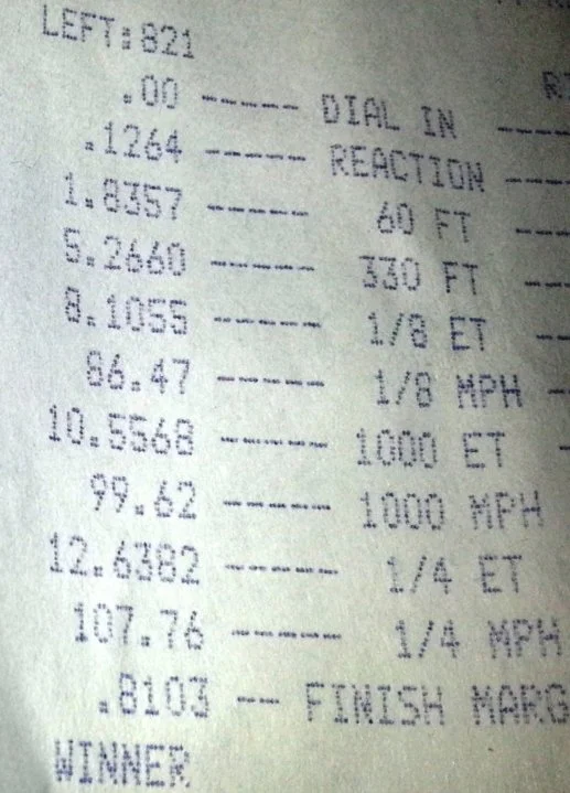

Finally, on the third pass, I got the best 60' time I've ever seen from a true street radial 225/55/16. However, I didn't have time to bring the car all the way back down to the ideal temperature before the run. The track was closing, so I had to get out there. I got the best ET of the night. I also pulled the rev limiter out of the 6AL box, but I think the extra heat in the engine kept me from exceeding the previous run's trap speed, and based on the 1/8 mile ratio to the 1/4 in the previous runs, if the engine were cooler I probably would have ET'd in the 12.56-12.59 range. Still, I'm blown away at how well this little combo works together.
RXN: .1264
60': 1.8357
330': 5.2660
I was really happy with the consistency of my 60's. All 3 runs were within .07s! What a great night at the track!
